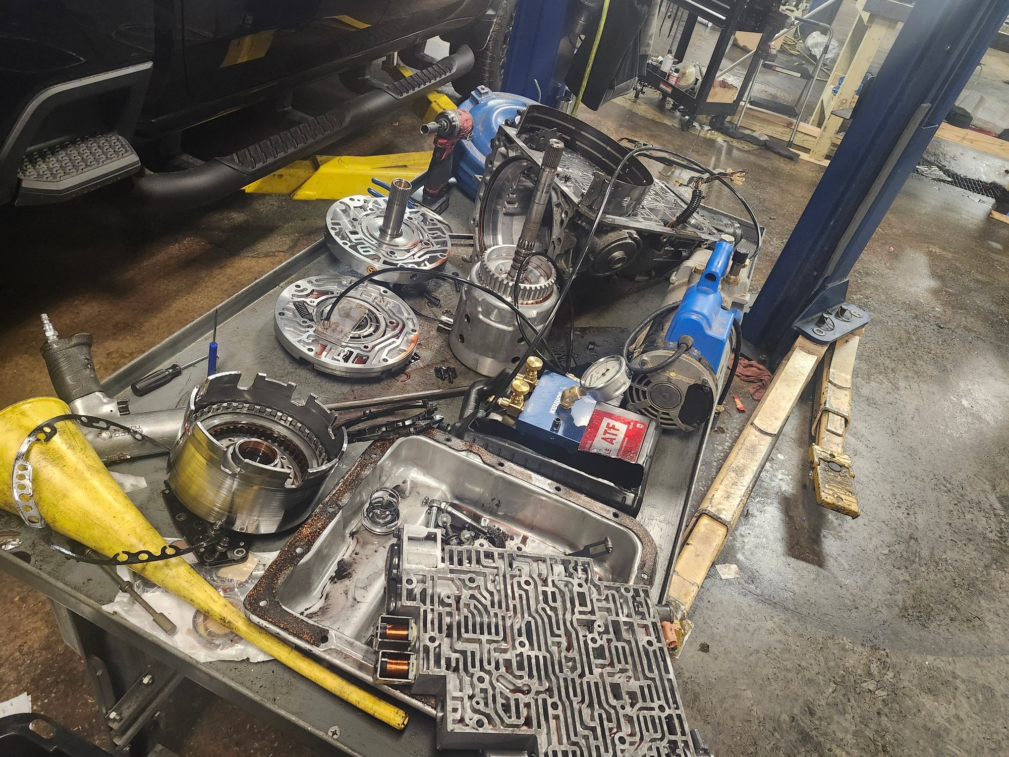

Well got my intake in. And installed, waiting on carb and dizzy to get here, figure I'd start a progress thread if anyone was interested. Also got my wifes 4l60 tore down and parts ordered to rebuild.

I am however glad to see that I'm not the only one who whenever they rebuild a transmission it looks like it threw up all over my bench.

Yep transmission always look like junkyard till back together

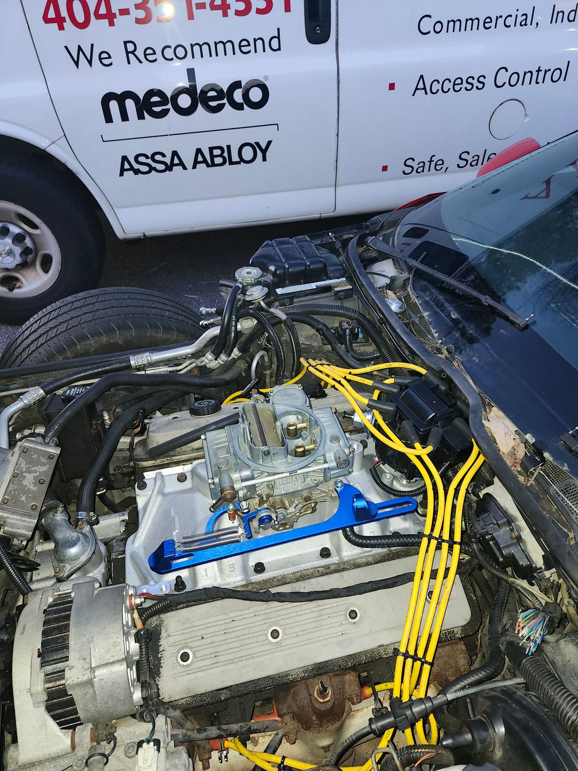

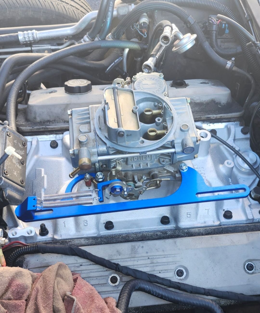

Been a little while since update, been busy at work not much time to work on my own, but have got my holley carb and got it apart waiting on trick kit to show up.
got my distributor in and its a tight fit lol. Wires and fuel pump are in the mail. Soon should be up and running.

Finished rebuilding my carb today, going take it to the shop Monday and install it, getting close

Got some more done, waiting on fuel pump and throttle cable. Gotta clean wires up more but getting closer

What year car is this?
Auto or manual?
Besides the pump, what else do you need to get running?
What are you doing with the Opti?
Is the carb/filter going to fit under the stock hood?
EDIT: Why is the throttle body still hanging in there? Come on, man...erase all evidence this thing was ever FI.
Old Feb 25, 2025 | 02:02 PM
Vetteman1939's Avatar
Vetteman1939
Joined: Jan 2025
Posts: 48
Likes: 11
From: Euharlee georgia
Auto or manual?
6 spd manual, just waitng on fuel pump to come in.. using a intank pump from a chevy vega,
waiting on throttle cable aswell.
carb and filter will fit under hood. opti wil be blocked off with a block off plate.
Throttle body is only there because of coolant lines that go through it. Im not ready to drain coolant just yet until i get fitting to connect those those 2 lines going through throttle body. It'll be gone when I get it ready to drive.
