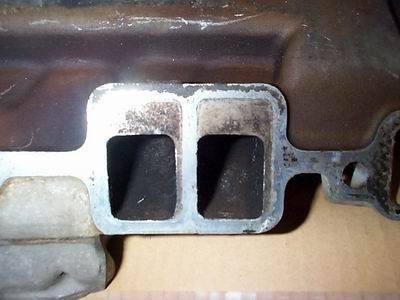

what I'm saying is the exhaust is also bad. headers are pinched at collector. 1.5" header tubing should flow 160cfm, but the tube is choked down to a small cross section that at best flows 114cfm. stock heads with stock cam flow 135cfm.
stock manifold flows 140-155cfm. stock head with stock cam flows 180cfm. mildly ported stock manifold can flow 190cfm.
this picture of intake opening at head shows how much smaller port opening is compared to head port opening. that thickness only goes for .75".
the intake port is that small size the entire length of the runner and wall thicknesses are about .25".
