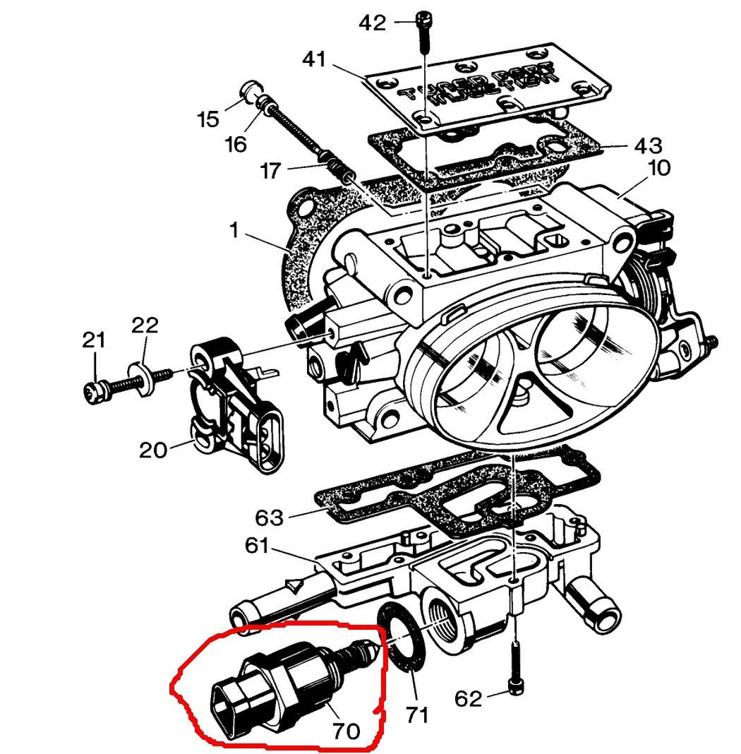

at idle the IAT solenoid is controlling airflow, you mentioned the sensor have you checked the solenoid?
sensors like MAF, coolant temp, IAT and O2s control fuel. If your scanner has live data you can check to see if they are in factory range
regardless of technology level, engines are still air, fuel and spark at right time and amount run fine
I haven’t checked the solenoid, where is that?
scanner isn’t here yet. I haven’t received any shipping notification either. Does anyone know if red devil river is still in business?
