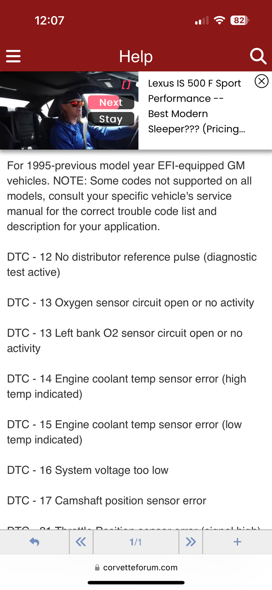

I googled 95 corvette code 17 and found this.
Thank you, but that's definitely not it.
