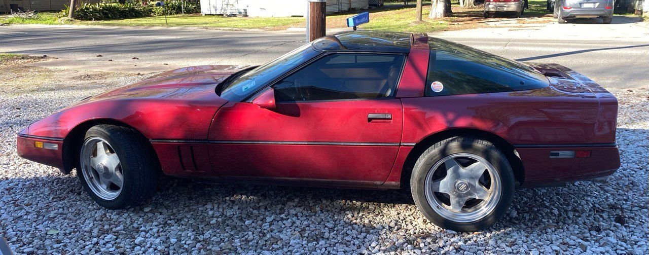

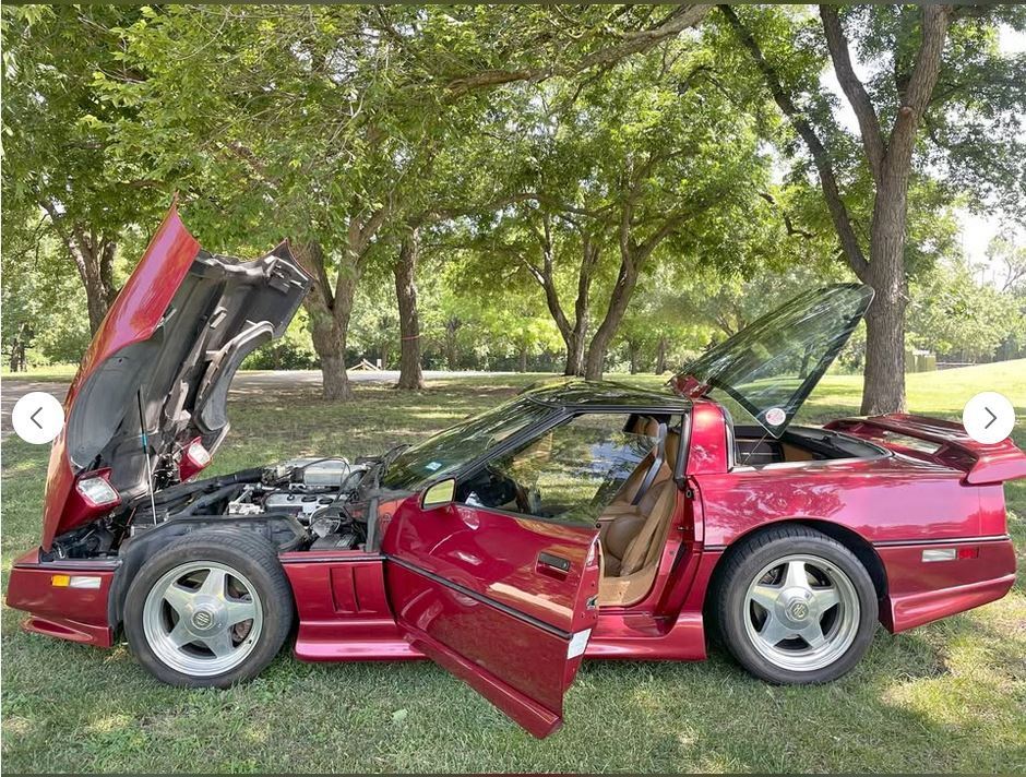

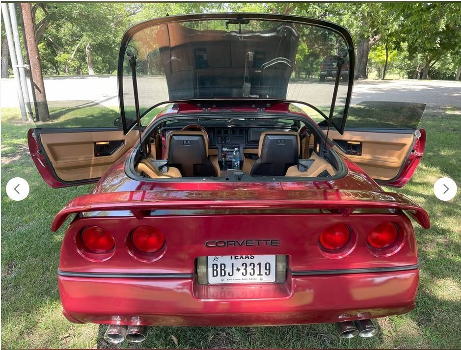

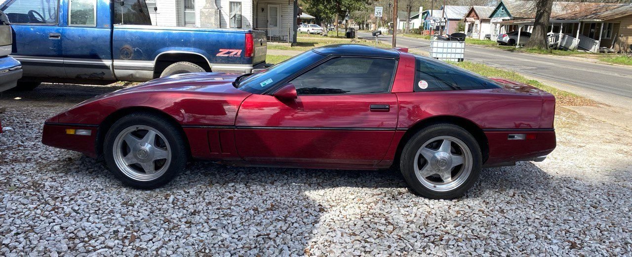

Before 1
Before 1
Before 2
Before 2
After 1
After 1
After 2
After 2

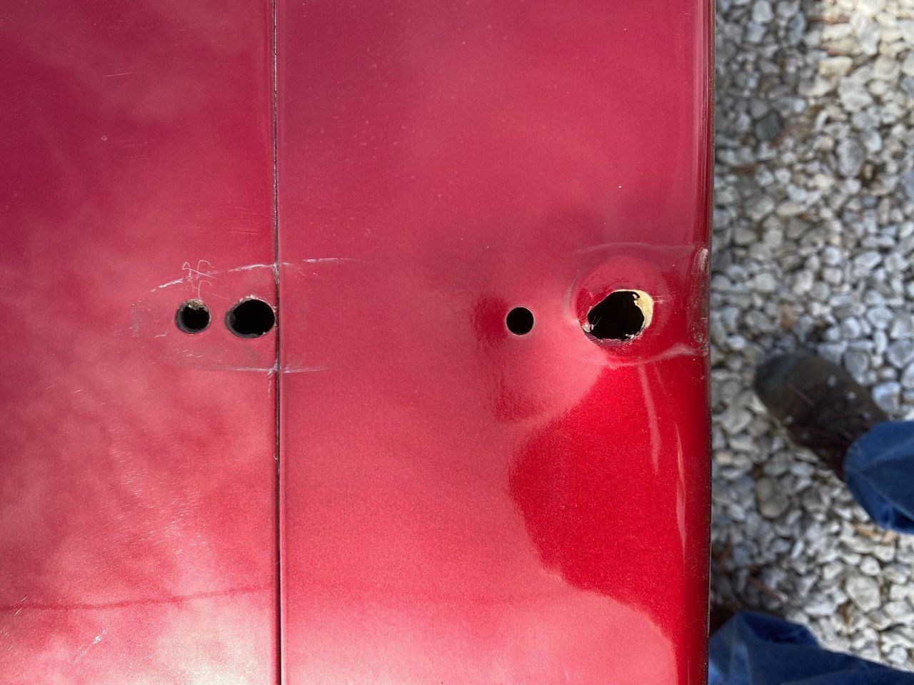

Wing holes 1
Wing holes 1
Wing holes 2
Wing holes 2

My kit was apparently the same. I have the side skirts that I might take out to the desert and burn in effigy.
Regarding the holes to fill, my plan is short strand glass fiber filler. Sand it down, prime and paint.
