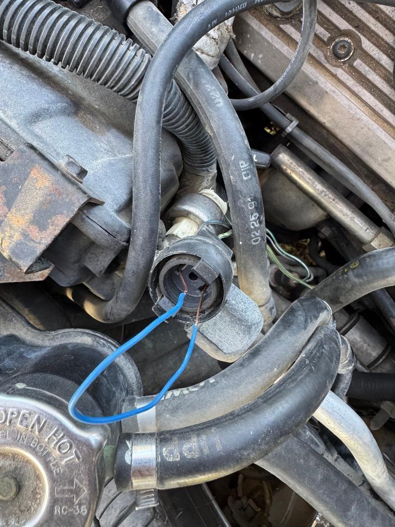

Ok, so I got the gauges in the mail. I was not able to thread on to what I assume to be the high side. It was the smaller line on the bottom. It might need some sort of adapter I do not have for those threads.
However I was able to thread on to the Filter Drier Accumulator. It had 130 PSI with the car running and off.
The compressor never seems to turn no matter what I try. I have tried unplugging it and replugging it in while the car is running. When I unplug it the car changes idle little bit. And when I plug it in it changes a little bit also. But the compressor never turns. I can turn it with my hand while the car is off and I do hear it moving stuff around when I do that.
Any Ideas on next troubleshooting step

Update, I checked power to the compressor. It was getting power. I then Bypassed whis switch (I don't know what switch this is) and the compressor turned! I also got cold air inside.
SO if this is the problem do I just need to replace the switch? Or does it mean something else. Also No I didnt let it run for more than a minute with me bypassing the switch.
You can test the switch by using a volt meter and putting it across the points on the switch in the continuity mode see if it's open (odds are it is, either low pressure or failure) Start the car and do your jump again on plug side to recreate the compressor to run, and see what the switch does. Also see what the pressures are in that brief run to confirm whether gas is below operation.
I believe that is the low pressure switch so I think they go open on low and and are closed under proper pressure

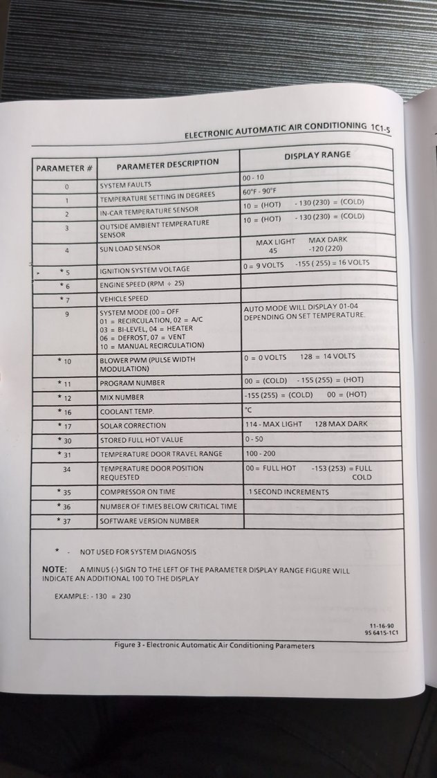

Hi have attached pics of my shop manual, if you have the electronic a/c as in the image a fault will cause the green indicator to flash. You will need to reset the fault like low freon, to enable the air-conditioning to operate. The images should help you, that low pressure switch is used to cycle the compressor and act as a safety to prevent damage in case of low freon. Am pretty sure there is a Schrader valve in the fitting its screwed onto, so it can be replaced easily without loosing freon. Just turn it half a turn to one turn anticlockwise and you will hear a short hiss then stop. Then you can remove and replace if its faulty. Should open below 22psi and close again when pressure back over 40 psi, so is used as a combination clutch control and low refrigerant safety. The electronics will determine failure by flashing the climate control green led indicator if it detects a fault. Refer to images how to check codes and reset 🙂👍

No codes
Old Mar 16, 2025 | 05:12 PM
mrlmd's Avatar
mrlmd
Joined: Jun 2013
Posts: 1,965
Likes: 343
From: Shell Point (Crawfordville) Florida
Sorry, again, but you have no clue what you are doing. You bought a set of gauges but you have "no codes" so you have no indication of low Freon in the system. If you indeed have low Freon and no codes, then you have a more major problem. Are you sure you know how to read codes? And if the Freon level is low there would be a green blinking light on as soon as you turn the system on, and then an 09 code when you interrogate it. You measure a highside pressure with the engine running and the engine off but the compressor will not turn on? That is totally meaningless. And FYI, if there was a code 09 indicating low Freon, the compressor will NOT run without bypassing it until the code is cleared and that is done by disconnecting the battery for 30 sec. or more and then turning it on to try again. You also cannot refill the system or add Freon unless the compressor is running, and that may mean bypassing the low pressure switch to engage the compressor and then once it's filled enough, removing the bypass and reconnecting the switch and filling it up all the way.
Before wasting more time and money, take it to an AC repair shop and have them look at it as it seems this is out of your expertise and you are getting a lot of useless advice.
Old Mar 16, 2025 | 05:39 PM
LixC4's Avatar
LixC4
Joined: Jan 2025
Posts: 63
Likes: 8
From: Texas
why do you keep saying I have no clue what I am doing?
I bought the gauges high side pressure was 130psi.
I got the compressor to run by bypassing the low Freon sensor.
yes if you read the above comment . He sent me pictures of how to check the AC for codes. I did check it by holding the up and down fan speed buttons. It says -00 then I hit auto and it still says 00.
So all I was commenting was no there is no 09 code or trouble codes on the AC.
I also found where it is leaking today. So I will repair it.
not sure why so much negativity in this thread about ACs. Just trying to learn more about them. But chanting TAKE IT TO THE SHOP every other comment is not helping.

If you have no blinking green light and no codes (00) then you have no low Freon pressure. Or, your computer system/sensor is FUBAR, and, like I said, you have a bigger problem. You are checking for leaks when your car says you don't have one. Noise or hissing may not indicate a leak by itself. Do you feel or see a rush of gas? If you really want to test for or find a leak you use a sniffer or a fluorescent dye. And how are you going to repair your leak?

No 09 code then maybe it’s the sensor ( he said that when he jumped it the compressor was activated)
You bypassed the Low Pressure Switch. If you bypassed the switch, and you’re getting cold air, then the switch is bad. Very easy to replace, there is a Shrader valve underneath the low pressure switch, so when you “unscrew” the old switch no refrigerant will excape. Just screw the new switch in, very easy. You might get a very small noise of pressure when you remove/replace it, but if you do it fast enough it won’t be a problem. (I’ve been ASE certified and have been working on automotive AC for over 30 years)
If you get cold air inside the car, then the system is working, you can leave the switch bypassed until you get a new one as long as you have cold air. The chances of you getting a leak between now and when you get a new switch is pretty rare.

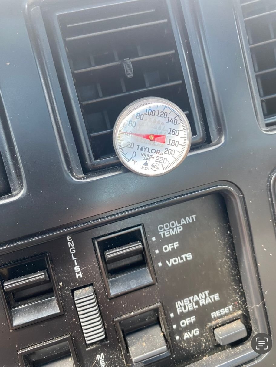

Get a thermometer and stick it in the center vent, put the system on Max with the fan on high. If you show anything under 50 degrees then you’re good.

At least he knows the system still has Freon , that’s should help but he must get the sensor (switch) changed
