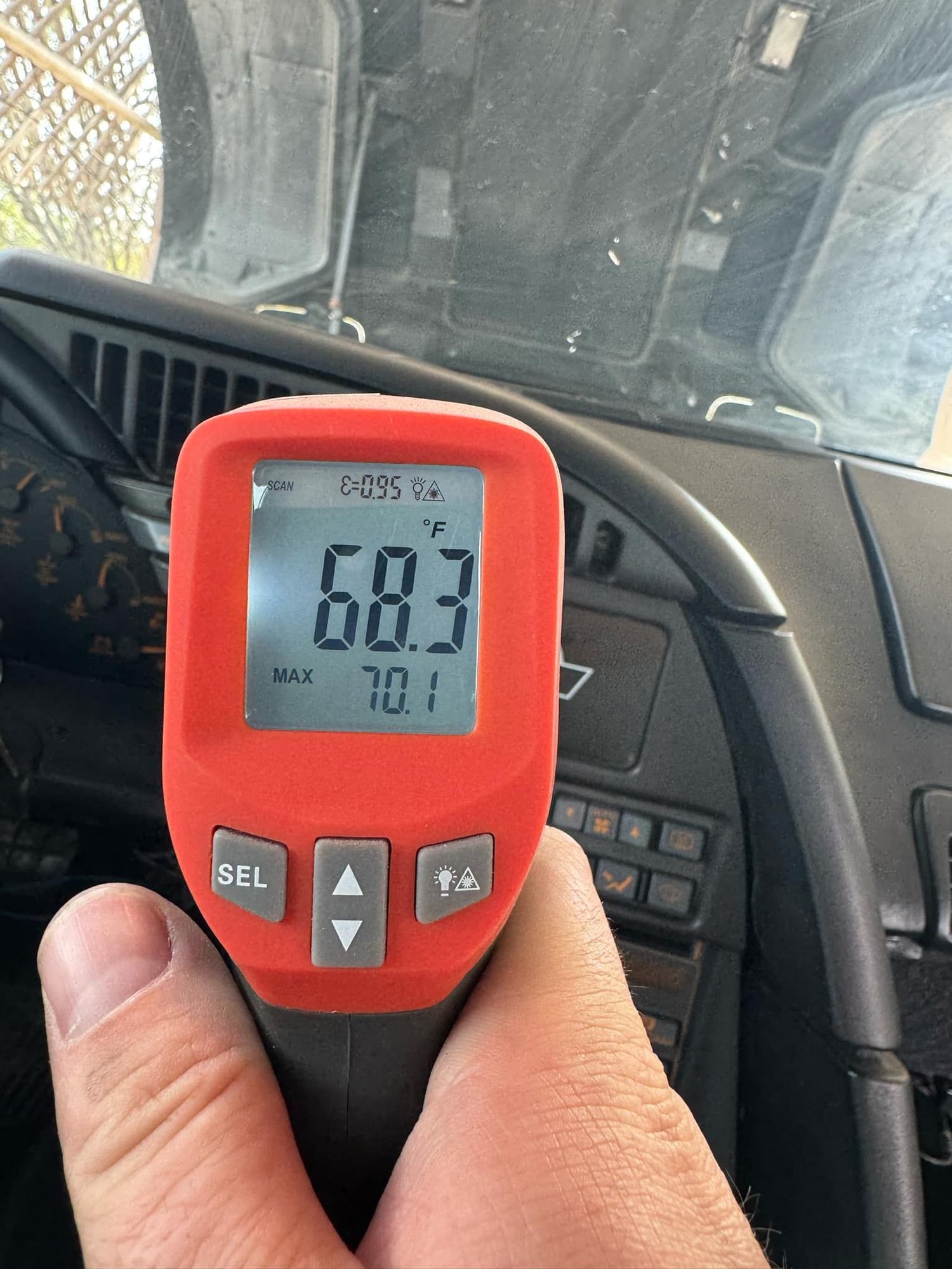

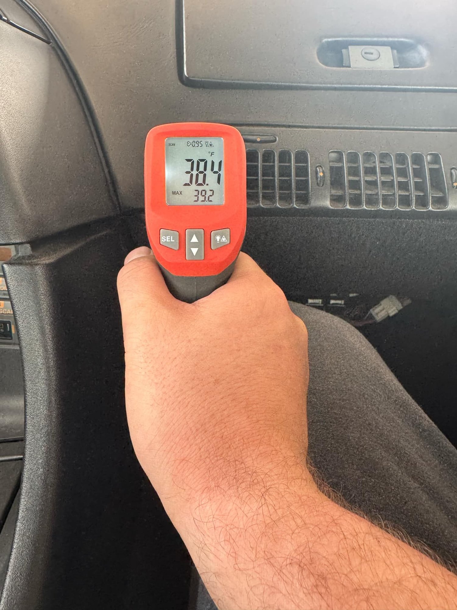

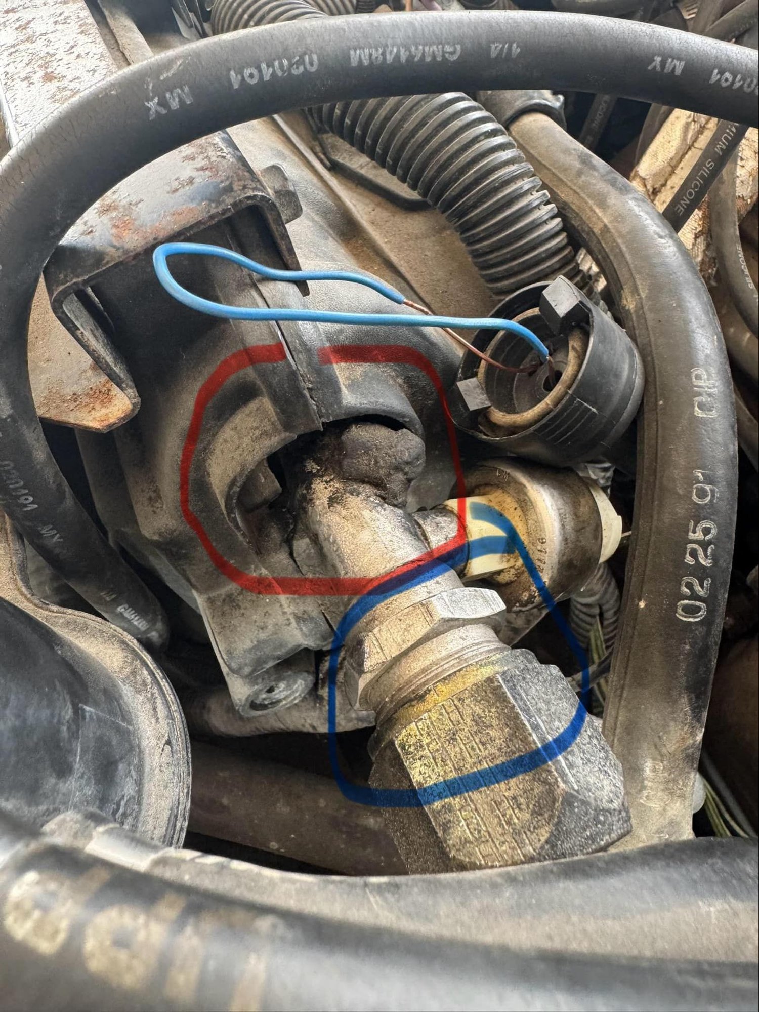

Alright so the temp gun shows before and after air temps from the vents AC off / on. IT GOT NICE AND COLD! I let it run for about 30 minutes.
Third picture in red circle is where I found the air is coming from. Its rushing out of that area. The blue circle was were I thought it was leaking from but its not. Its coming from that red circle area.
