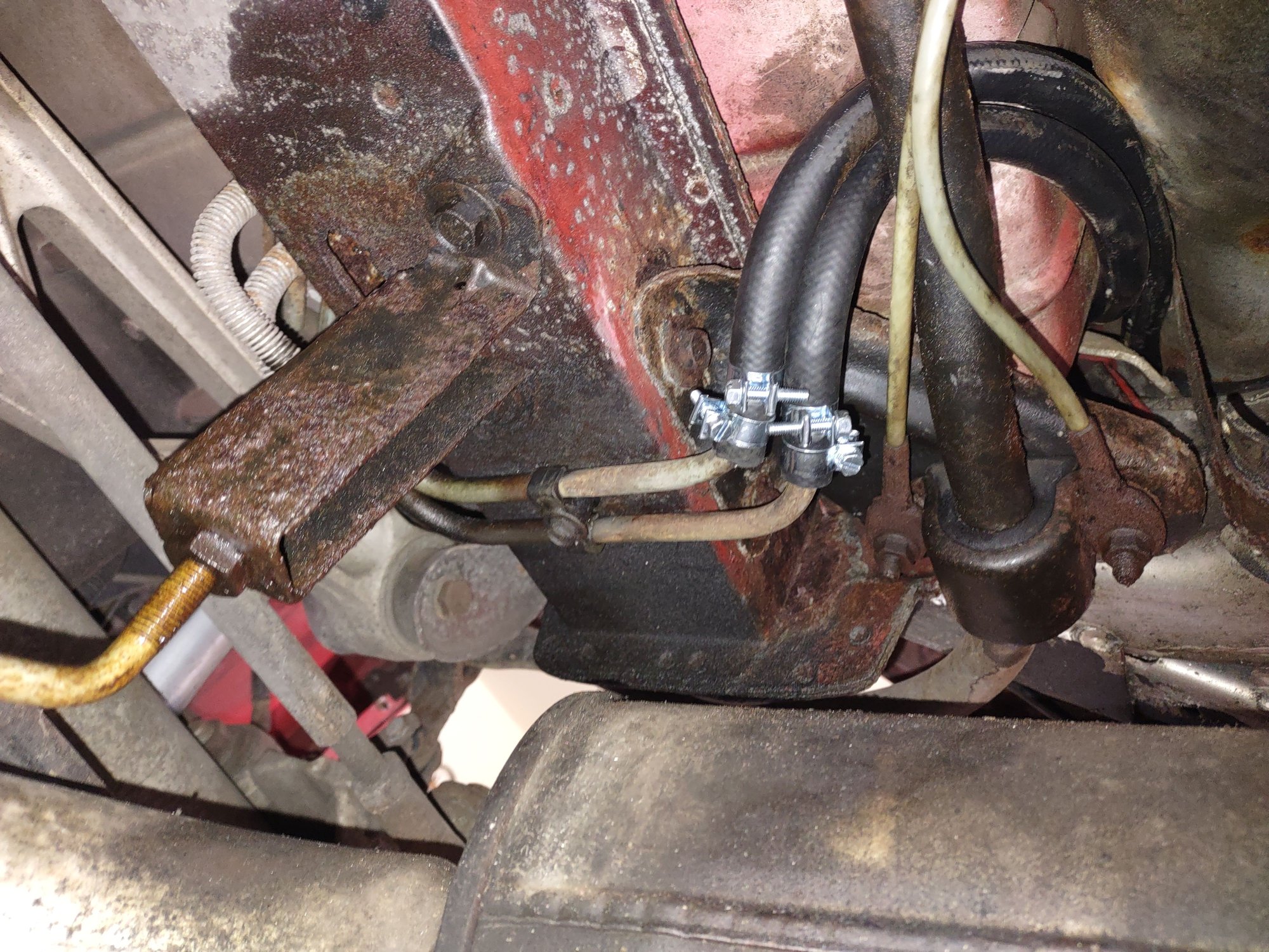

Well, after a period of smelling some gas, it escalated and now there's a puddle of gas by the passenger rear tire. I removed the little splash shield to see the charcoal canister area and the fuel lines up there are extremely corroded, 99% sure they are the source of the leak, and either way definitely need to be replaced.
I see pre-bent lines are available. I think getting access to put them in ...would be extremely difficult. Has anyone ran flexible lines as a replacement? I am unfamiliar with lines and fittings, I would need some guidance on what to use and how to attach them, but I think this seems doable if I buy the correct stuff?
Opinions?

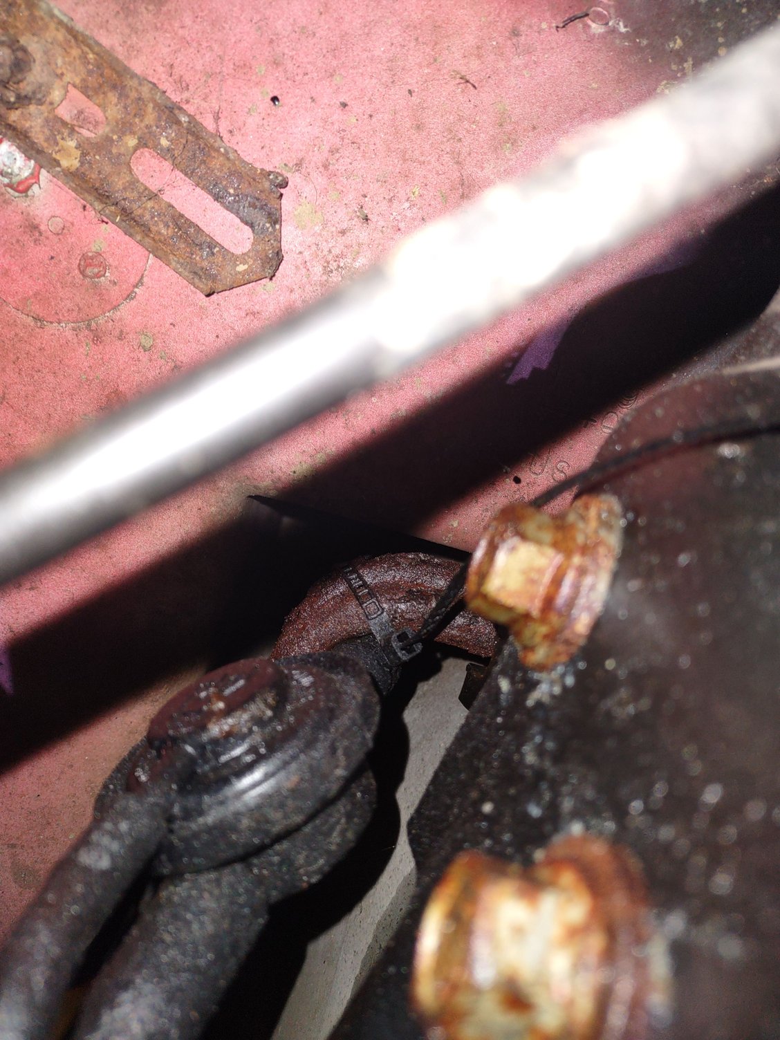

I marked the lines...but can someone confirm which line from the tank (top or bottom) is the send? Then I can make sure that line ends up going to the fuel filter.

It's a little difficult to see in the pic which is which, but the two lines are different diameters. The supply / pressure is 3/8", and the return is 5/16".
In the second pic, where the lines have been cut, the "top" one appears to be the smaller diameter, so it is the return. The larger 3/8 is the supply, and goes to the filter.
