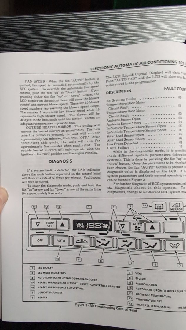

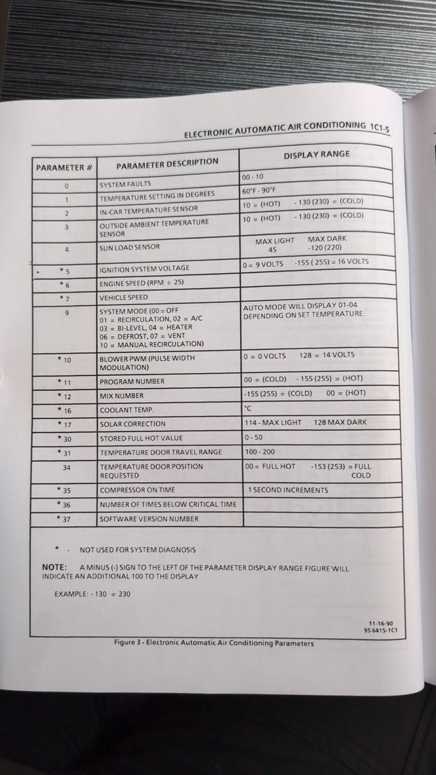

Hi the flashing green led indicates an error, check the images below how to check the error code causing the air-conditioning compressor to be inhibited.
