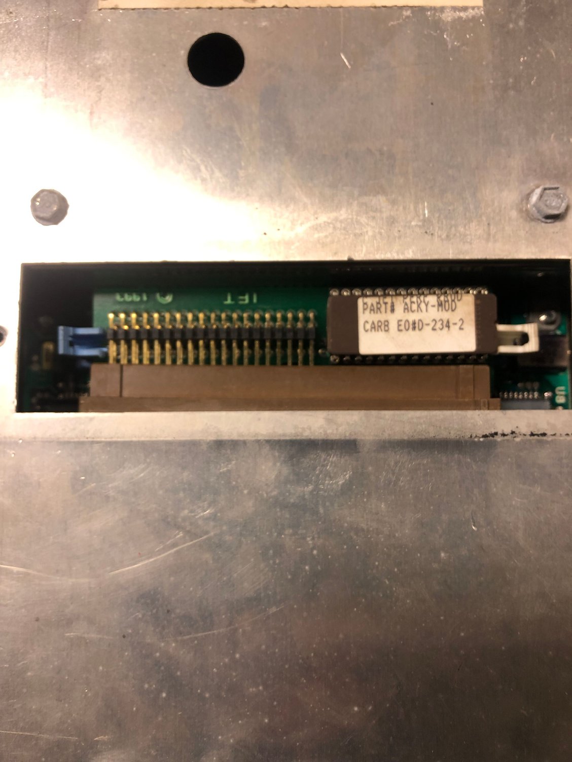

So I changed the heater core this weekend and while I had the computer out I thought I’d check and see if there was a chip in it… and yes there is… the car is stock… manifolds ,exhaust, pollution pump etc… but has a chip in it… I don’t know much at all about high performance chips .. but now I’m wondering if that could be the issue… thanks for reading.

Typically , the stock chip is plugged into that aftermarket chip. If that's the case, disconnect the aftermarket chip from the stock chip and plug the stock chip straight into the ECM and see how she runs.

Looks like a Jet Chip based on the EO number and circuit board. It most likely adds a little spark advance, reduces the fan on/off temperatures and may raise the tcc lockup speed a bit. ACKY is a 1988 auto trans bin for 2.73 or 3.07 gear.
Suggest you scan it again. The BLM lower limit should be 108, so your numbers don't really jive with what is normal or expected.

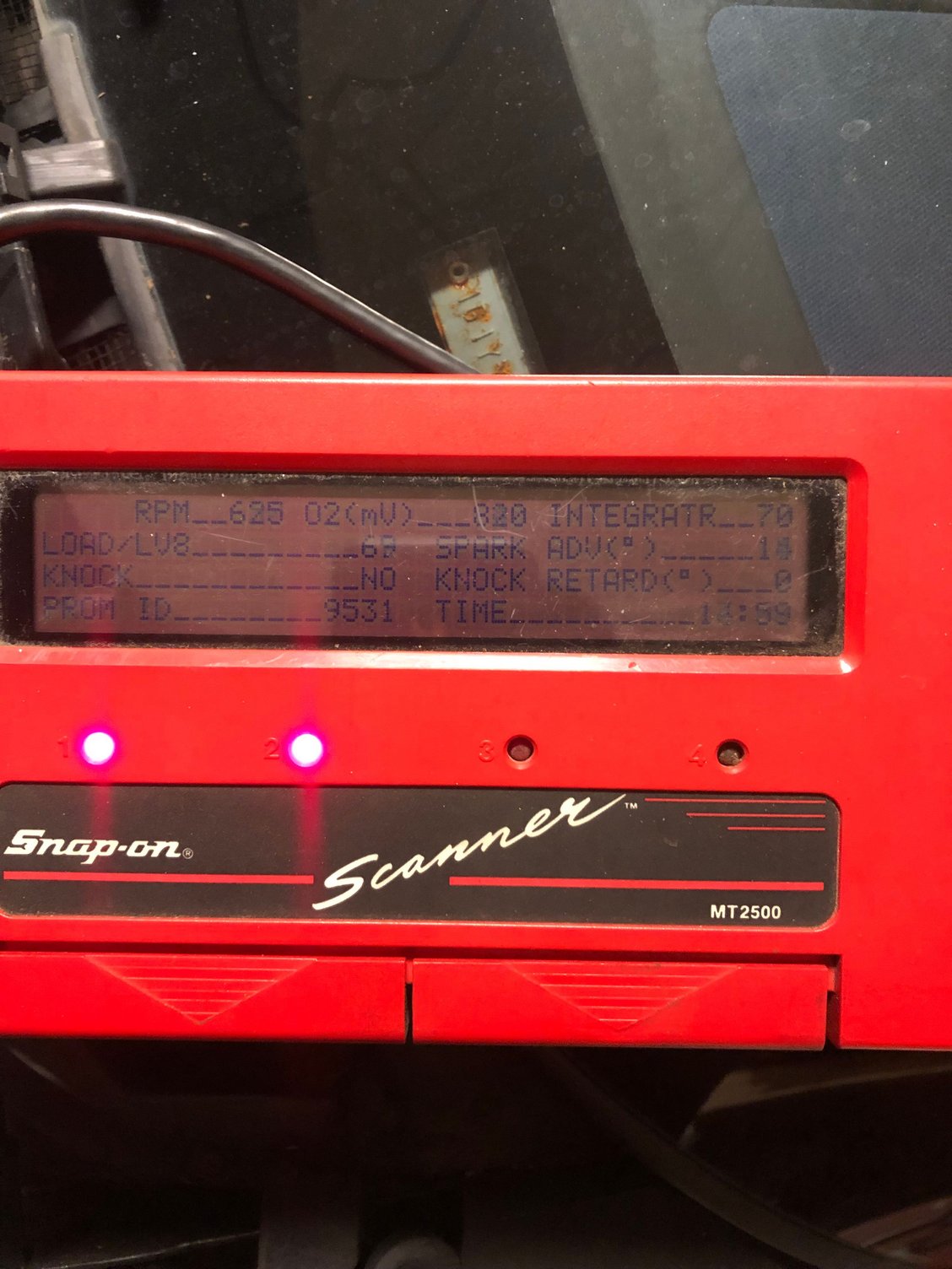

Hi everyone, so I have update,
I managed to get at it today, I scanned with and with out the performance chip installed and there was no difference between the two…
block learn is 108 and intergrater goes as low as 70…so yes tequilaboy is right about that….so is that normal? It runs so rich that it will burn the eyes out… . Other than that it runs great… and it will roll over longer after it sits for a hour…but always starts….I’ll play with it some more like leak down test etc… i did all that last year and ended just driving it… gonna end up doing the same thing this year too lol… however any suggestion is appreciated thanks !!

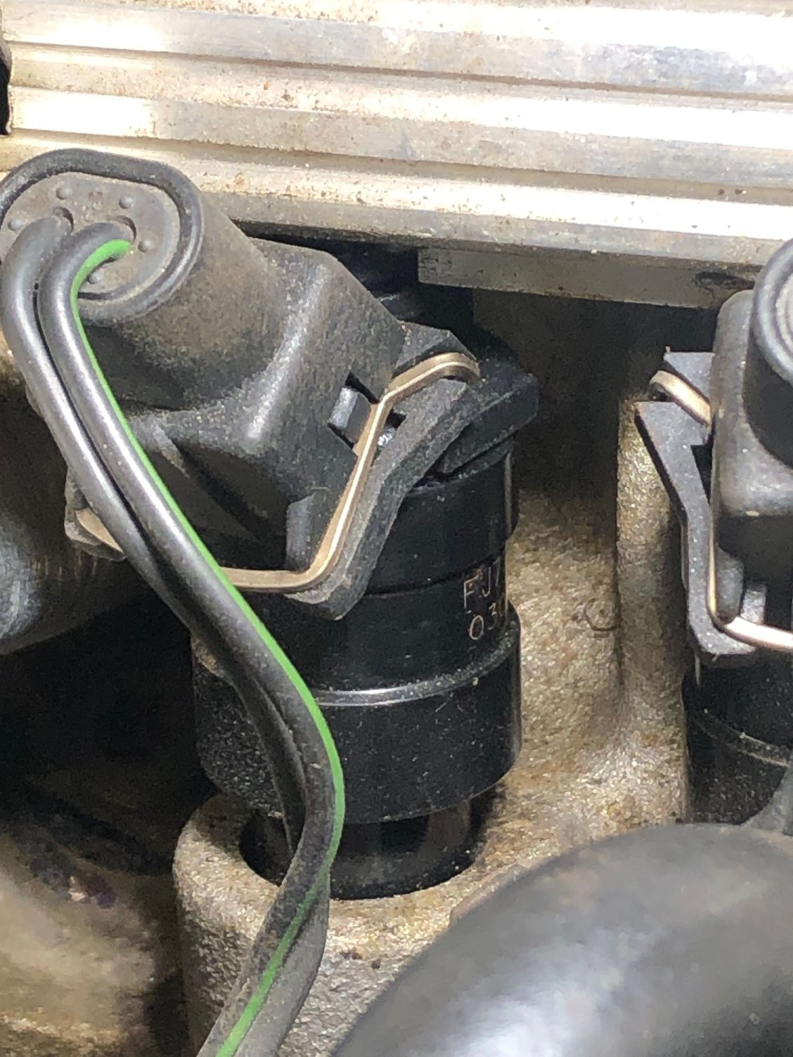

Look at the coolant sensor, MAT sensor, MAP sensor, etc... are they all displaying reasonable values? For a stock 88 Vette, I'd expect the MAP Sensor to be reading about 30-40 kPa at idle in neutral. Key on, engine off... how does the TPS look? Does it increase linearly with application throttle?
What injectors are on the car? Can you see a p/n embossed on the sides? Post a picture of them perhaps? Maybe previous owner put in bigger injectors and didn't update the chip to account for them?

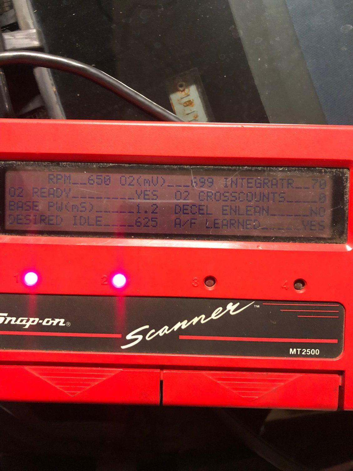

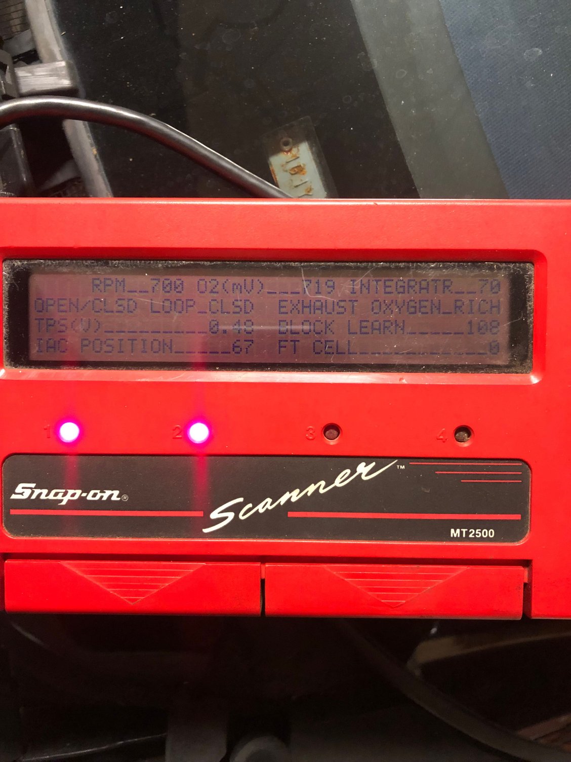

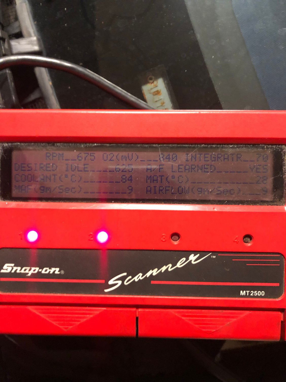

So I went out to the shop and played with it a bit…took some pics … second pic is the part number on the injector… I remember last year looking that up.. they are apparently just stock injectors from standard …… rest is pics of some readings… it almost feels like the injectors are too big …. But apparently not….

Your TPS is a little low at .48V. Should be .54V. I doubt that's your issue, but might a well get it corrected.
Base pulse width is only 1.2ms, so it's not like the ECM is commanding the injectors open an excessively long period of time.
BTW, what is your fuel pressure when the car is running? I didn't see a number in any of the previous posts.

The load and mass airflow signals are a bit high for a 625 rpm idle (in park/neutral). I'd say that the MAF calibration is suspect. Delphi sensor?

I'm also noticing your O2 cross counts are zero. Typically the O2 voltage is bouncing around and everytime it crosses 450 mV, ECM registers a cross count.
The only thing is, this could be a symptom of the problem since if you're pegged rich, you might expect the O2 voltage to remain on the rich side of 450mV.
