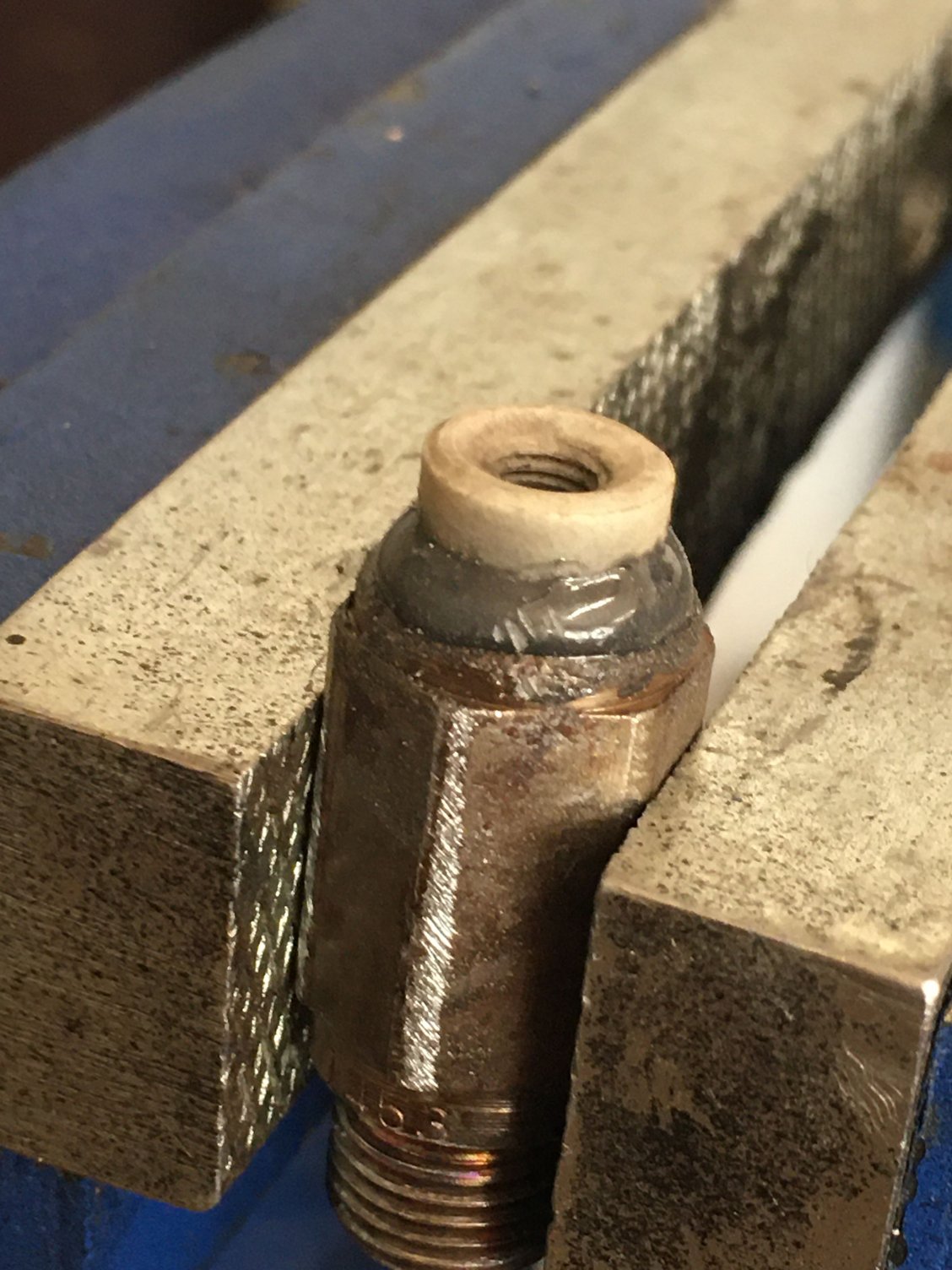

To adjust the Temp Switch: Connect your VOM on Ohms between the wire and the case. Turn the 'screw' inwards until the VOM shows continuity, then retract the screw 1/8 turn. Secure the screw.
If the switch is detected closed upon start-up, you get an instant SES and Code 32. You can't adjust it by "feel". Use your VOM.

HALLELUJAH!!! NO CHECK ENGINE LIGHT!!! I just drove the car about 70 miles and where I'd usually see the SES light come on, it didn't. As mentioned in my previous post #8 I worked on the EGR temp switch. Basically, the EGR temp switch consists of 3 major parts. The body, which has the threaded portion that screws into the crossover pipe, a ceramic insert, and the temp switch, let's call it a pintle, that screws into the threaded portion of the ceramic insert. I noticed during inspecting the switch that the pintle threads are loose in the ceramic insert, and the ceramic insert is loose in the body. While bench testing I observed that when I bottom the pintle into the ceramic insert so the end of the pintle touches the body then I get continuity from the electrical wire to the body, which is supposed to occur when the switch gets hot. I backed out the pintle about 1/2 turn so the circuit is open. However, when I rock the pintle in a sideway motion I notice that the pintle is loose in the ceramic insert and the ceramic insert is loose in the body. When I rock the pintle it grounds out intermittently. As mentioned in my previous post I epoxied the ceramic insert to the body, then added teflon tape on only the threaded portion of the pintle. Upon re-assembly, the pintle was tight in the ceramic body and the ceramic body was securely attached to the body with epoxy. I did order a new one so in case this didn't work I could replace it. But it seems to work fine. So to summarize...
I replaced my bad leaking EGR valve with a new one.
As per the FSM for Code 32..."Before using this chart, check vacuum hoses for leaks, restrictions and check for ported vacuum source to EGR solenoid should have at least 7" vacuum at 2000rpm.
The ported vacuum port is below the throttle body. I had a problem with the id plate gasket and had no ported vac. I fixed it by orienting the gasket correctly and re-assembled.
I replaced all the vacuum plastic tubing, where necessary, with 5/32" vacuum rubber hose. I even removed the rubber connector on the EGR vacuum solenoid to eliminate any leaks. I was able to just push the vacuum hose on the nipples.
If you look at the Emission Hose Routing diagram on the radiator shroud you will see that the same ported vacuum line that goes to the EGR solenoid and actuates the EGR valve also feeds the tank pressure control valve and the control valve on top of the carbon canister. Any failure or leaks in these valves or vacuum hoses going to these parts will reduce or prevent ported vac from operating the EGR system and the carbon canister system.
Per the FSM, the ported vacuum side of the EGR vacuum switch should hold vacuum when the car is put into diagnostic mode, shorting ALDL ports A&B, key on, engine off.
I discovered my new EGR solenoid was bad and put the old EGR solenoid back on since it tested good.
I tested my wiring to the EGR solenoid by putting the car in diagnostic mode and probing the unplugged connector with my voltmeter resulting in 12 VDC at the connector which is good.
I also tested the EGR temp switch wire by probing the terminal to ground with my voltmeter, key on, engine off and not in diagnostic mode. The voltmeter read 12VDC.
The only remaining part that was in question was the EGR temp switch which I tested and fixed. Attached are a few pics and comments.
I epoxied the ceramic insert to the body with 2 part epoxy.
I wrapped just the threaded portion of the EGR temp switch pintle with teflon tape to keep it in the adjusted position which was about 1/2 turn from bottoming out.

Thanks, I did exactly as you posted. Although I did unscrew it about 1/2 turn. It seems to work.
