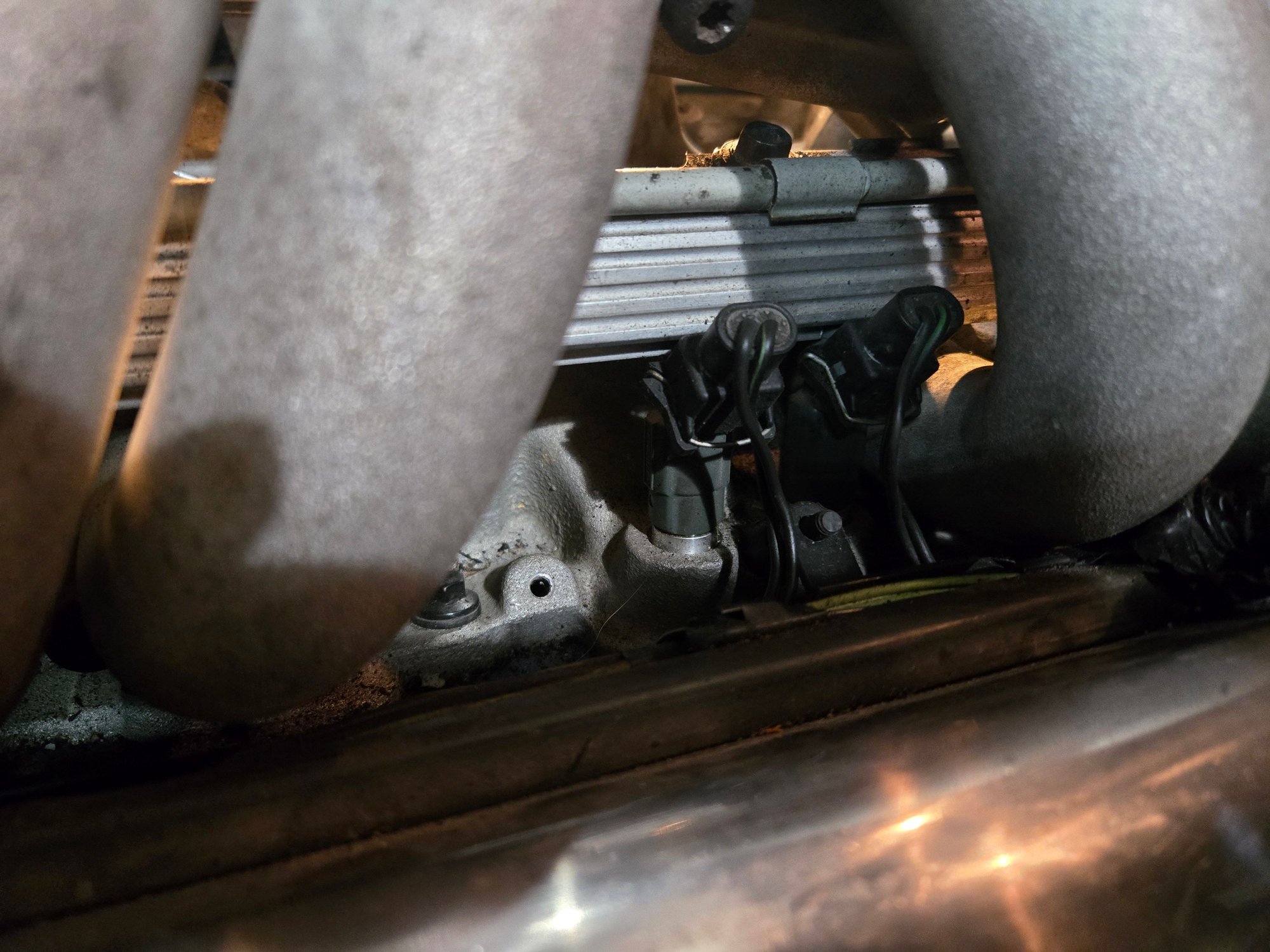

the pre-bent hose i was told was a match. Ended up =finding a hose, fresh fluid, and i couldn't take up a bay any longer (this is 2 full days). I believe the $400 aluminum radiator 20 months old is..... dripping!! and after logging onto there site, in order for warrantee replacement, you must show a receipt with, Accepted type of antifreeze.. Sooooo...without that receipt I'm a sitting duck. Gotta find a good rad and not an eBay 4 core, USA seller ,unit...lol here is a picture of the injectors.. terrible picture.. K.I.M they are a year old now...

We took the power steering pump off it's mount, and removed both rubber hoses. no leaks, i cleaned them really good, and replaced all of the 1989 GM hose clamps. Took bracket off reservoir, 100 thoroughly cleaned bracket, res. that whole area is now a lot more presentable. And being the newb I am, my picture of 2 fuel injectors, doesn't show part #.... tomorrow.
