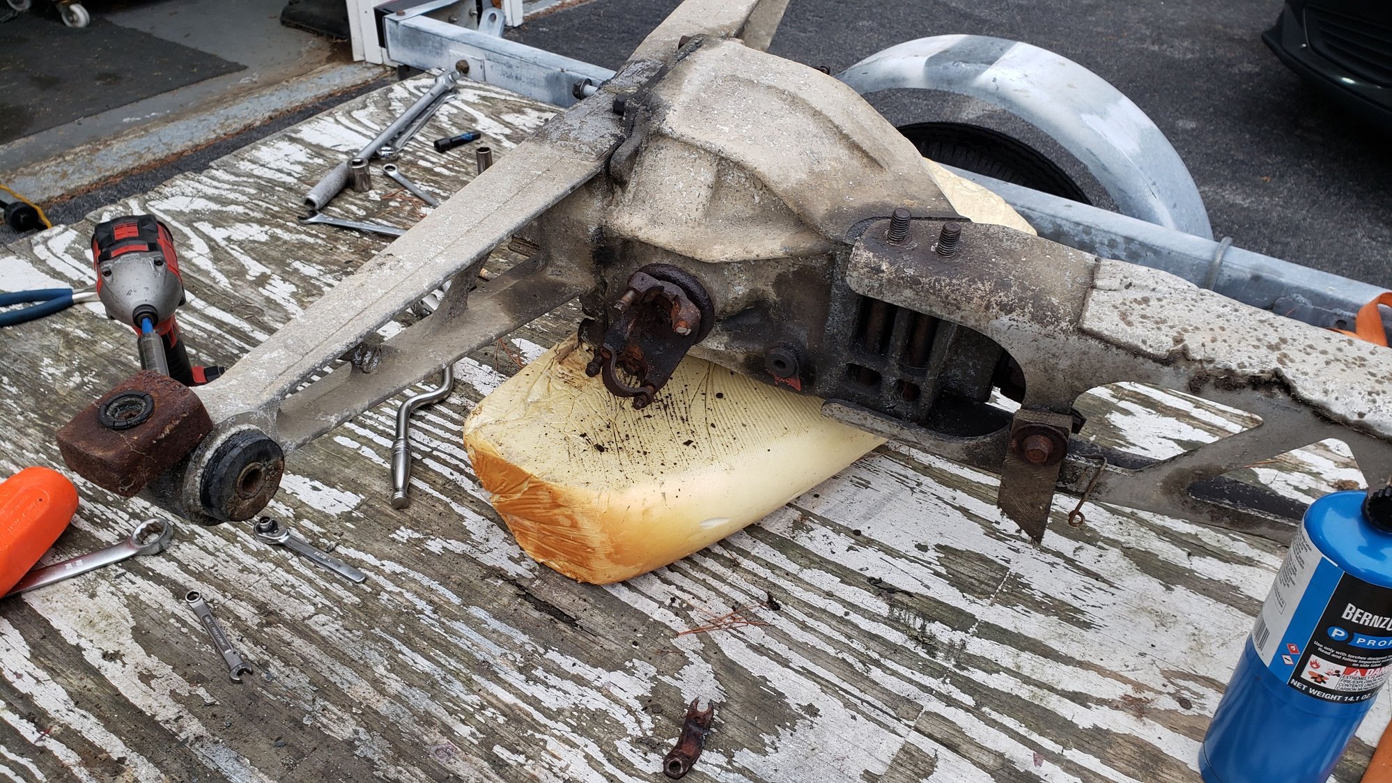

So got a Dana 44 from an 86 i bought to part out. In the process of disassembling (the rear end, not the diff itself). Hope to have batwing off next few days. Car had like 56k on it. Input shaft turns great by hand and i dont feel anything bad. So far 1 bolt stripped for a half shaft u joint strap that i had to grind off. Hope to be able to get bolt out. But i do see those for like 75 bucks if i cant.
But question is, what should be done to this for an upgrade? Willl do drain plug like i did on my 36. Also will run SS studs for the batwing to diff .Im not looking to put 1000hp through it, nor run slicks. But i try to do things the right way, so looking for advice. Keeping the 3.07 gearing.

Thanks everyone. Im still fighting the rear 2 bolts for the c beam. They are really seized in there. And on the bottom of the case i can see a small chunk of aluminum seperated. Dosent seem too bad (i hope). The guy that welds our gearcases and props can fix it im sure. But what a pita!

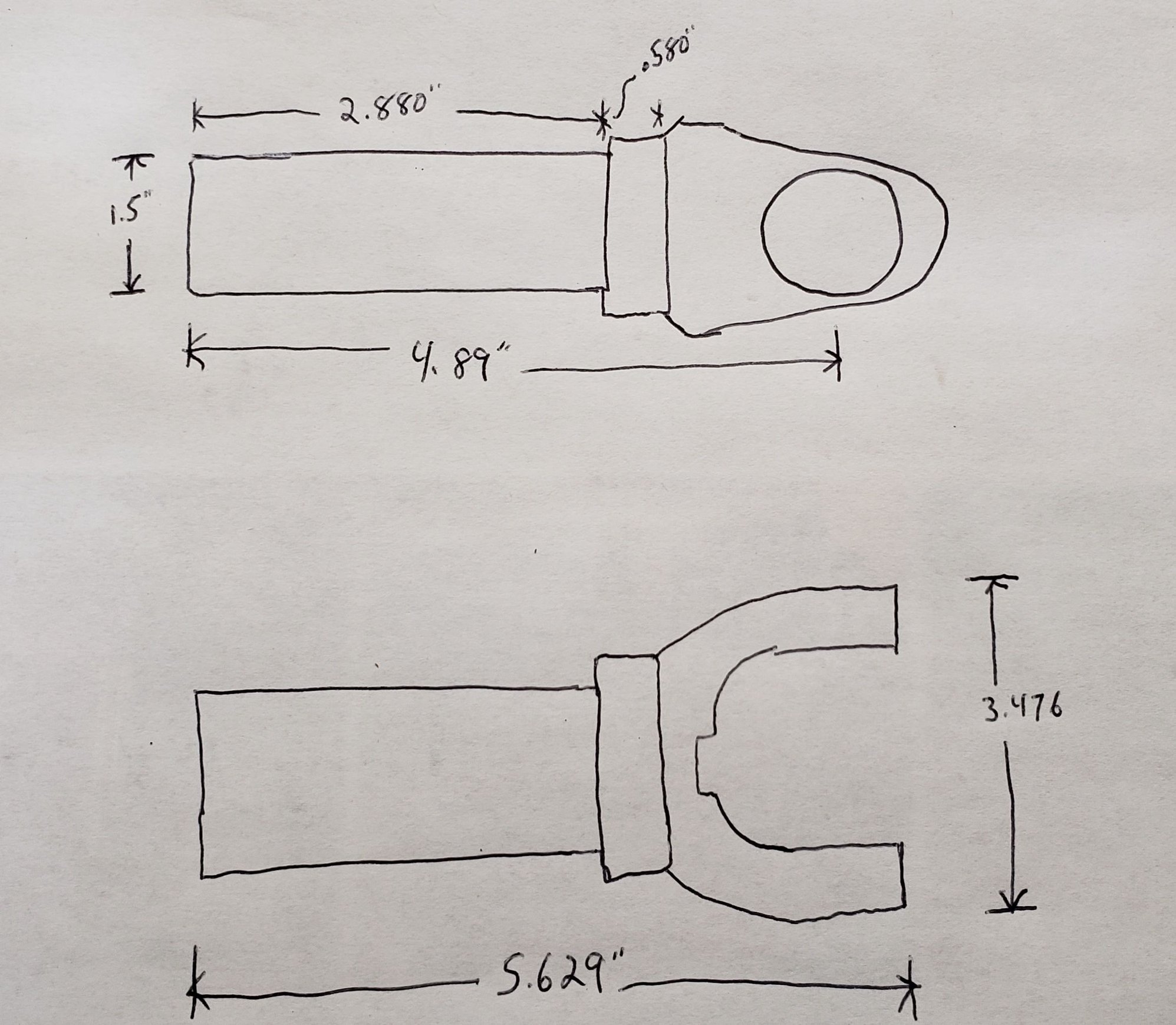

So this is the slip yoke from the 86. Pretty bad. Thought my machinist could fix or sleeve it, but he said no. Im told they dont mke these anymore? And i also understand this is exactly what i need to mate up to the 700? Thanks

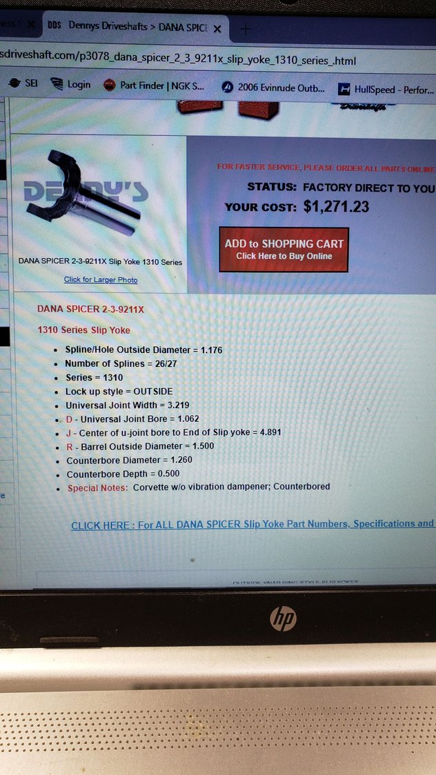

Spicer 2-3-9211X I believe is identical to what you've pictured? 4.891" tip to center of u-joint and a counter-bore?

This is what i came up with.

Looked it up. Only difference is the u joint bore. Im getting 1.59.
And HS! 1300$! Cant do that...

And i will once i get it apart. The 2 bolts that hold the c beam are seized in case. I have them soaking for a few days to try to get them out this weekend hopefully.

Use a blunt tip and air on the c-beam bolts and apply more of what ever you're soaking with now to them.
