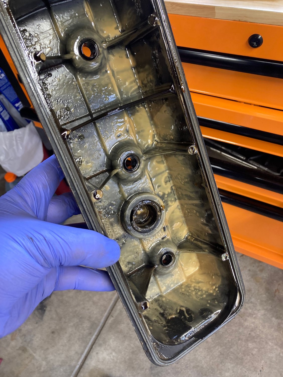

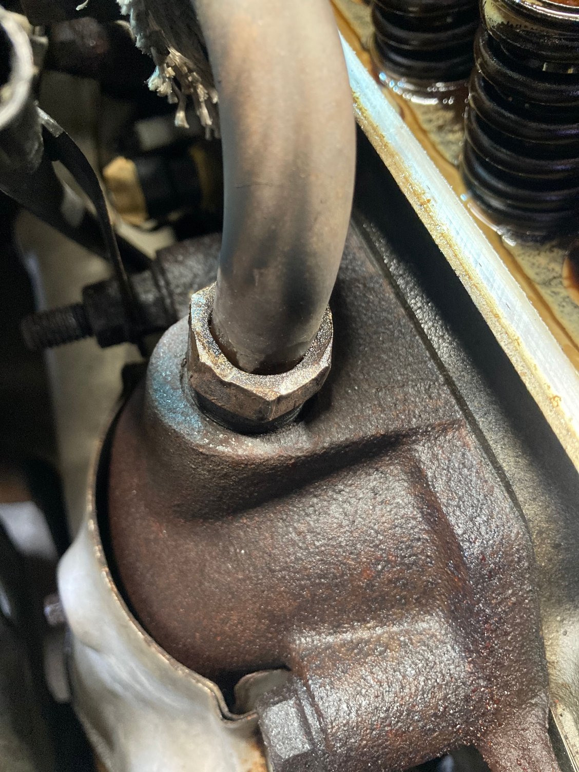

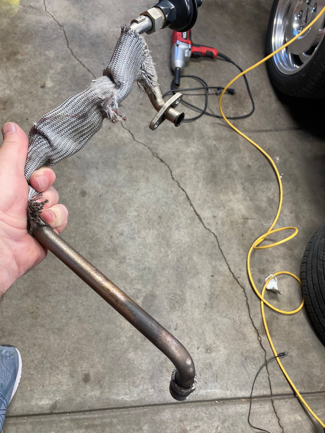

I got confirmation that it’s a head gasket by the looks of this milkshake ****. But now a problem, can’t get this air pump line nut to come loose. Could feel the open end wrench start deform it so stopped and got a flair nut wrench. It’s still wanting to deform before budging. I soaked it with PB blaster for a day but no luck. Not sure how to proceed?
Milkshake
Milkshake
Stubborn nut
Stubborn nut

Yessir! That's a smoking gun.
I would get a torch and heat the ever loving crap out of that nut. Then hit it with WD or your lubricant of choice. Do not breathe the fumes (duh). Wash, rinse repeat. Also try tightening the nut first a teeny bit, then work it back and forth like you are chasing a thread with a tap. You'll get it.

Take acetone and mix it 50/50 with automatic trans fluid. Put it in an oil squirt can and shoot it on seized parts and give it time to soak. It works better than anything else Ive used. You will probably need it on the exhaust manifold flange nuts underneath too. When you get to those, use 6 point sockets only.
Order exhaust manifold flange stud kit while you’re at it

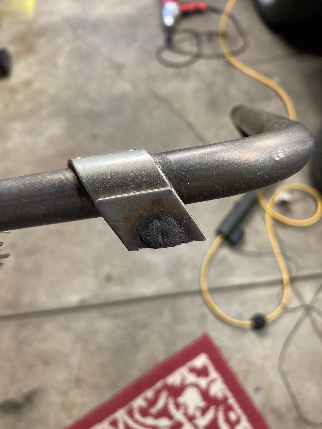

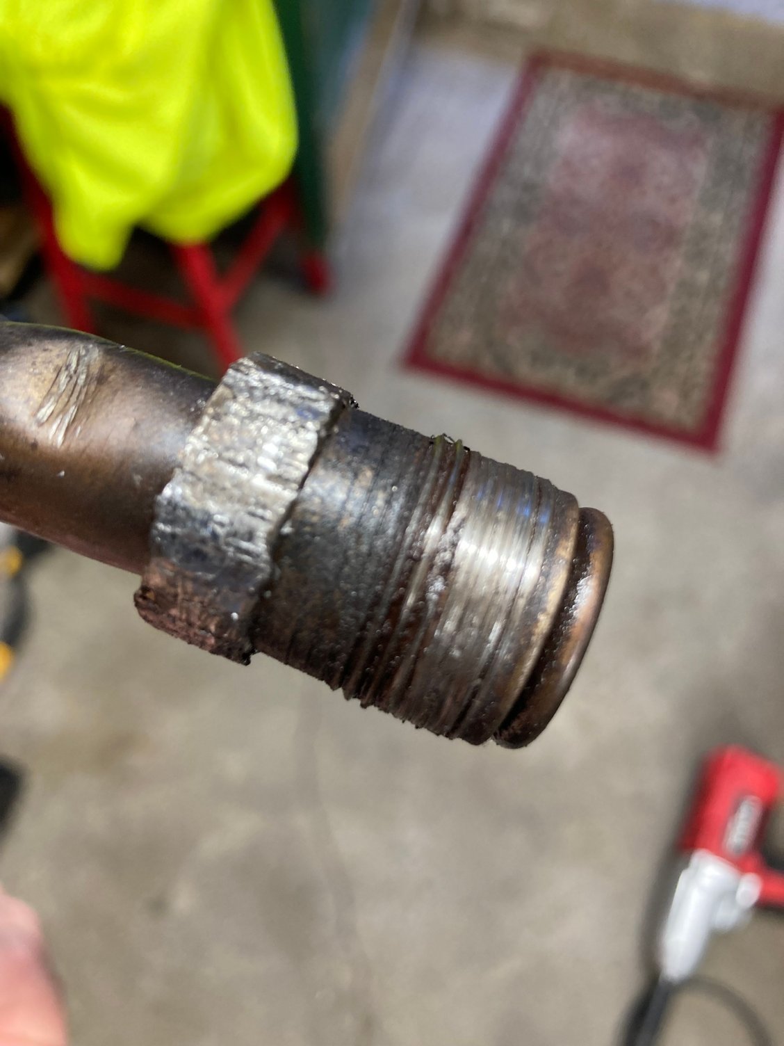

I finally got it out, but I don’t think it’s reusable. Does this pos need to be reinstalled? Tearing it off and putting a plug in that hole sure would be nice
Nut is trashed, threads look stripped
And the there was a hidden bracket attached to the back of the head! I had enough, it got the sawzall.

It's the air injection. If you don't have smog check in your area then just plug it.

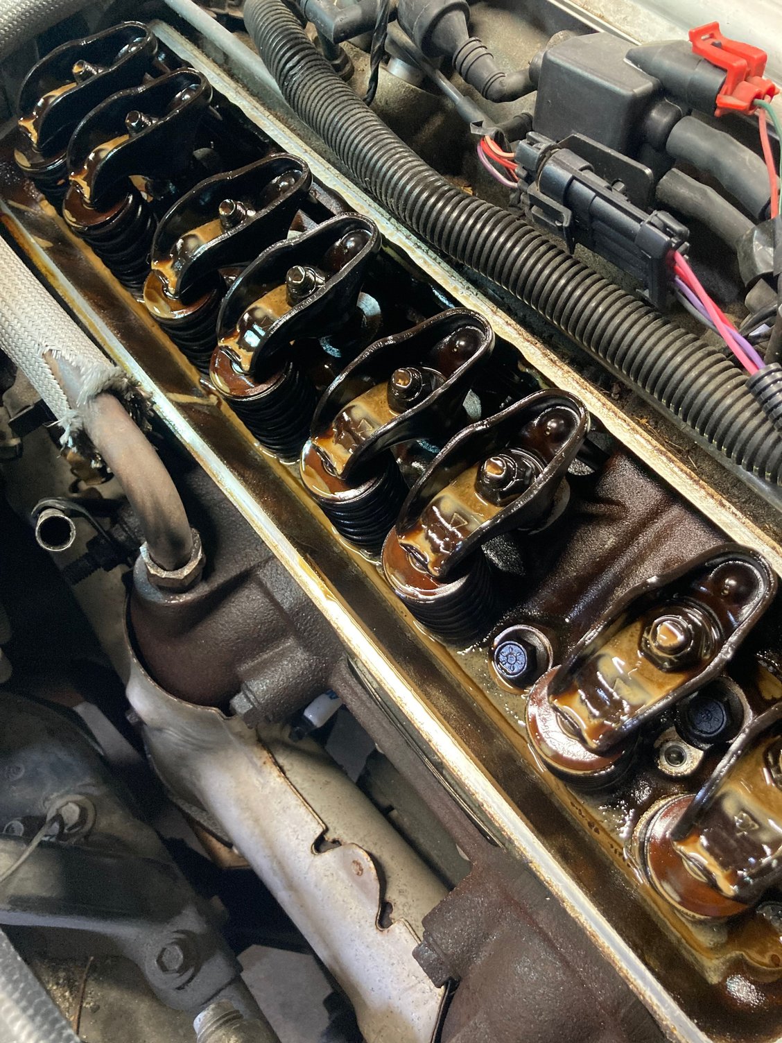

Default Update
Small victory this morning! Block sensors, dipstick and exhaust manifolds removed without a hitch. Now just intake then the heads, ez pz right? On previous issue full emissions required where I live so ordered new air injection pipe from ZIP.
No problem
No problem
EZ
EZ

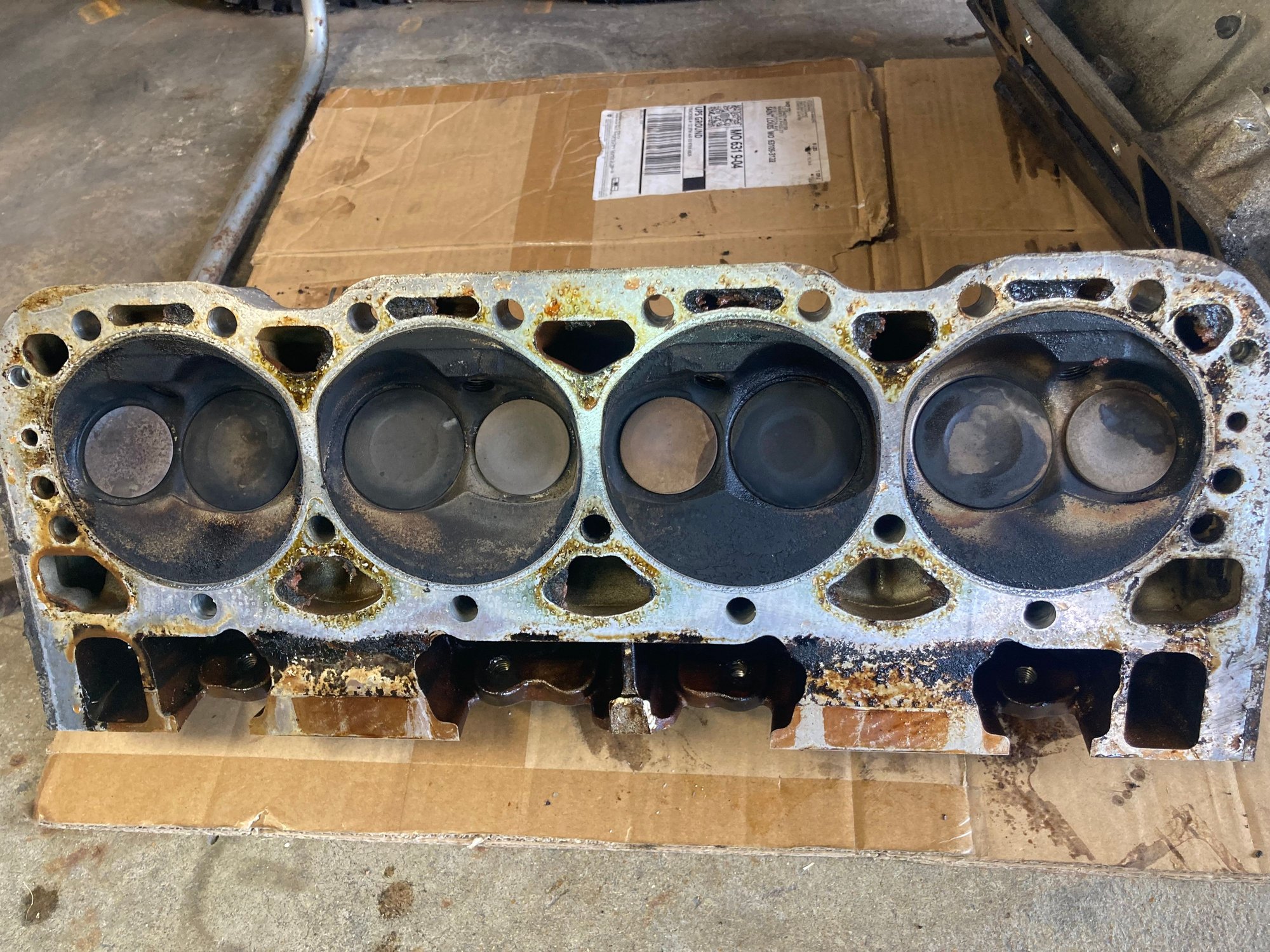

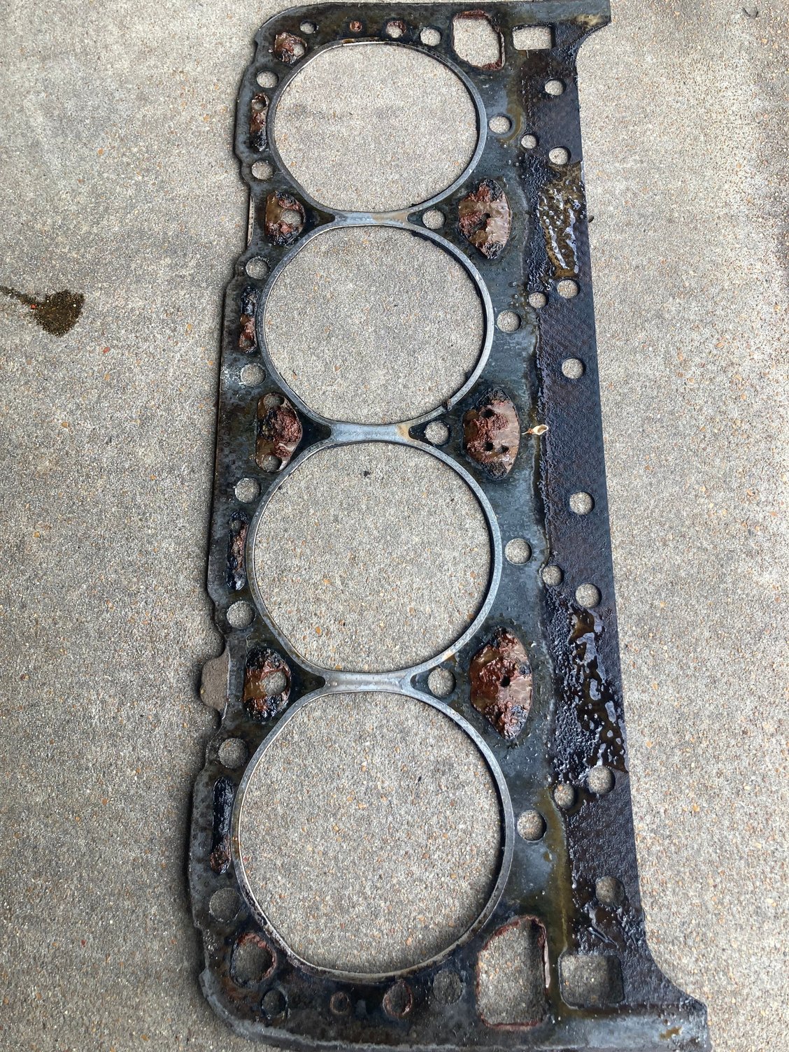

Default Update
Gasket left
Gasket left
Block left
Block left
Head left
Head left

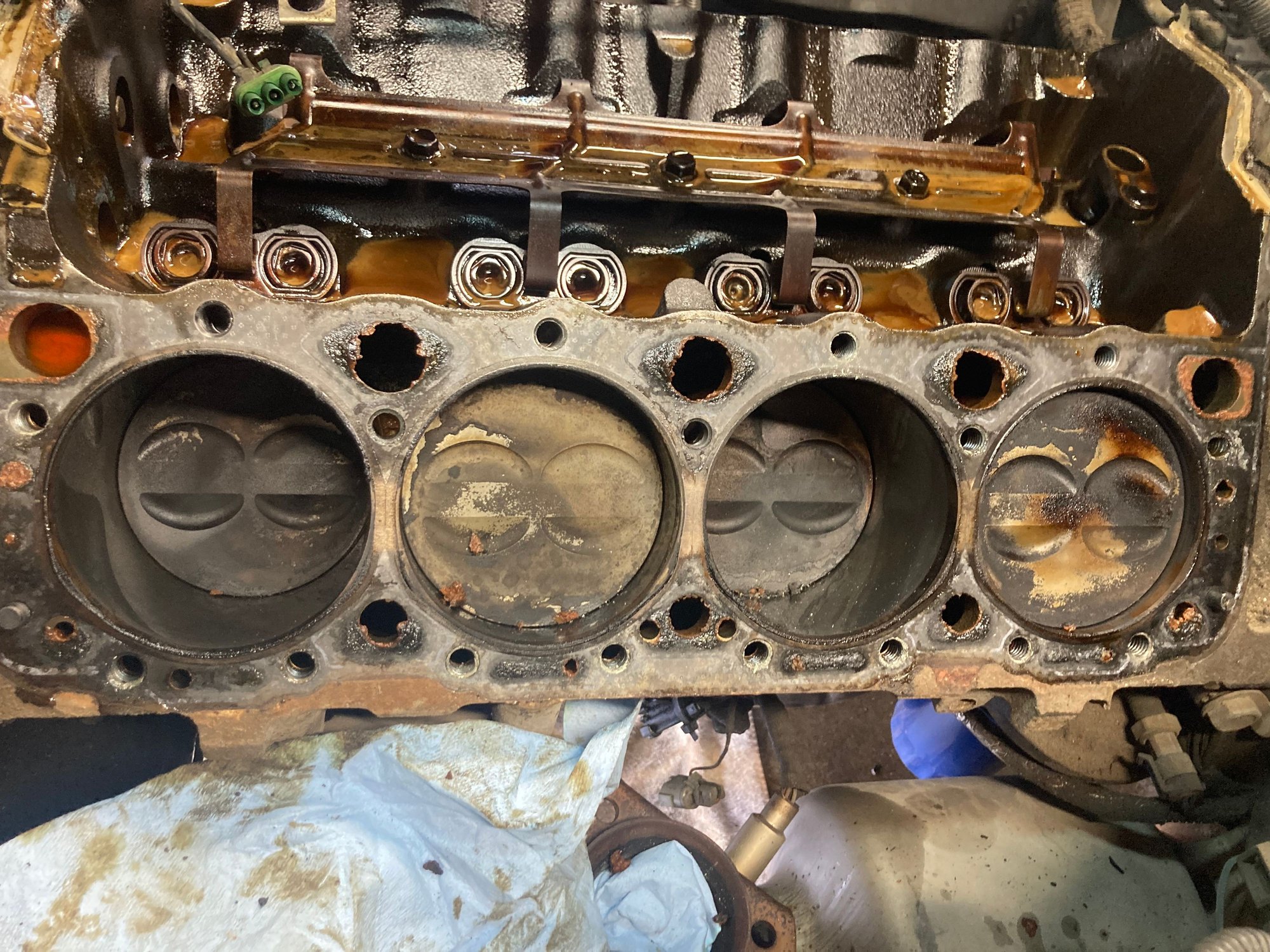

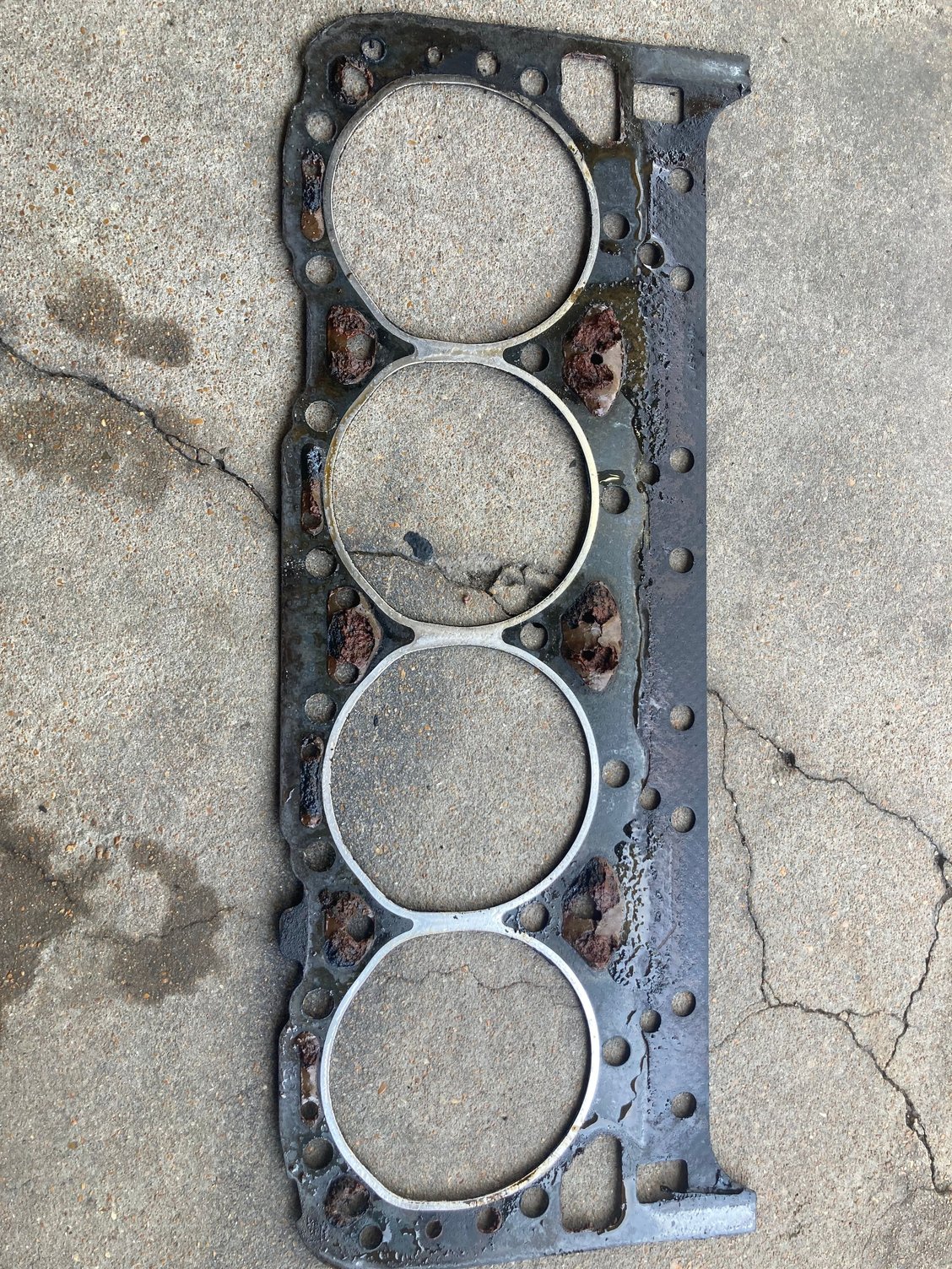

To Head gasket?
Old Apr 13, 2025 | 03:28 PM
gtFOOTw's Avatar
gtFOOTw
Joined: Mar 2022
Posts: 120
Likes: 61

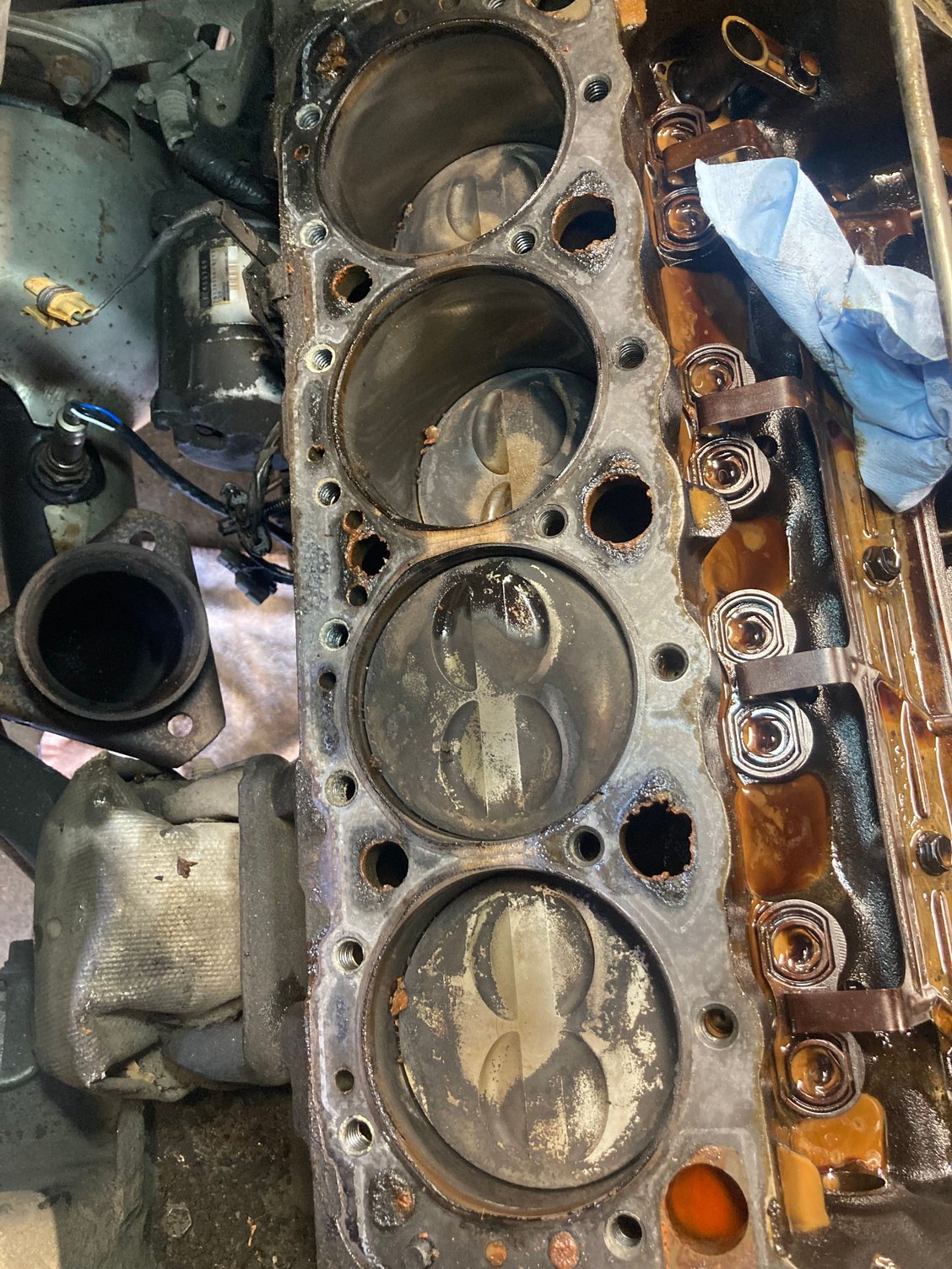

Heads are off! I don’t see any obvious failures but I don’t know what to look for. Any experienced eyes see a problem?
Gasket right
Gasket right
Block right
Block right
Head right
Head right

Some additional information, when I pulled the knock sensors the coolant looked very pure, so I don’t think much oil got in it.
But you could see from the “milkshake” in earlier pictures there’s definitely coolant in the oil. Another odd thing, the intake manifold bolts were very loose, some seemed finger tight, is this normal?
Old Apr 13, 2025 | 04:23 PM
JD1964's Avatar
JD1964
Joined: Apr 2014
Posts: 829
Likes: 192
Take some pictures of the intake gaskets, especially the ends that go around the water jackets. You might have been losing coolant into the crankcase via bad intake gasket
