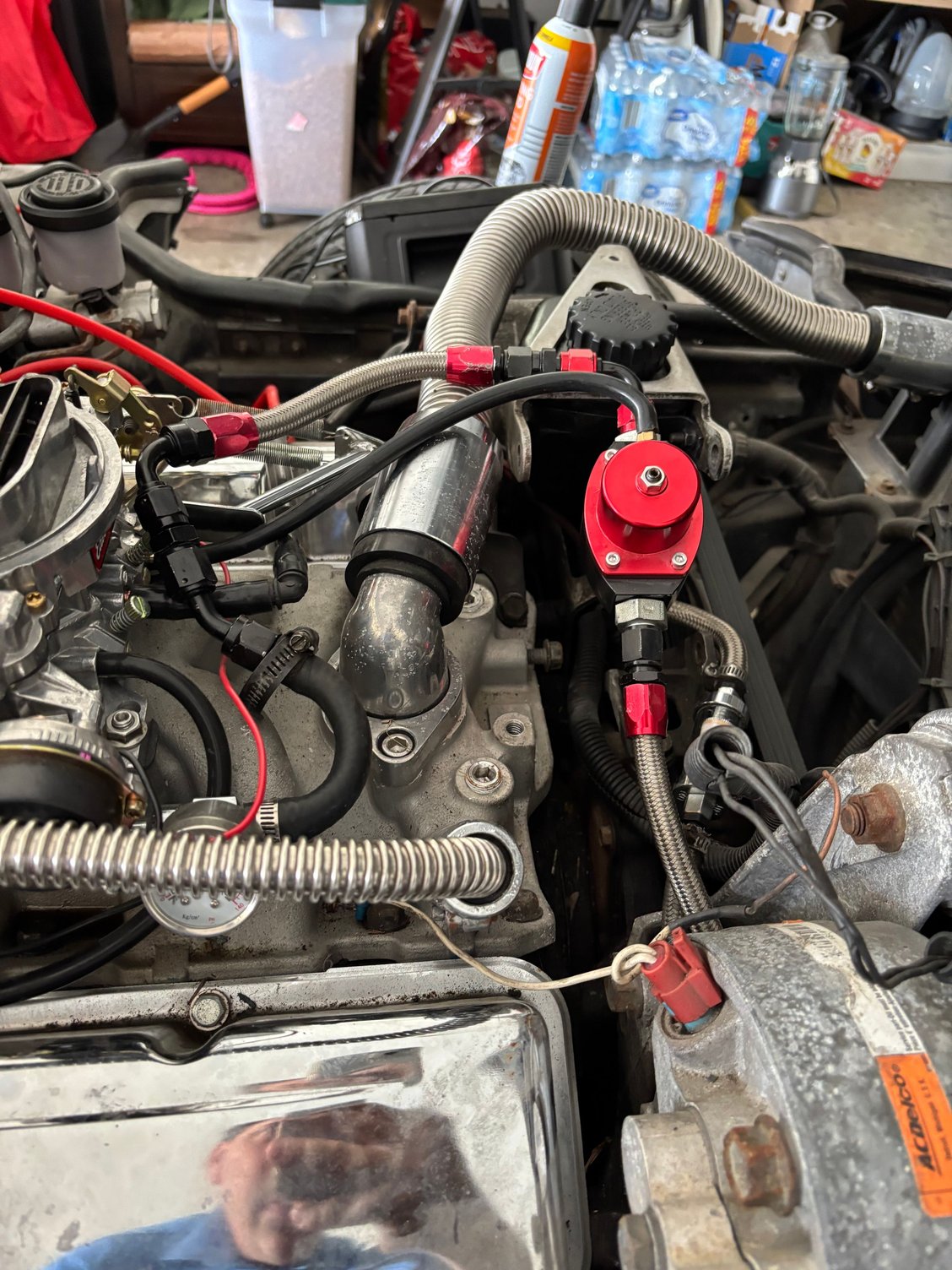

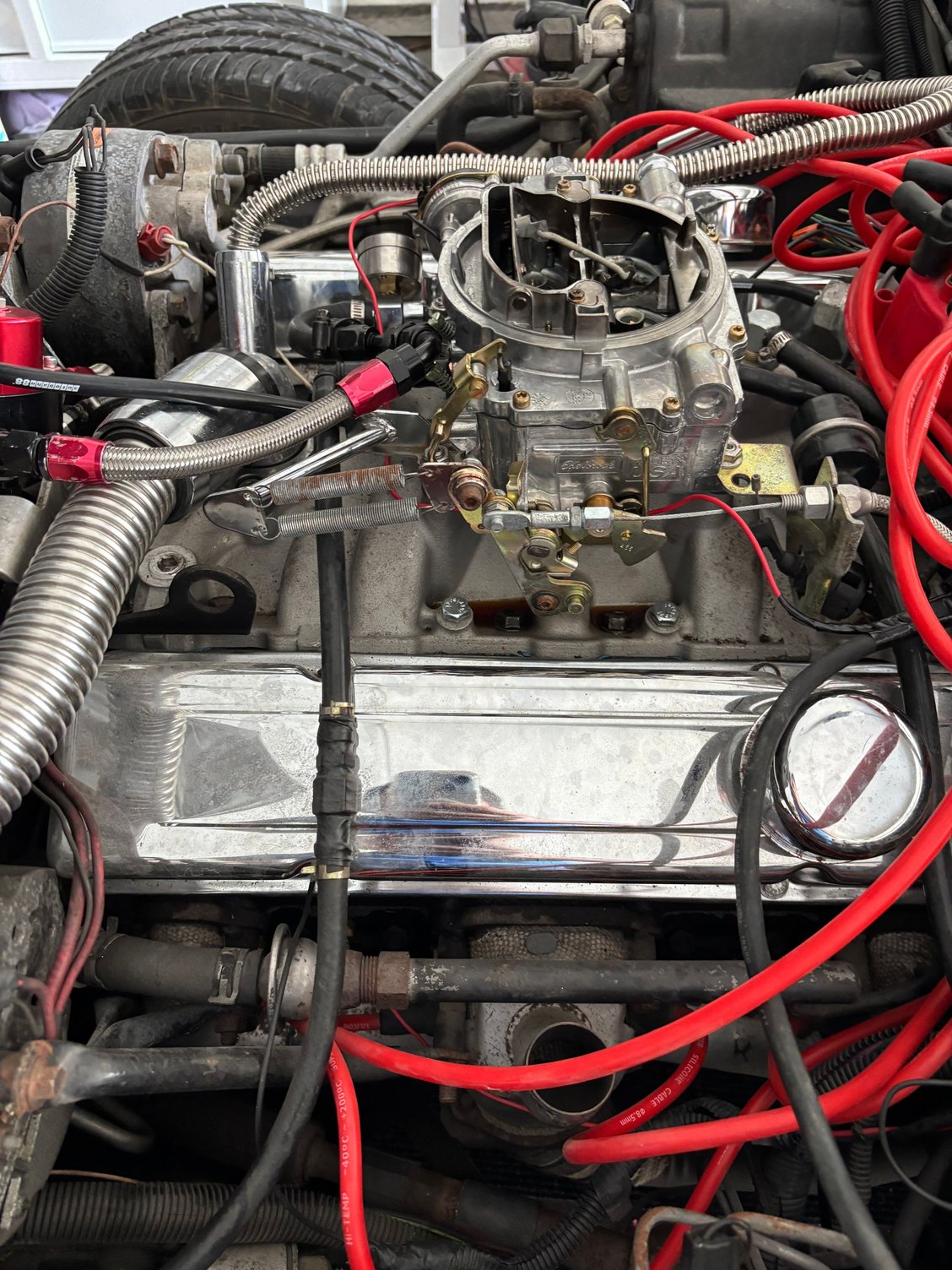

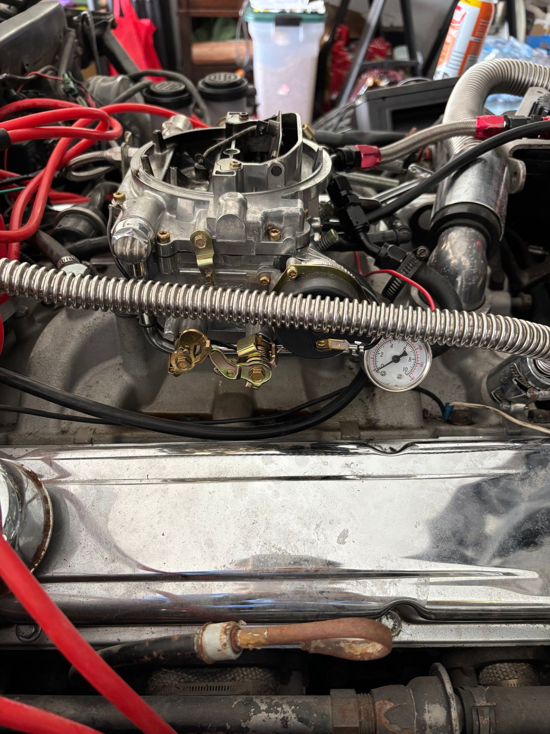

A few engine pics, aside from me moving the spark plug wires and distributor, this is pretty much how I received the car.

Ok, so it is a carbed L83, not an LT1
Has some dress up components on it too with a FPR and gauge which will make FP troubleshooting much easier 👍🏻

Yes L83, sorry I have LT1 on the brain. Currently the gauge just sits at zero. I did turn the FPR all the way up (full clockwise), still no fuel.

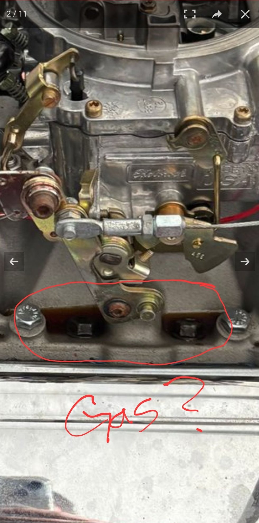

Is that glass fuel filter on the return line? What lines are hooked up to what/which ports of the FPR? Is there fuel to the FPR? Also, I see the vacuum source for the FPR is hooked up to the carburetor, does that carb port have full intake manifold vacuum? Do you have a vacuum source on the back end of the intake where you can get vacuum for the FPR? Finally what model/brand FPR do you have there?
Is this gas or oil? If gas, your carb seems to pressurized....I would take the gas cap off the tank and see if you have a pressure build up! If it’s oil, youre missing thread sealer on the intake bolts and possibly have a major vacuum leak going on....
Is this gas or oil? If gas, your carb seems to pressurized....I would take the gas cap off the tank and see if you have a pressure build up! If it’s oil, you're missing thread sealer on the intake bolts and possibly have a major vacuum leak going on....
I see a number of things to address in these pictures, but will keep it to the subject at hand for now👍
Is that glass fuel filter on the return line? Yes
What lines are hooked up to what/which ports of the FPR? Fuel feed from tank into FPR, then going out of FPR on the other side.
Is there fuel to the FPR? Not currently but does smell of fuel
Also, I see the vacuum source for the FPR is hooked up to the carburetor, does that carb port have full intake manifold vacuum? Not sure to be honest.
Do you have a vacuum source on the back end of the intake where you can get vacuum for the FPR? No
Finally what model/brand FPR do you have there? Hypertune
And yes,, that is fuel sitting down on the intake manifold.
