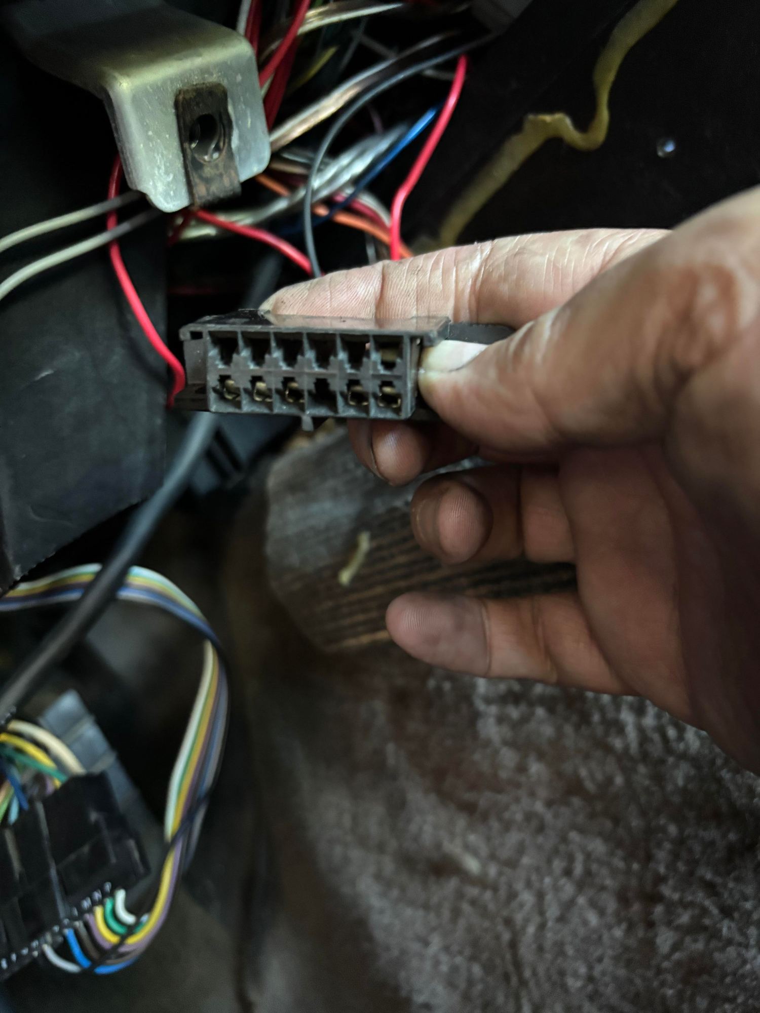

Found the ALDL finally. Took one last look under the dash and behind the upper left side of the radio there it was. I still cannot explain the fuel pump though. Pulled it out of the pickup and even with direct 12v it does nothing. So, the top right pin is the jumper for the fuel pump supposedly from what I have read.
Yeah... sounds like the fuel pump is dead then. It does happen. Is there water or anything in the tank? Just curious.
