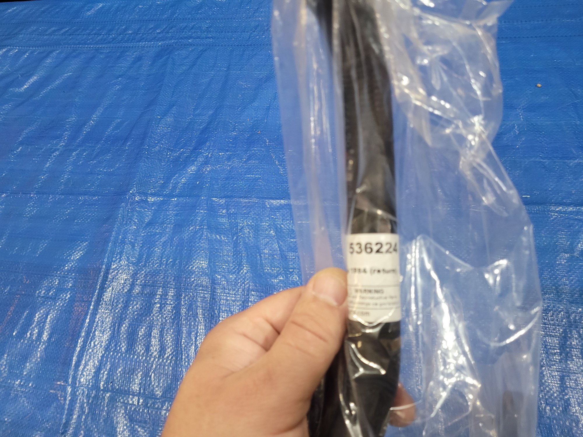

If you choose to replace the return line, the only source I could find recently was a Davies Corvette version, might have bought it through Corvette Central part #564371....when you get it, it won't look right, it's molded that way on purpose, so when installed it stays tight/tucked to the pump assembly
Davie's part# 536224
Davies part# 536224
Thanks, I imagine I will change them soon enough. Really appreciate the part numbers and source.
