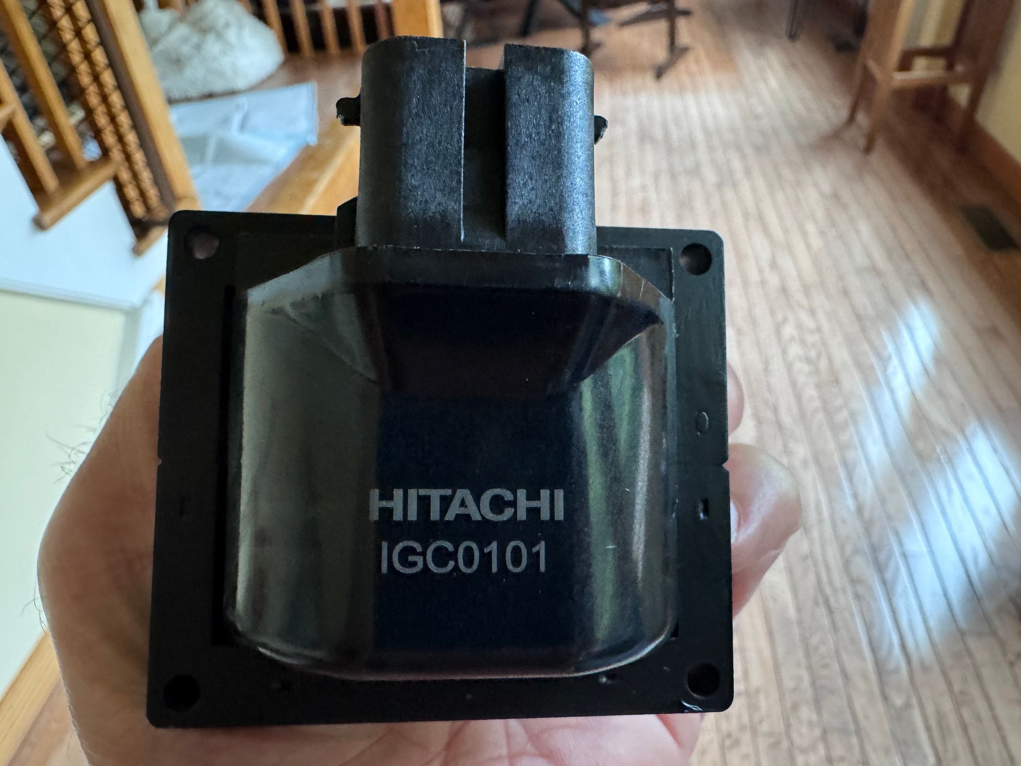

Well it seems it is not the ignition control module. I ordered one along with the coil and installed the new ICM tonight (using the right amount of thermal paste!), took it for a test drive and it died in the exact same spot it died last time and was subsequently intermittent as it had been before, so I will read the codes and plan on swapping out the coil as well.

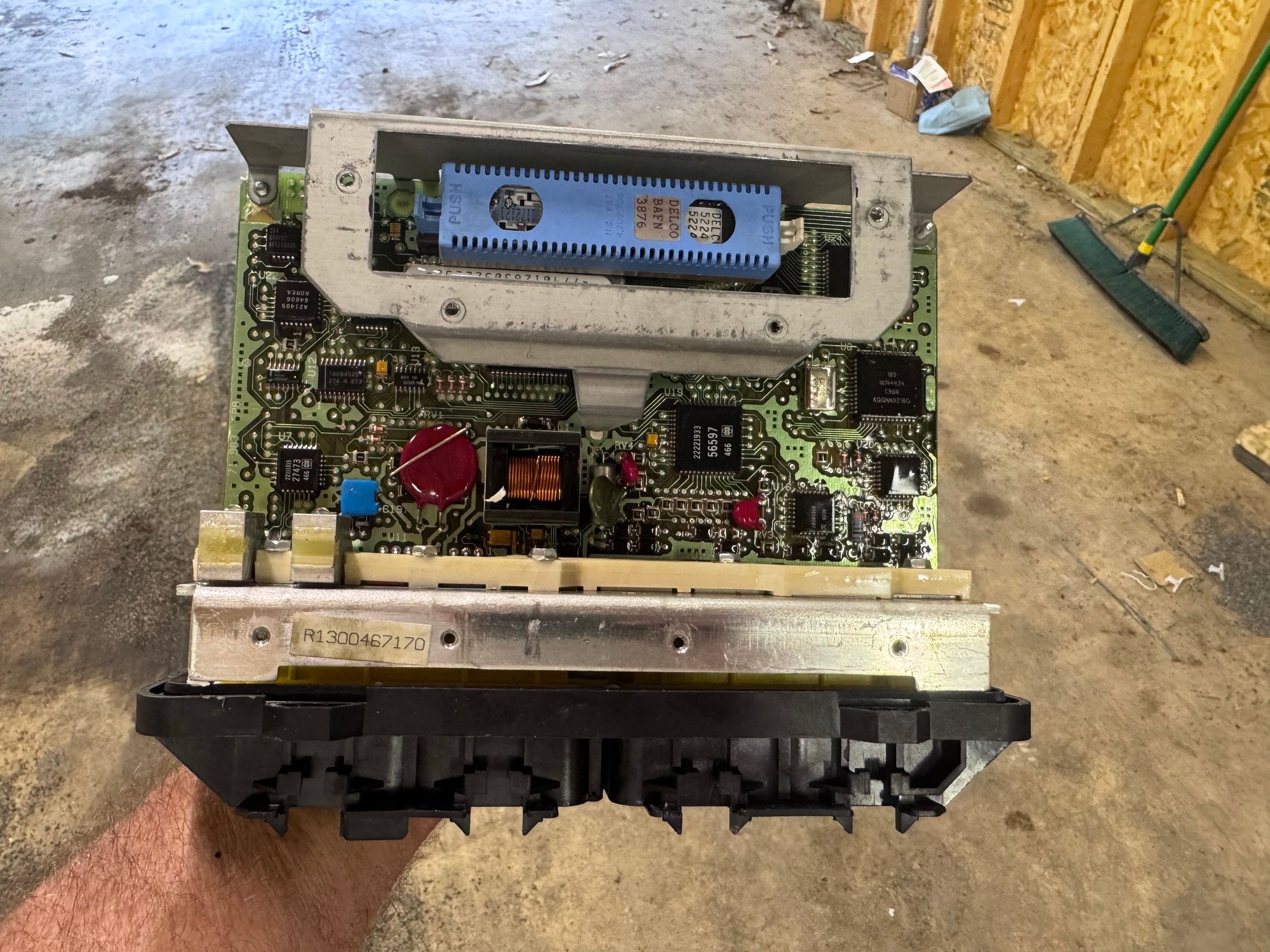

92 and 93 corvette ECMs have known solder problems on their circuit boards causing problems like you are having. You can send your ECM to SIA Electronics and they can test it and reflow the solder on your circuit board if needed.

Thanks for this. I have replaced the ICM and coil and have the same issue, so I will be sending the ECM into Sia Electronics.

Originally Posted by 81c3
I had an MSD unit fail after just 1 year on a 93 Z28 I used to have
Are you referring to an MSD coil or opti-spark? I replaced the original failed opti-spark with an MSD setup and that only lasted a year or two, out of spite I bought the cheapest Chinese opti-spark I could find and that has held up thus far.
I work for Hitachi so I thought I would replace the coil with one from Hitachi, but it seems that was not the fix...

SIA will most likely reflow the solder joints that go bad and test it and ship it back. So my 93 did this exact thing, 60 mph just shut off like I turned the key off. After I had to get towed a couple times I let it warm up in my driveway one day until it died. Then I put a ice pack on the ECM box and closed the hood for 10 minutes. When back out and it started right up, then when it got hot again died. SIA reflowed mine, but when I got it back it was still doing it with less frequency. So I sent it back under warrantee and they reflowed again, but while I was waiting a week or two I found and already repaired one for a good price and grabbed it as a backup. When the SIA one came back I swapped my PROM into the one I bought. Since I have been put 3-4k miles on it and never had a hiccup. I still have my original SIA repaired one as a backup in case. I also did a VATs bypass as my security kept shutting it down when the wires broke inside my ignition switch for the VATs resistor.

Throwing this in here because I have a degree in microelectronics. Circuit boards built in the C4 corvette years have much poorer quality solid state devices on them (resistors, diodes, capacitors, etc) than current tech, and they are more prone to heat. The ECM sounds like it may have a fail-safe circuit to protect from heat (not sure, I am still learning C4 stuff, but the possibility is there), and thus shutting off the ECM in an over-temp scenario. If not then it's likely just to much heat on the board in general, which would also cause a shut-off scenario. If you could keep the ECM cooler/ventilated better, you would see positive results.

Just got a call from SIA, they said the ECM checked out fine and they could not get it to fail, they also said it looked like it had previously been re-flowed, which I am skeptical of, but I guess it could have happened, so where to look next?
