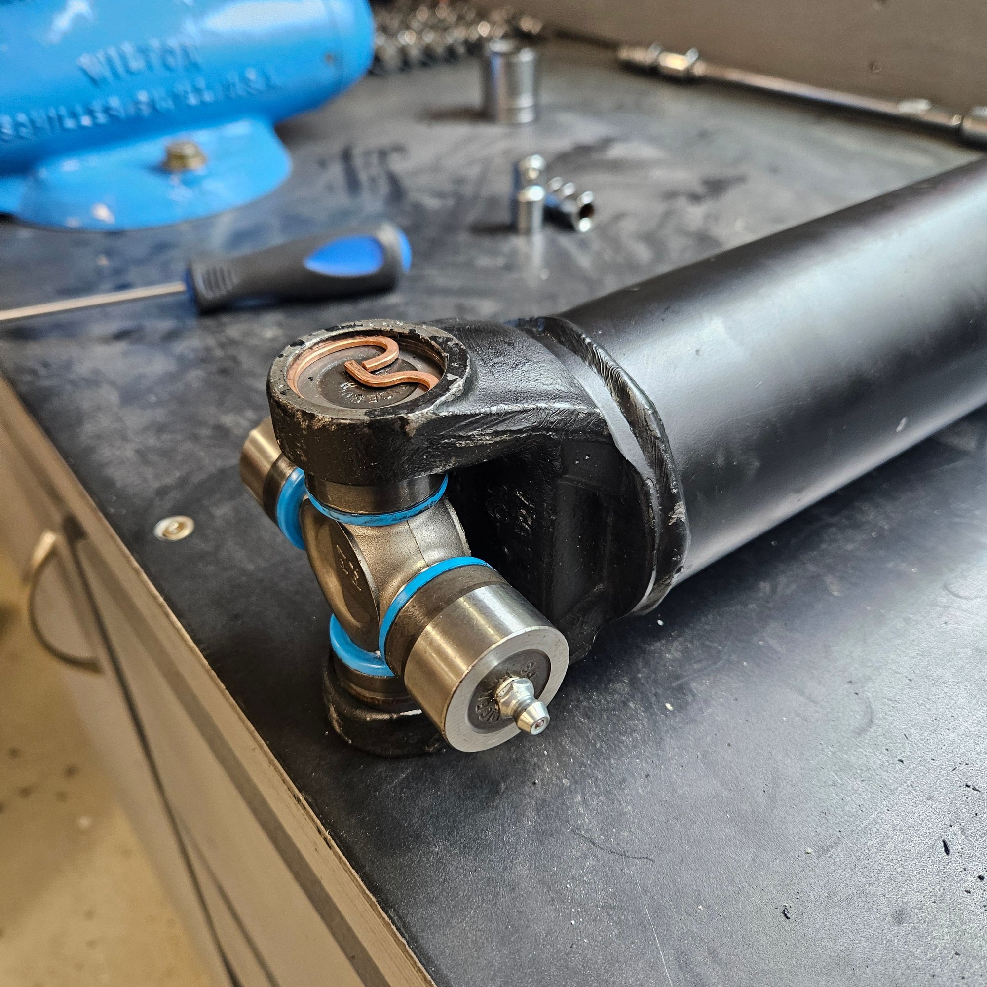

Interesting info, yes the driver's side inners alwas seem to have the worst wear on my car, although the driver's side outer also had some wear but less. The passenger's side were fine, I'm just going to replace them to be safe but nextime I might just do the driver's side. We'll see if using a greaseble spicer u'-joint and adding grease once or twice this driving season has any effect, its long shot bit maybe...

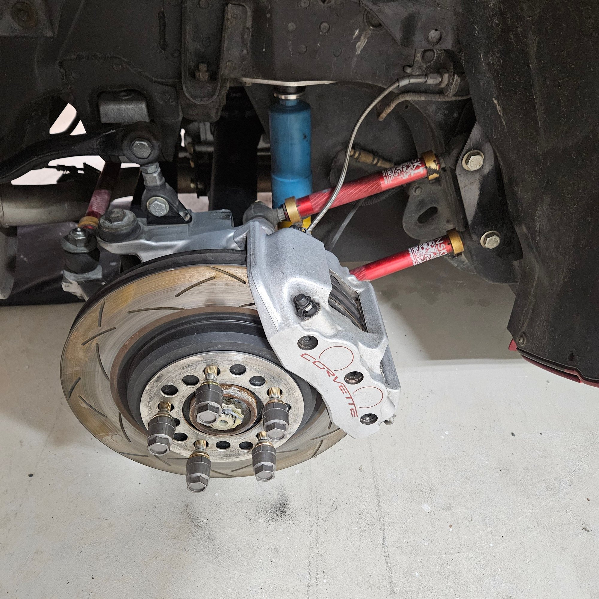

Do you guys think the car being lower (maybe 2inches) is partly to blame? I fairly carefuly dialed in my ride height to being as low as was possible without bottoming out on things and have it aligned at that height. This ride height also seemed best based on autocross testing I did years ago when dialing in the suspension. However if it lessens the u-joint wear I could raise the car up a 1/2in or so. But not sure if the ride height has any effect on the u-joints?

Mines lowered as well. I extended my bump stops a little and run my rear shocks pretty stiff at the track. For best life I believe you should try to keep the shafts all level so there's no binding. Some guys have even raised the *** end up trying and keep them more level. I don't know if it helps or not. I just think all the power is hitting that u-joint first and taking the brunt of the launch. I don't think the grease even matters it's just the blunt force trauma applied.

About 7 years ago when I changed the u-joints on my 96 I bought the non greaseable ones. I live on a gravel road. In retrospect I wish I had used the greaseable ones. I don't drive hard when I need the extra strength. Dan

I have a gravel driveway. I defiently need the U-joints to be strong with 500+HP and sticky tires + a manual trans...but it seems like the needle bearing are the weak point in the u-joints so, ya we will see if greaseable ones last any longer.

I think one of the keys is to give them a small squirt of grease every 6 months or so. If you let them dry out a little and go to grease them sometimes it is only one of the four bearings get grease. The easy one with the shortest path. I learned this lesson on my big lawn tractor. The ones you got look much easier to grease than the ones with the zerk in the middle. Dan

These u-joints on the corvette were replace last May, and had 3000miles on them since then. I think I will likely grease them once a month once I start driving the car in the summer.

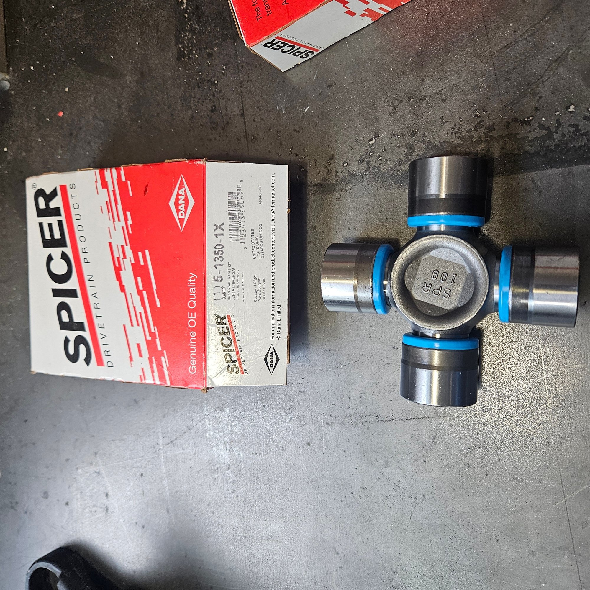

Since reading this thread I decided to get four u-joints for my 96 and change them in my heated garage next winter. From my research I think I have come to the conclusion that Spicer does not make a u-joint to fit the halfshafts for my 1996 with both the cap coating and a grease zerk. I keep coming up with Spicer 5-3615X which fits and has the cap coating but has no zerk. I guess I have to decide if I want the zerk or cap coating but not both. I thought about contacting Spicer and ask but I can't find a contact email anywhere. Dan

Yes, that is a good point. My halfshafts are Chromemoly so I don't need the U-joint coating. But if you have the stock aluminum halfshafts ideally you want the coating to stop corrosion/oxidization.

I think the main issue is that a 1350 is a truck u-joint meant for driveshafts. Get into high rpm torque production with rapidly changing angles, and the 1350 wasn't really designed for that.

Agreed, and the suspension loads since the half shafts act as an upper control arm are also a factor.
I upsized my driveshaft from 1310's to 1350 U-joints and those seem to do ok in that application but I think in the halfshafts they are likely just subjected to too high of load forces. i'm giving the greaseable ones a try and we'll see but I suspect the only true fix is to backhalf the car and redesign the rear suspension to use upper/lower A-arms and a beefy axle/CV joint, which also proabbly means also a different differential too. That's a major project, if anyone wants to pinoneer i'd love to see what you all come up with...
