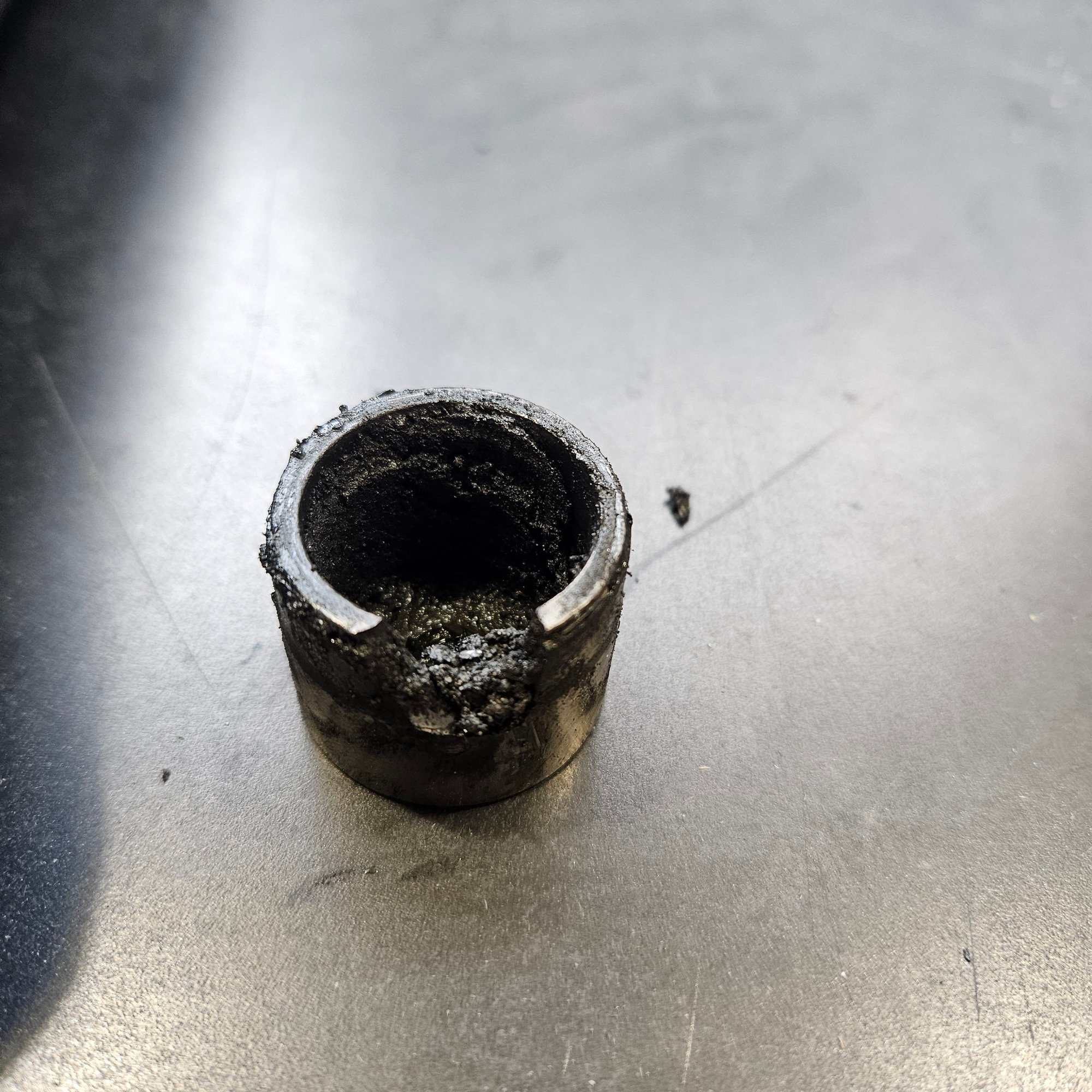

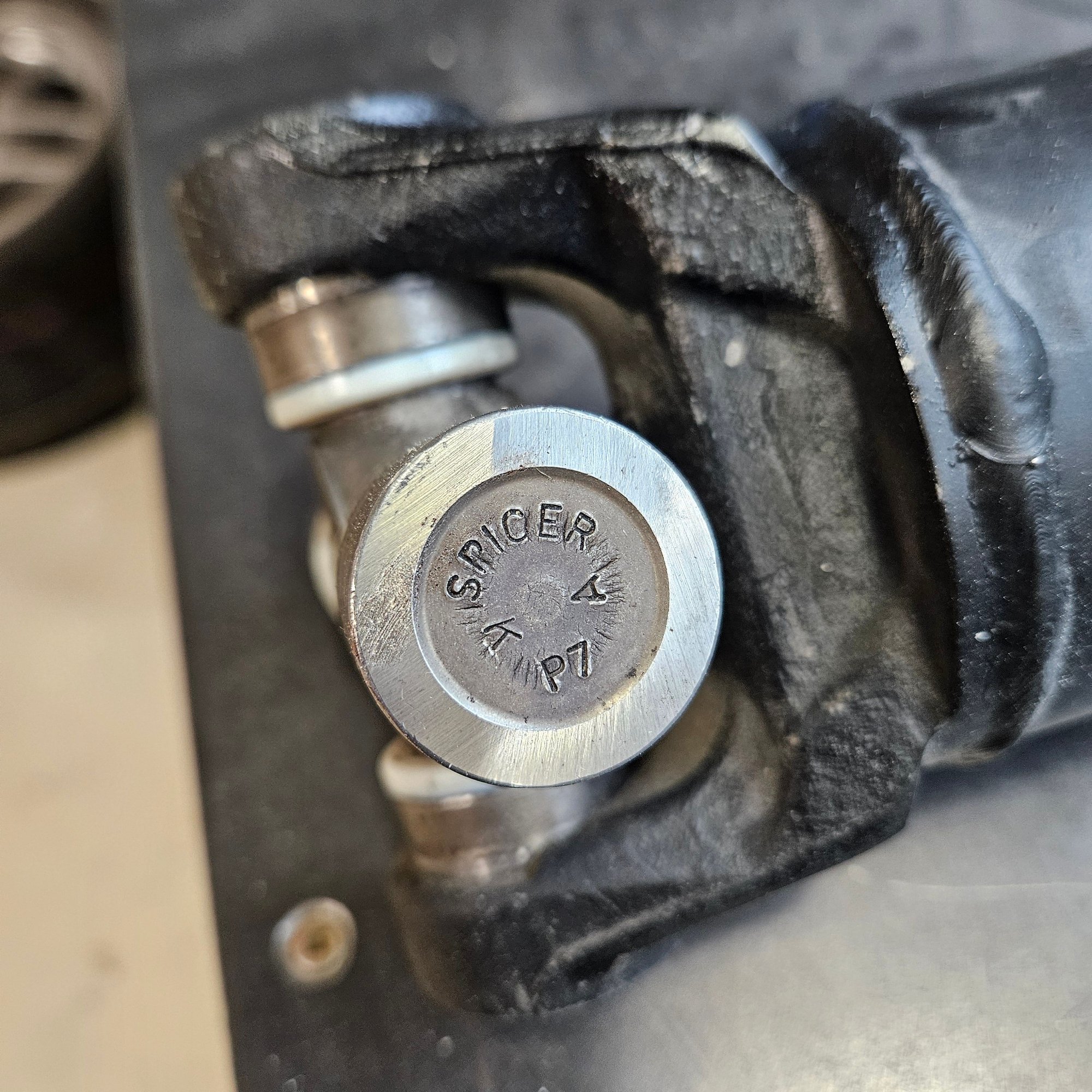

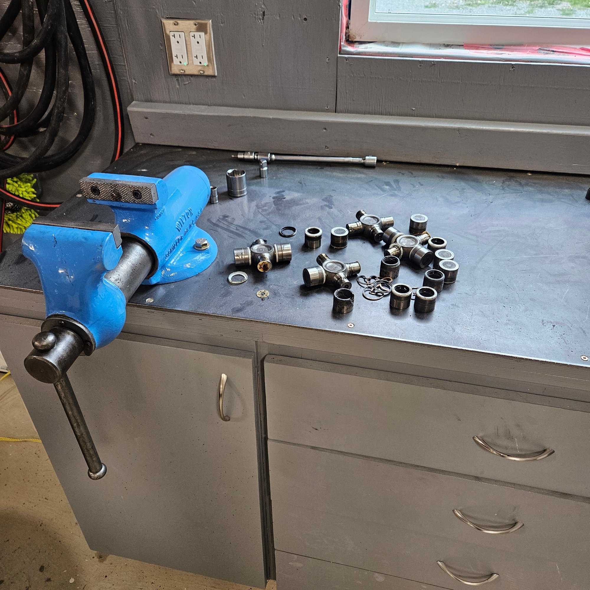

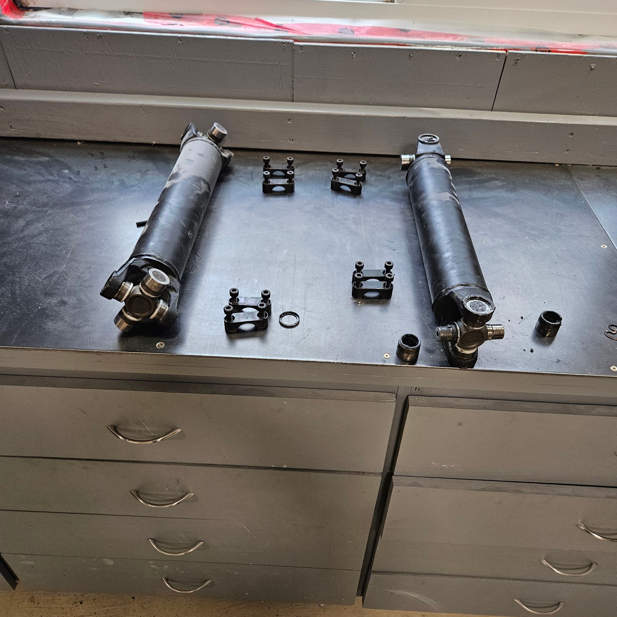

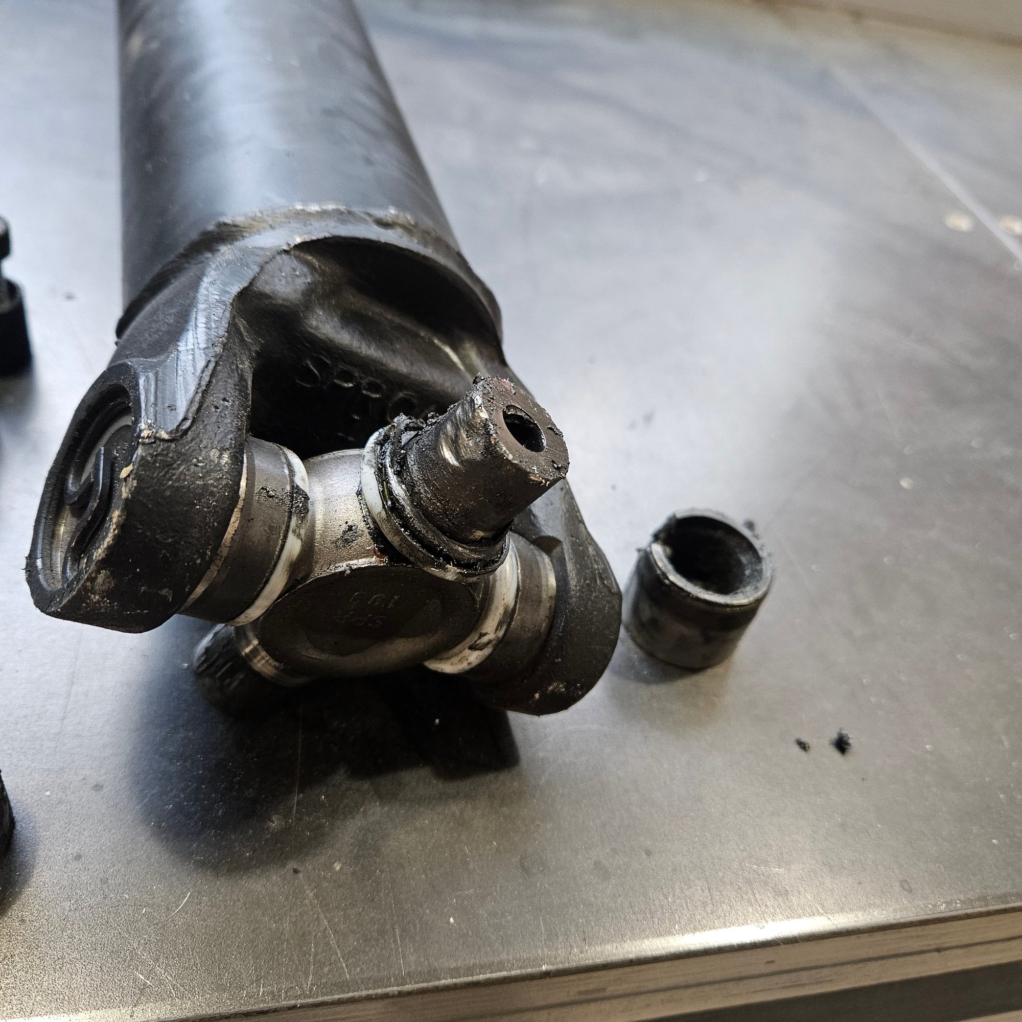

Ok guys I pulled the halfshafts out and confimed that after only 3000 miles the U-joints are trashed. These are solid Spicer 1350's

Originally Posted by FostersPerformance
I understand the solid u joints, but to not be able to grease them sucks. So I wonder how much grease is in them when new? Probably the least amount possible. Almost looks like yours are dry?
I took them apart and added lots of quality grease before installing them.
