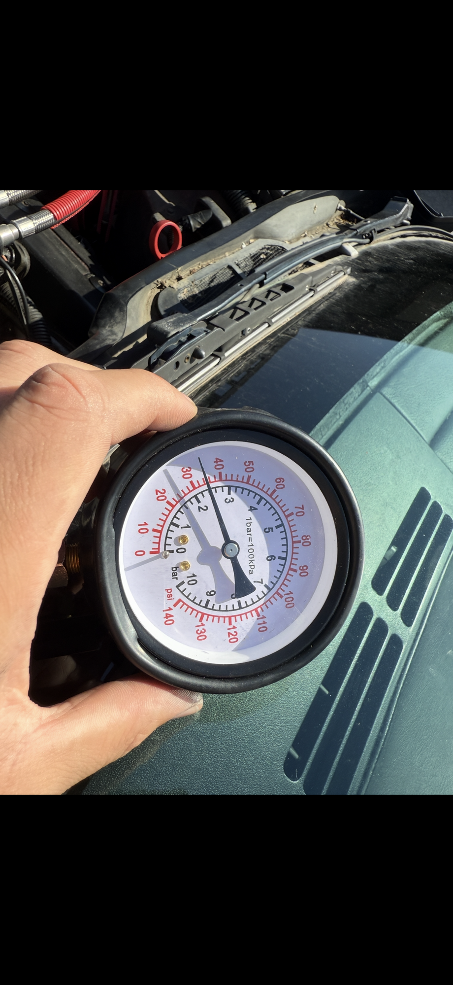

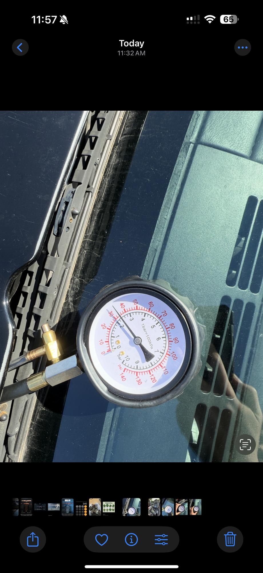

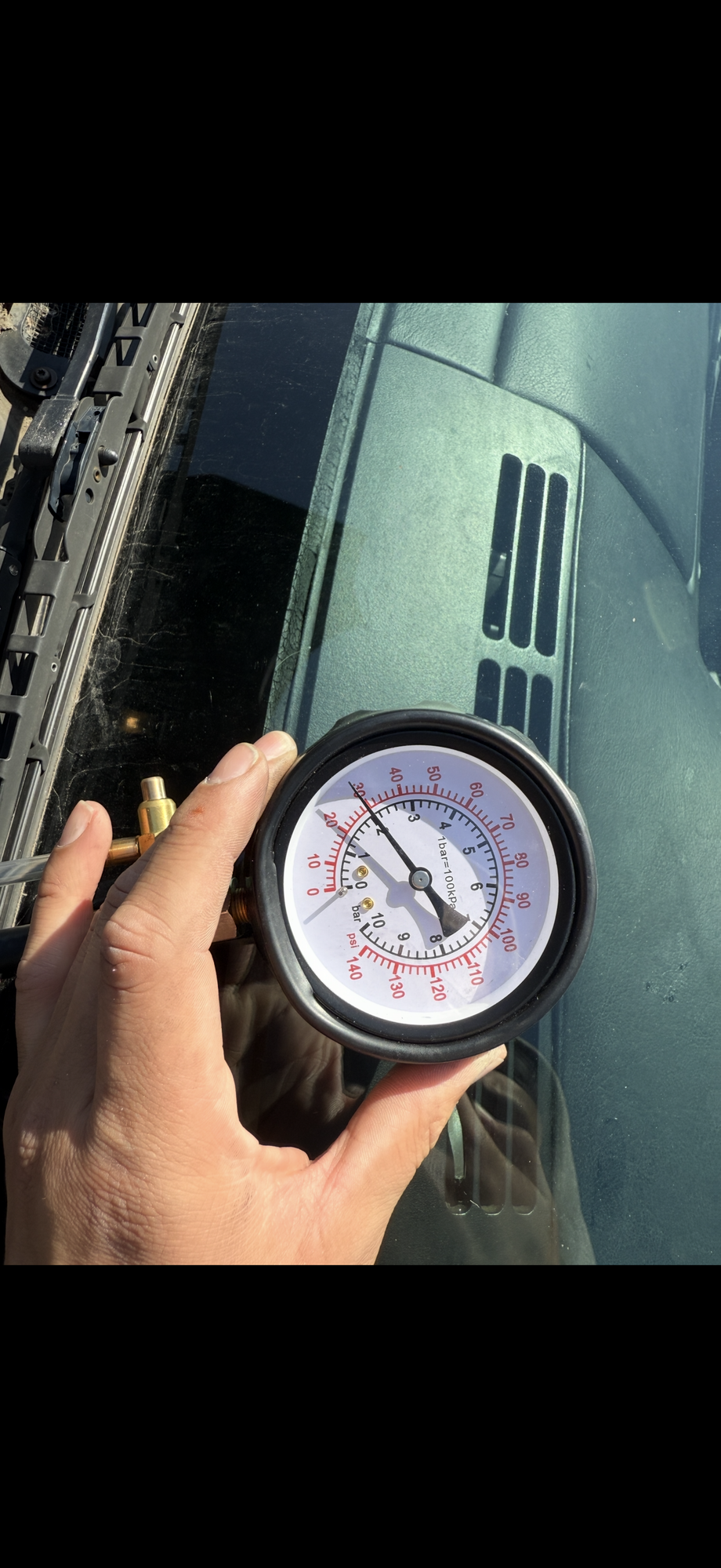

I only have about 2-3 gallons in the tank. The first pic is priming the pump, the second pic is the car running, third pic is the car being off for 10 minutes, and the fourth pic is the car off for 20 minutes. The car doesn’t cut off and when I take off the vacuum hose from the fuel pressure regulator the fuel pressure spikes up to 40 psi. My question is do I have to put in more gas to get more fuel pressure?
1st pic
1st pic
2nd pic
2nd pic
3rd pic
3rd pic
4th pic
4th pic

There is nothing wrong with your fuel pressure. At idle the fuel pressure will be reduced by engine vacuum so the pressure across the injectors is still at the same relative difference which is around 43 PSI. You have 40 PSI at the rail on your gauge with the vacuum line off and the engine at idle, that is fine. The real question is what is the pressure at WOT when driving, if it is still at 40 PSI that is fine.

That is fine, that is what it should be around idle, as explained the fuel pressure is reduced at idle by the engine vacuum so the pressure across the injectors stays the same. If you have 10 PSI of vacuum at idle the fuel pressure will drop to 30 PSI because the 10 PSI of vacuum plus the 30 PSI of fuel pressure will give you 40 PSI across the injector where it should be.
