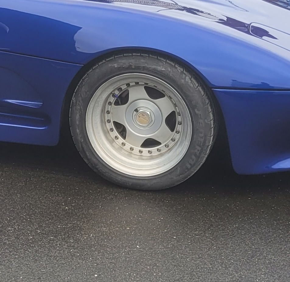

The car in my profile picture is indeed my car. Some more images:

Oh wow! You weren't kidding about wider body work! And those are some seriously dished wheels! So I'm going to retract my prior statement and say this instead: I think the car may actually be at stock ride height, but that front air dam and the side skirts are aftermarket and way lower than the stock pieces. If so, then your springs might both be good condition but the car just hits the ground because of those lower body pieces...and there may not be any lowering to undo. It's hard to tell with this aftermarket body work. If someone reading this has a know-stock 1992 with the FX3 suspension (73.2 N/mm front spring and 39.9 rear), then perhaps you could both measure from ground to the center of the front lower control arm bolt or some other clear reference point to compare ride heights? Also, we'd need to know what size tires you're running to account for any differences in diameter.

It definitely sits lower than stock as i am hitting the headers on some occasions, the part where the headers and the exhaust are connected. I also easily hit the "front splitter" or whatever it's called. The body kit might make it lower than stock but i don't think it would make it that low, pretty sure it's a bit lower than stock.
as for tire sizes:
Front: 275/40 ZR17 98Y
Rear: 335/35 ZR17 106Y

Okay, your front tire size is identical to stock, which makes comparisons easier. Rears are actually slightly taller than stock, but not by much. The splitter part is technically called an "air dam," and it looks quite a bit lower than stock. Note that even stock C4s with the deeper air dam sometimes scrapped on steeply inclined entrances, but those were flexible so it wasn't as bad of a problem when they did. Do you know what headers you have? Some brands hang down much lower than others, and that might be part of your problem. OTOH, my 96 had a roughly 2" drop with Hooker 2051 headers and they didn't hang down at all, so they never scraped on anything. I'm saying all that to point out that the parts of your car that are scraping are all afternarket and therefore aren't a good indicator of ride height or spring health.
