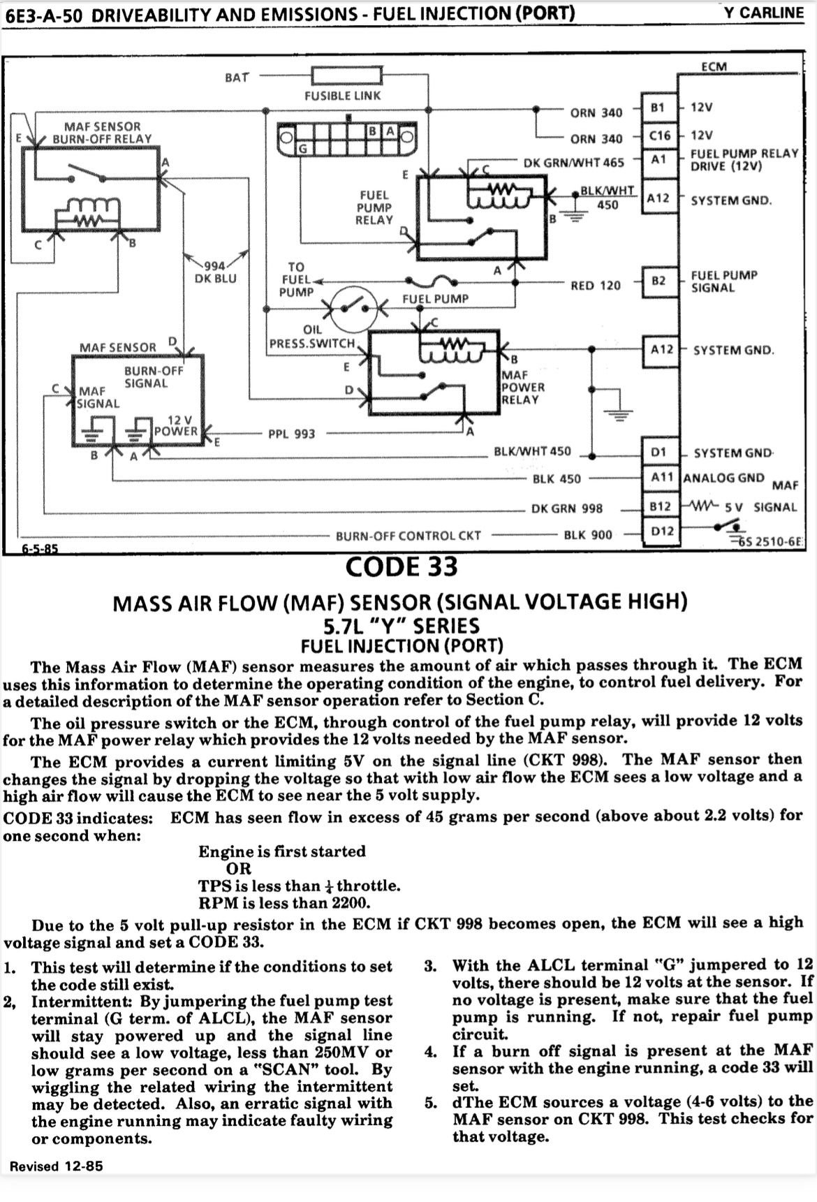

I don’t think the throttle body, regulator or chip had anything to do with your codes.
Follow the factory flow charts and isolate the part.

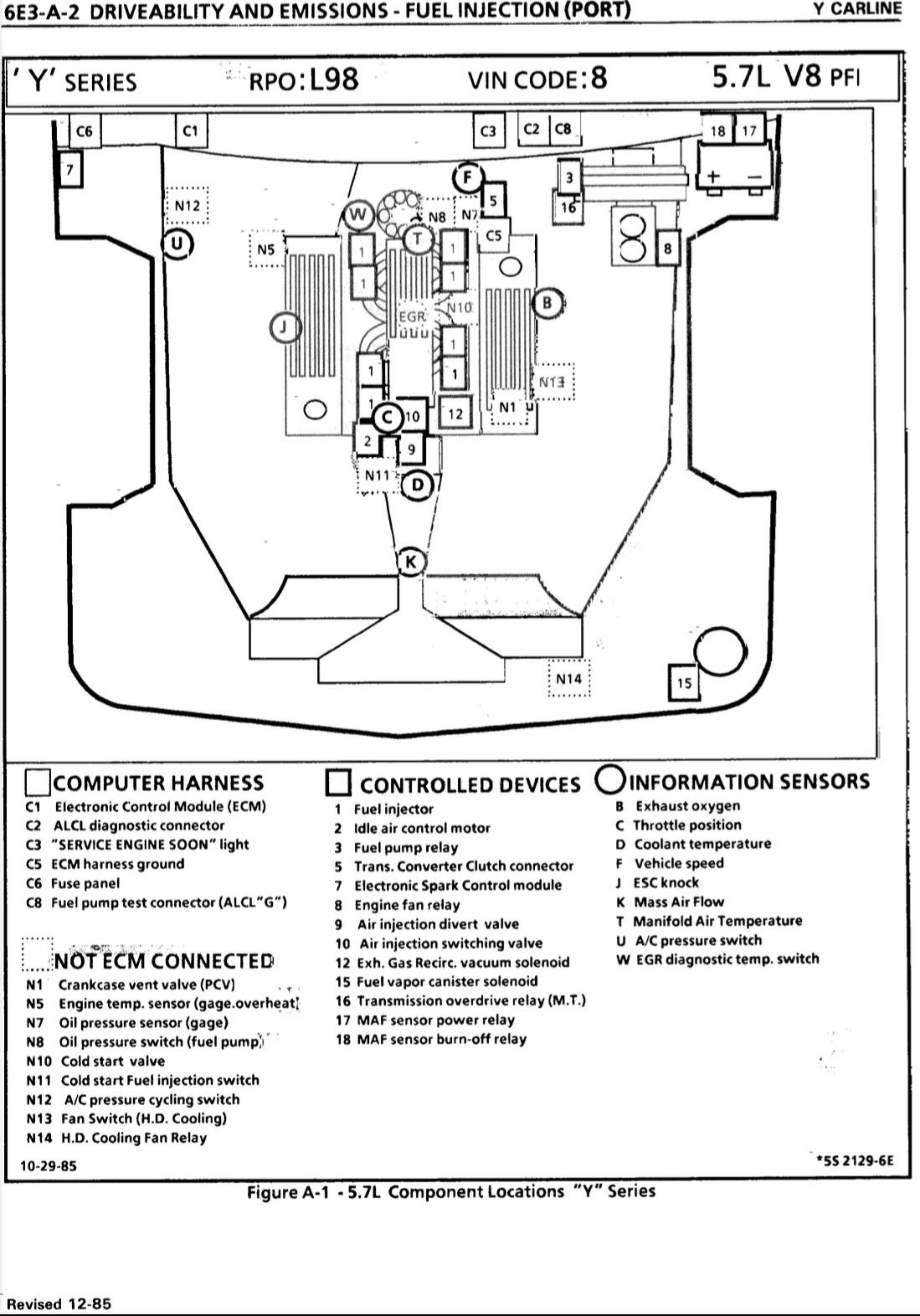

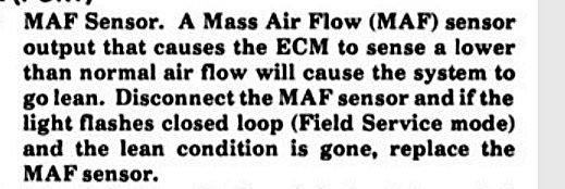

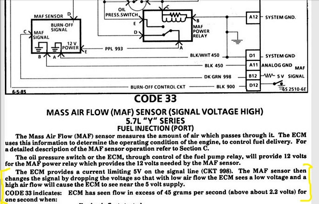

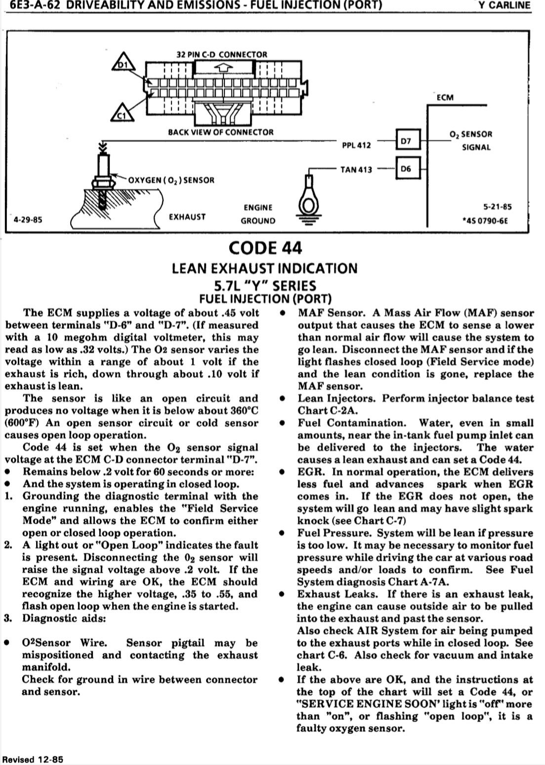

Agent 86 gave you the good stuff I just wanted to highlight something he gave you. Chances are the code 44 lean is due to the MAF issue, I cut and pasted what he gave you below. Since they may have disconnected the MAF and removed the air filter to TB tube to the TB for your repair I would hope it is a connector issue. I would do the test Agent 86 gave you, unplug the MAF and see if it runs better. Check the connector for pins pushed back and then Pin A for ground then pin C with a modern multimeter to see if it is 5vdc+ that means the MAF is not lowering the voltage to signal the MAF is measuring the air flow. This 5 vdc may be a low power circuit so make sure it is a modern multimeter
