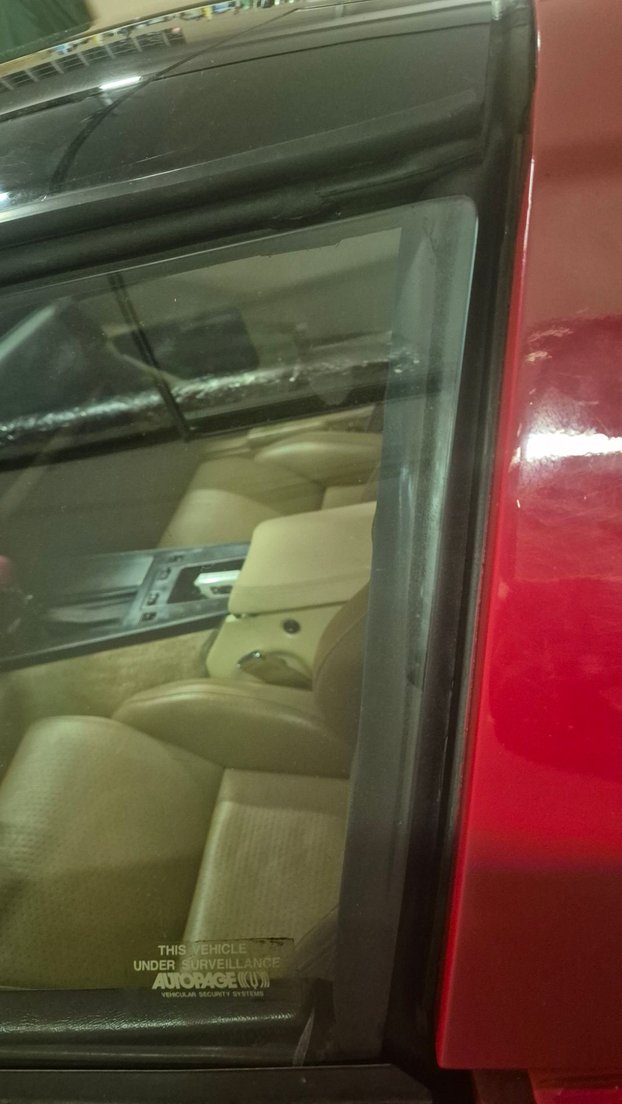

I have started to change my weatherstrips. I have put new ones on the roof then just put new one on the targa/B-pillar just to check without a glue.
First, obvious issue was to install back targa roof. I need to use some force to put it down and screw it finally one by one. This is fine.
Bigger problem I have with windows, I can not close windows or close doors with windows up as B-pillar rubber force windows outside. I can adjust them and check if it can run outside but then it will be problem to reach up position in roof's *****.
Did I installed it correctly ?
Wheatherstrips are from Metro and car is C4 85'
First pick with old weatherstrip in (it looks more compress, closer to the interior):
New seal + window up + targa:
It is visible that new weatherstrip push windows outside:
Is it this gap not too big ? It is ca 12mm/0.5inch) between plastic on B pillar and rubber's edge:

The weatherstrip does look too big and too hard as it does not compress, I used CRC brand and had great fit with the A pillar B pillar and targa sides. The CRC is the closest to shape of original, although not as soft as latex its more durable. Only the CRC door weatherstrips needed modification , to make closing the doors easier. however the other weatherstrips fitted perfectly and keeps the car dry and quiet.
You should be able to close the door to first click of latch and glass just touch the weatherstrips, then the final click of latch to fully closed should only depress the weatherstrip a little evenly.
The door weatherstrip problems are at the ends, they were not shaped as well as the factory weatherstrips and that is where the problem is with having to slam the doors. I did trim the door weatherstrips to the shape and thickness of the original, you have to also pay attention to the cutouts in the weatherstrip that fits onto the door. Once I made them fit correctly the doors were easy to close, however it is an involved trail and error process to get the door weatherstrip to fit right .... This should have been done by the manufacturer ..... I have tried many weatherstrips over the last 20 years the latex ones fit best but only last a few years, the CRC are the best fit apart from the main door weatherstrip I hope I just got a bad batch however have heard many have issues with the door weatherstrips needing to slam the door ..... 🙄
However the other weatherstrips from CRC fitted perfectly and doors close easily.

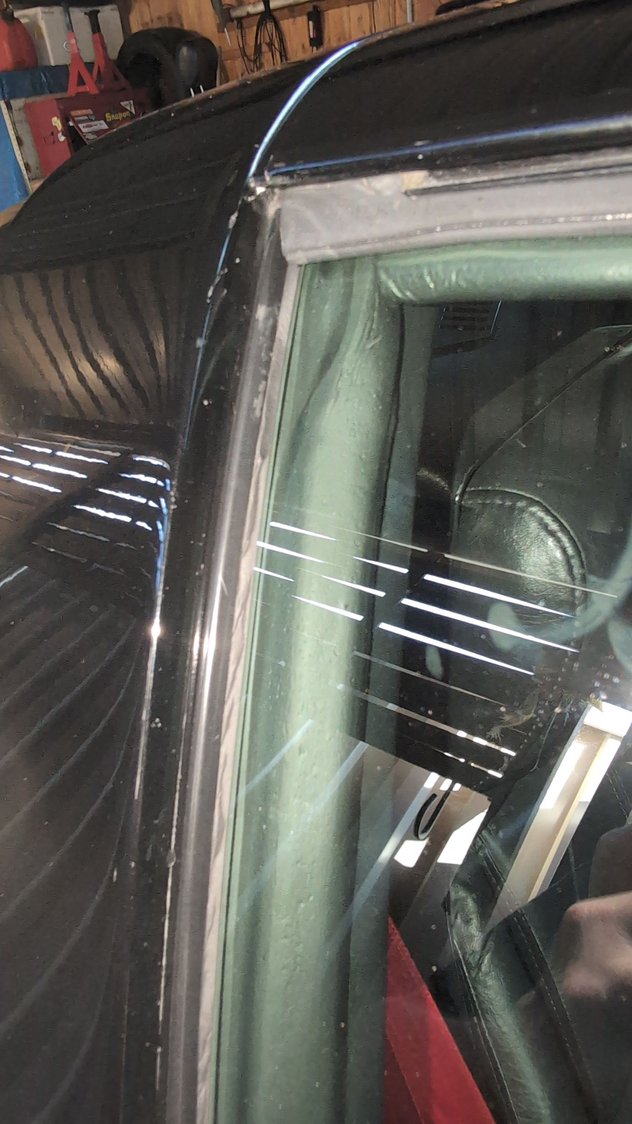

Here are pics of the CRC weatherstrip fitment for reference

Note the pic from inside car how the weatherstrip part the window touches is below the strip the weatherstrip is pressed into. It shows proud on your weatherstrip..

Ok, thanks for you pics. It looks that Metro seals are to wide. My window distance up to seal frame in B-pillar (without wheatherstrip) is 18mm, while seal has 30. Today I have cut from bottom about 8mm, then play with it to get proper shape. Doors close without big issue , but now I have problem with A-pillar. On the bottom it looks like it is too much rubber which press window outside. Need to cut there as well.
So if somebody will look for Metro seals ( 2000-106) I do not recommend for 1985.
