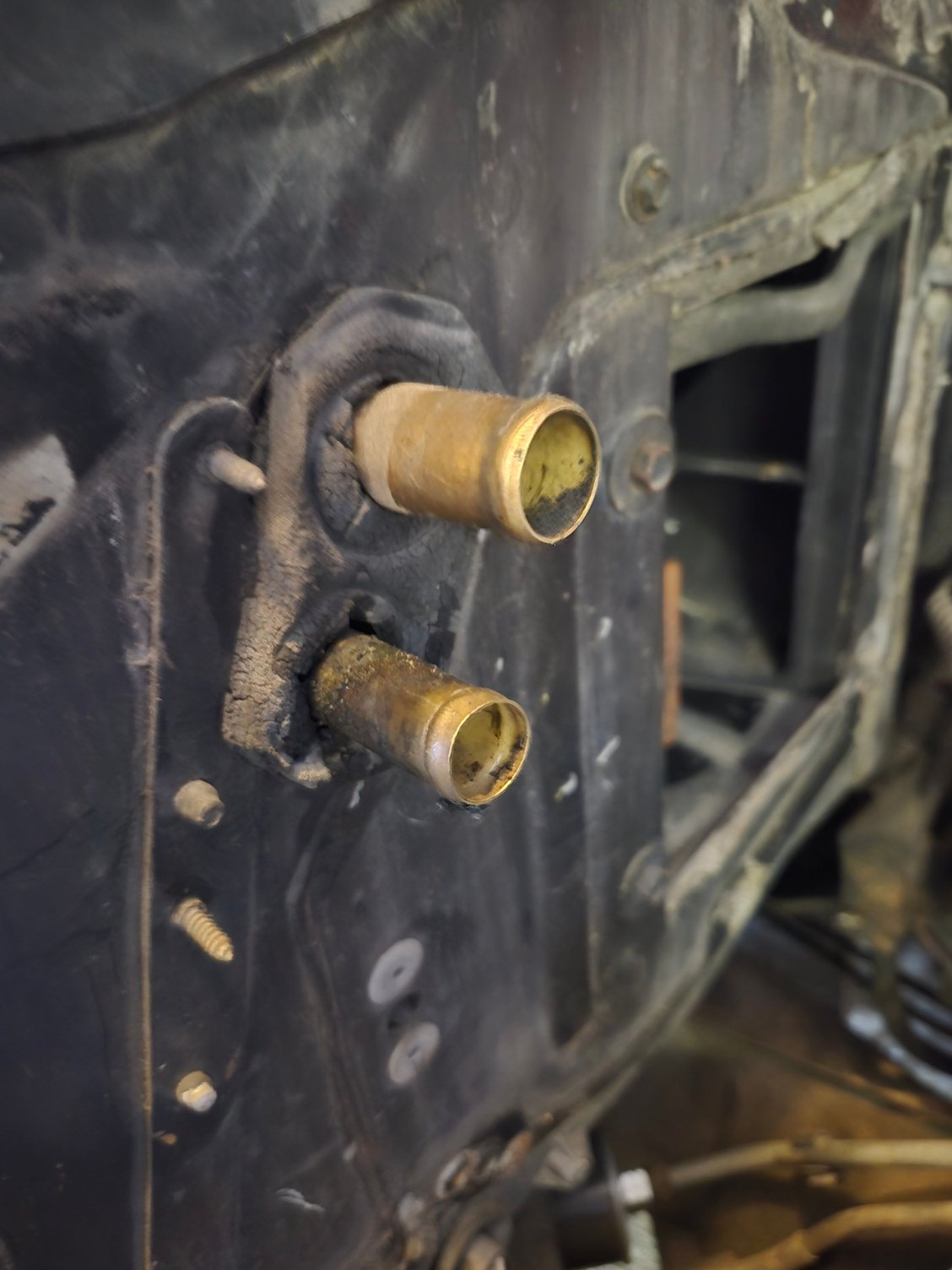

Ok guys wtf am I going to do here use a step key to cut holes in my block off plate and run the lines through it ? There's also some screws sticking out that won't let the block off plate mount flat ????

I pulled them out a little then cut the nipples off flush with a hacksaw blade. Same with the screws that keep it from sitting flat. Also when I put mine on I used a good bit of sealant to keep fumes and some hot air out. I got mine off e bay and had to “work” some of the holes it didn’t fit perfectly right away.
