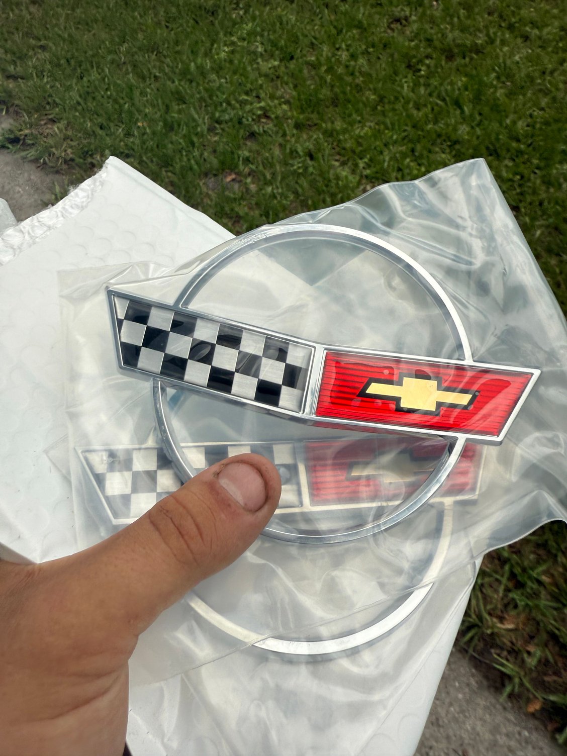

I called around and a decent shop quoted the job at 450 bucks, so I took her there today after work. Hopefully I’ll be driving her home and putting these new badges on
