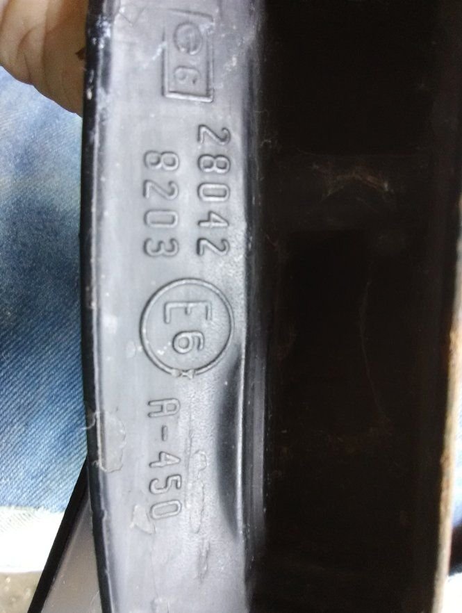

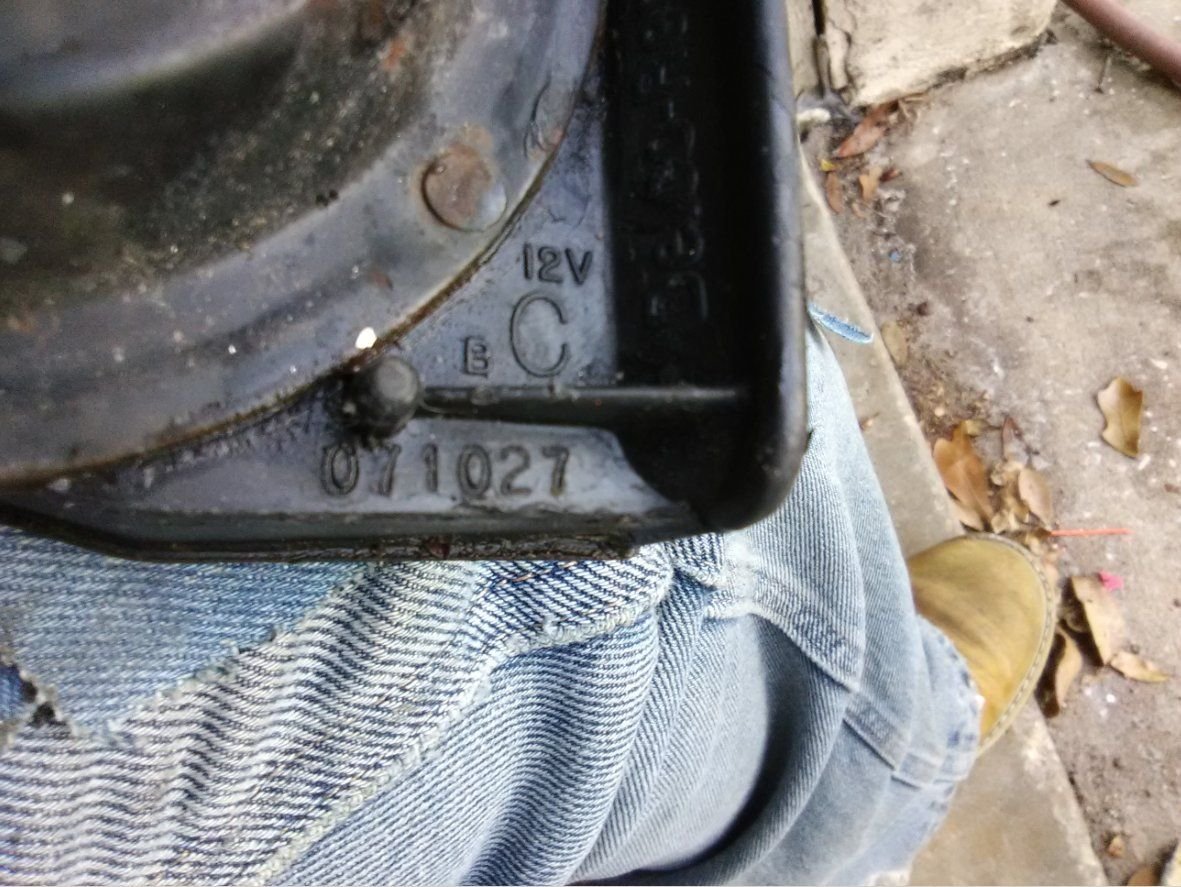

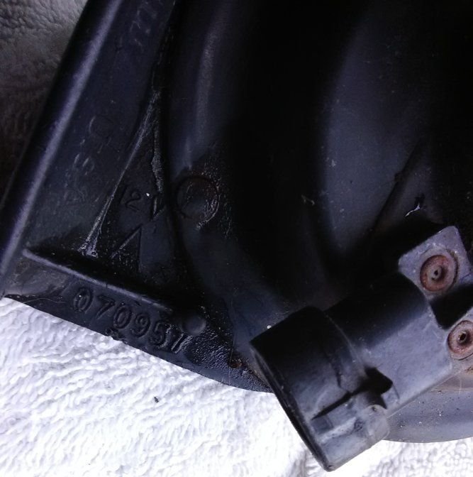

Update -
Pulled both horns a while ago.....Applied 12vdc to BOTH horns individually and"
1)...Passenger side FAILED...I heard something but, just isn't cutting it....
Since it is shot, I may just apply some PB Blaster down the horn to see what happens...
2)...Drivers side passed...
BIG "A" IMPRINT WRITTEN ON ONE HORN.
# 070057 ON HORN
OTHER NUMBERS ARE:
A LARGE "E"
"A-450" IS TONE I READ SOMEPLACE........
28042
8203

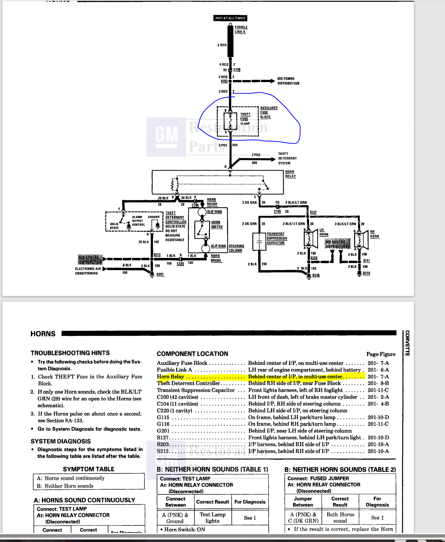

NOW THAT I HAVE SOME QUIET AROUND HERE, I PRESSED THE HORN BUTTON AND DID NOT HEAR A CLICK OF THE RELAY...
IF I REMEMBER, THE HORN RELAY IS BEHIND THE CENTER TELL-TAIL AND SO IS THE FUSE...(AM I CORRECT)?

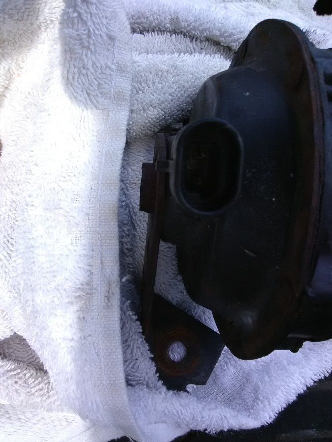

Passenger side I believe:
Drivers' side I believe:
If the relay and fuse are behind the dash, I am done for the day as it is clouding up quickly...
QUESTION:

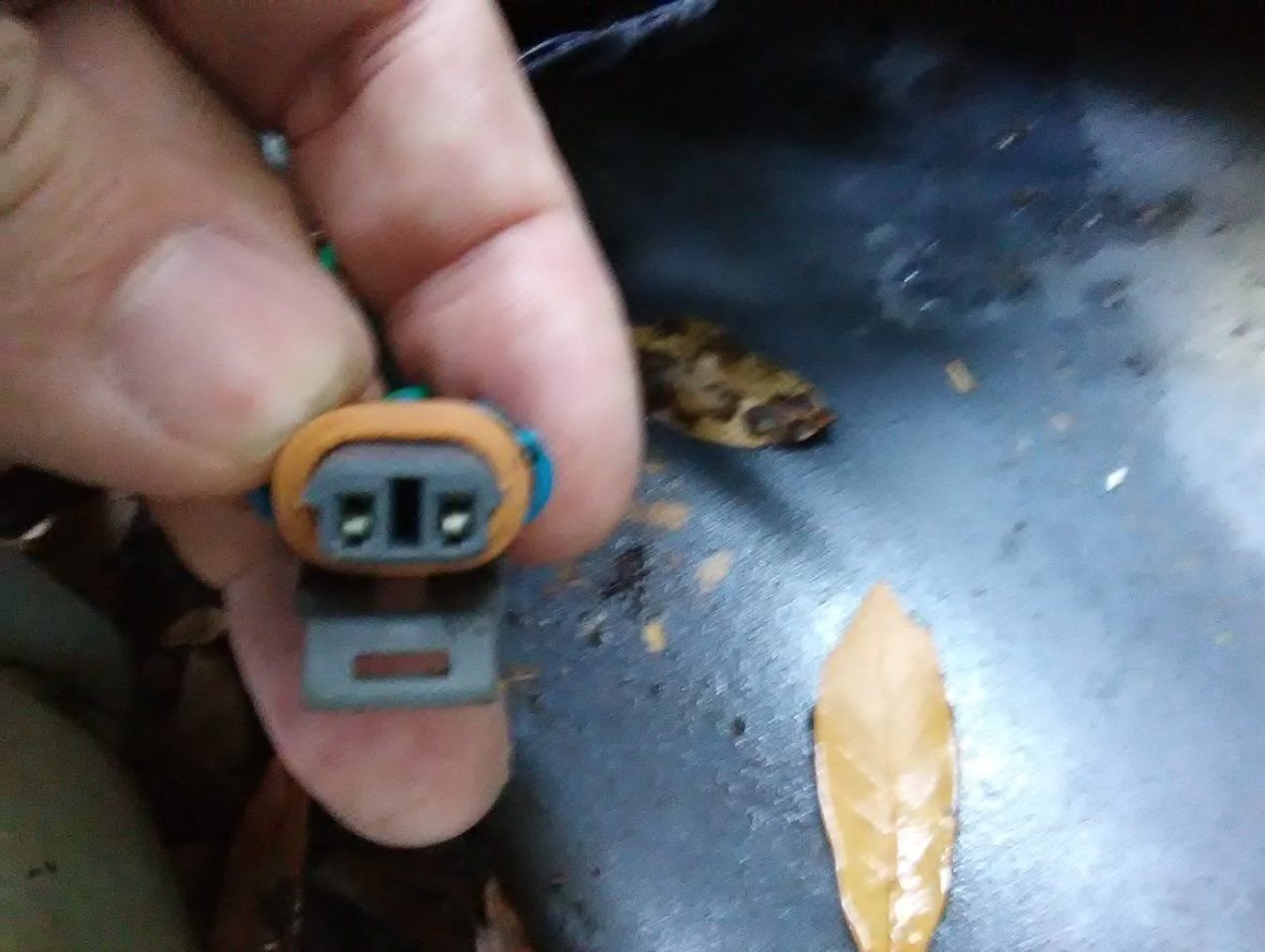

Notice the female horn plug...Is there a female to this plug that could be purchased?

The connector in your hand is 'female' gender is determined by the terminal NOT the shell. Do you actually want a mating connector or just correct horn connectors?
The connector to the horn is GM# 12116958 ACD PT419 or an equivalent from anyone. GM replacement for that connector through the years would be 15306302 PT1357 or 19368034 PT3910. Newer numbers are generally more expensive.
Most any 'local' auto parts store should have or if you're a Bezos buyer they should have also.

HAHAH...I had so much sweat in my eyes and borderline "over-heating" that I got 'em reversed...EMBARRASSED! ....Good save!

You gave me the part number for the FEMALE" and is correct...Would you happen to have a part number that this would insert into?

I would image that these days you would have to source the 'male terminal' connector that is riveted to the horn body you would need to reach out to a shop that reconditions horns. If you did well with your reconditioning effort maybe you just do some junk yard buying.
