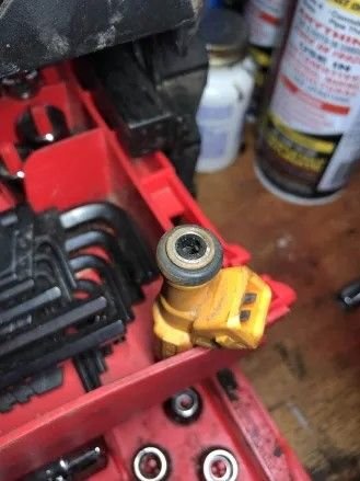

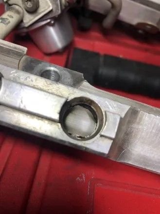

About September or October is when this began, with the same symptoms I'm having now but MUCH more violent. It happened very suddenly too. Bad miss at moderate load, goes away under heavy load, not present at idle or in neutral. The car jerked and bucked so much it was basically undriveable. I eventually found out that the fuel rail was full of debris and the injectors were visibly clogged. That is when I replaced the injectors. (as well as filter and sock, and cleaned the fuel lines). When I assembled with new injectors, the problem was still present (though not as severe). This is when I made the original post.
So, the main idea is, the problem began without me doing anything. It began missing while I was driving the car, I didn't replace or "fix" anything until after it began.
I think I can pretty safely say that the original problem was caused by clogged injectors. I will attach photos I took of the state I found the rail and injectors in. Keep in mind the pictured injectors are NOT on the car anymore.
At this time there is no visible debris in any injectors or the rail, although when I was replacing the filter the other day I did notice the line leaving the filter seemed to still be dirty.
