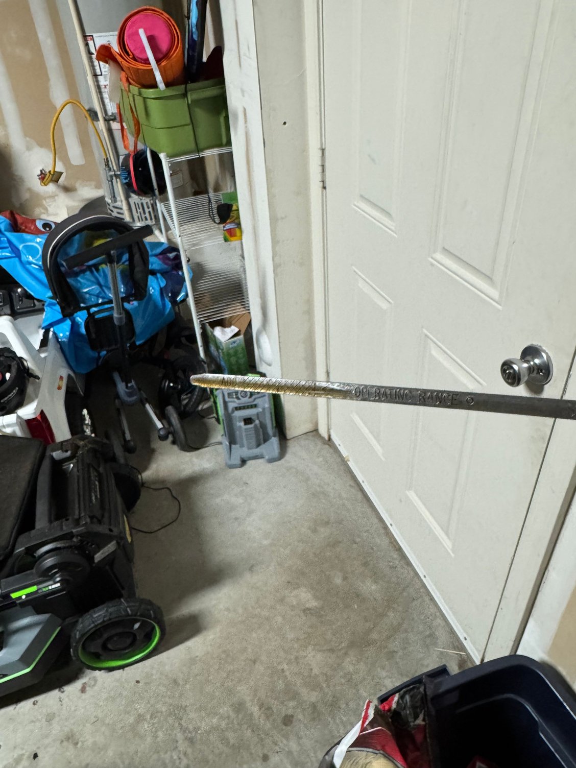

I also just checked the oil and saw that while cold, the oil level is pretty high above operating range which might be causing the starting issue. My assumption is that when oil heats, it retracts and therefore the pressure would decrease which is why the engine would start up fine while warm.

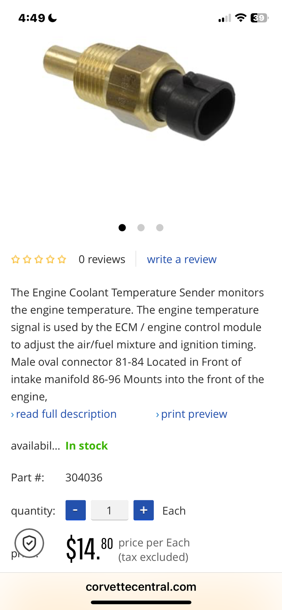

Which temp sensor would this be/where can I find it? The only one I am tracking is the coolant temp sensor. Is that possibly what I need to replace?
It is at the front of intake manifold.
It could cause hard start even without setting code, but you need a scan tool to see what the ECM sees.
It is a cheap part, so swapping it won’t hurt the bank.

Replaced the coolant temp sensor today and noticed after that the coolant reservoir had very little coolant. Filled that up and will see if that’ll help after it runs for a little while.
