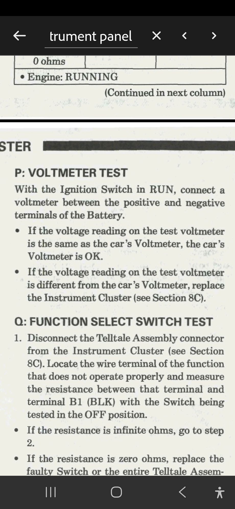

Somebody correct me if im wrong here.... but I feel I remember reading that the voltage displayed is a calculation/comparison between the input voltage from the car's battery and the voltage output from the instrument cluster's power supply. If my memory is correct, then your ICs power supply is dying.

The FSM isnt a ton of help....
