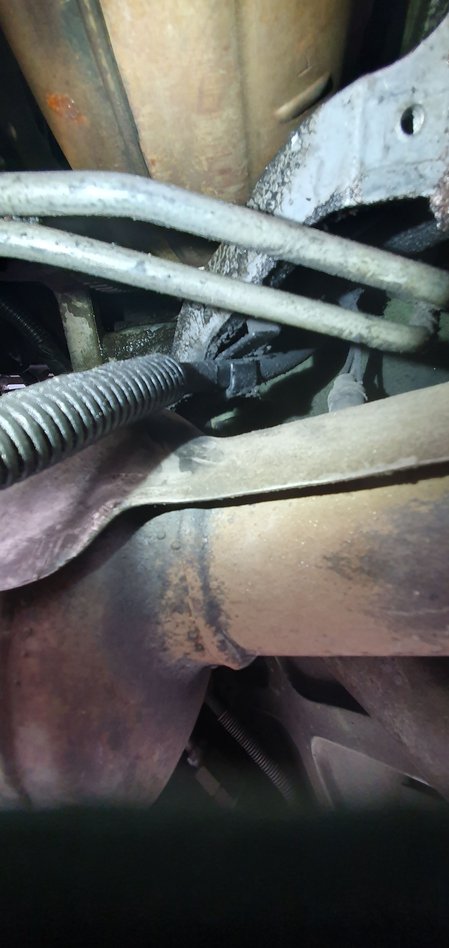

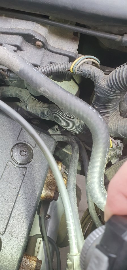

In the first picture here you might just see the first bracket, close to the rear side of the left cylinder head
And here is the bottom bracket, close to the righthabd cat, on the transmission casing

Stop by and visit this thread and ask him for thoughts replacing positive cable. His project is a 1995 but it will be the same and he understands. I'm quite sure he would agree with my suggestion for a custom fabricated cable for your install.
