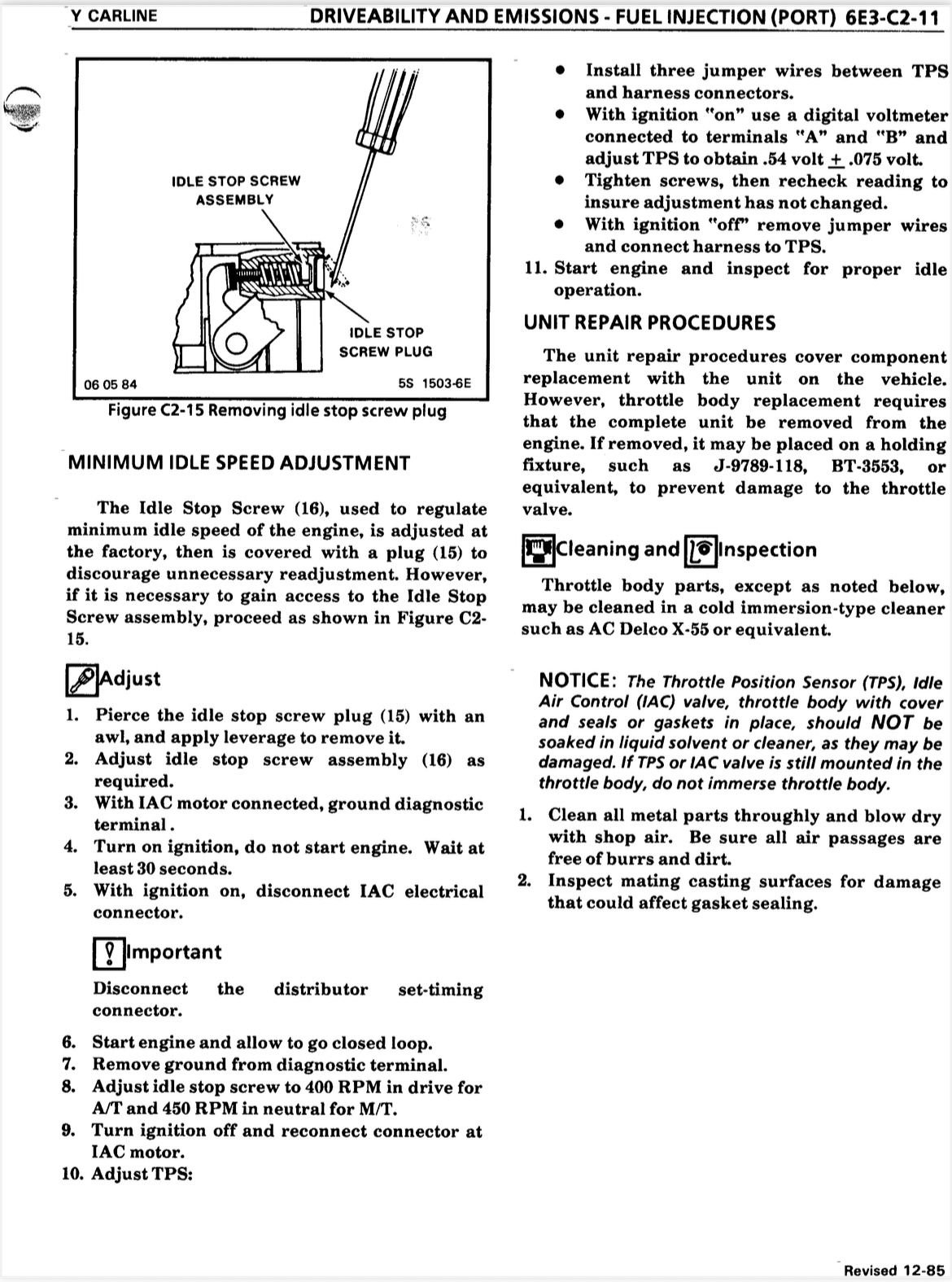

If you’re messing with idle screw, you need to reset your throttle position sensor.
Follow the flow chart and set your minimum idle and TPS voltage.

Ah, ok. Strange thing is there was no cap on the screw. I will see how the car runs. Today I noticed metal clunk from rear, diff I guess, when start to accelerate after braking with engine. So this seems like more important right now.
Edit: Also I see I should set 450rpm for idle this seems really low.
450 is base idle with no input from idle air control valve.
When the IAC valve is reconnected, the ECM will use it to maintain target idle around 700.
