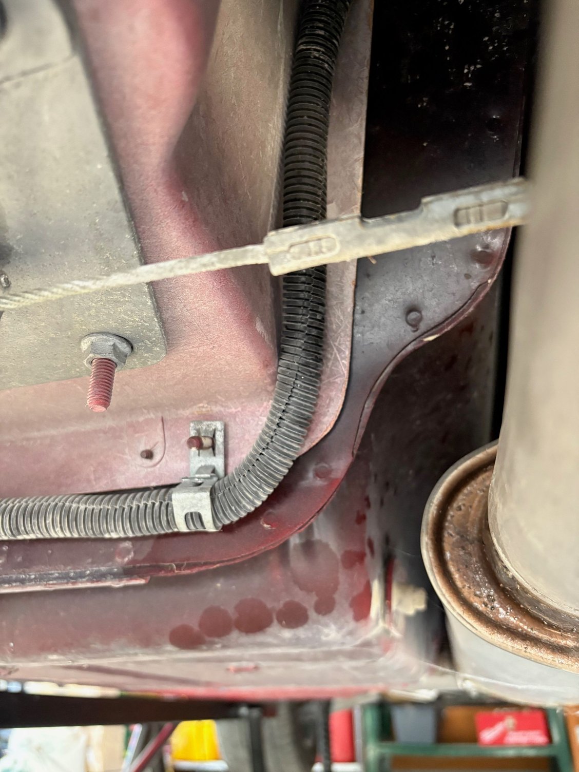

Here is my pinch weld before any bending/grinding. Dan

One of the reasons I wanted to try the "bending" first is because, you can see, I have a spot weld out close to what needs to be ground off. I believe these were done by hand and not machine. Dan
