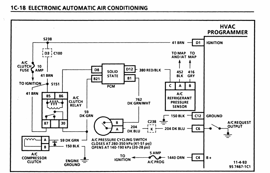

Can not find the correct part. All sensors I locate are a 3 pin configuration. Mine is a 2 pin. Tried searching all C4s. Even checked some C5s but no luck - all 3 pins. Any help locating a 2 pin sensor will be appreciated. Thanks Bob

Which device are you looking for? In your search, are you using the part number or just a description because there is a difference between a sensor and a switch. A sensor gives varying output - a switch (2 terminal) is a discreet device - open or closed.

GM# 52468323, ACD# 15-5705 or 4Seasons# 36659 OR any equivalent to those should be a 2 terminal for
94+

Do not have a part number searching on pressure sensor. And looking for a 2 pin. What I think is the sensor is located where it is suppose to and looks identical to all images. Even found a video on how to replace and sensor used had 2 pins. Located the switch and it is where it is suppose to be. Hope this helps.

Parts are the switch not the sensor. Thanks. Bob
