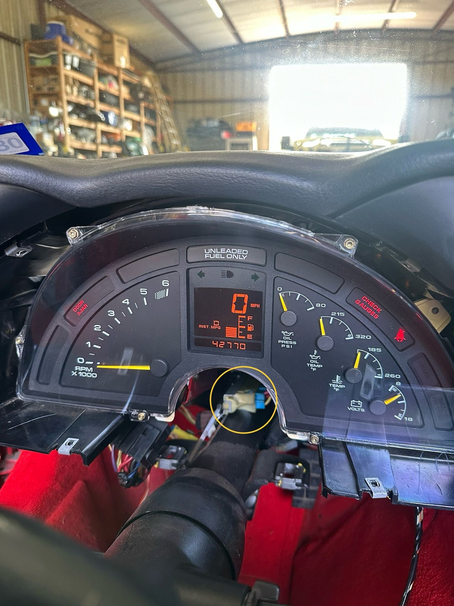

I love the inverted color on the LCD, did mine too and ts the best upgrade ever!
