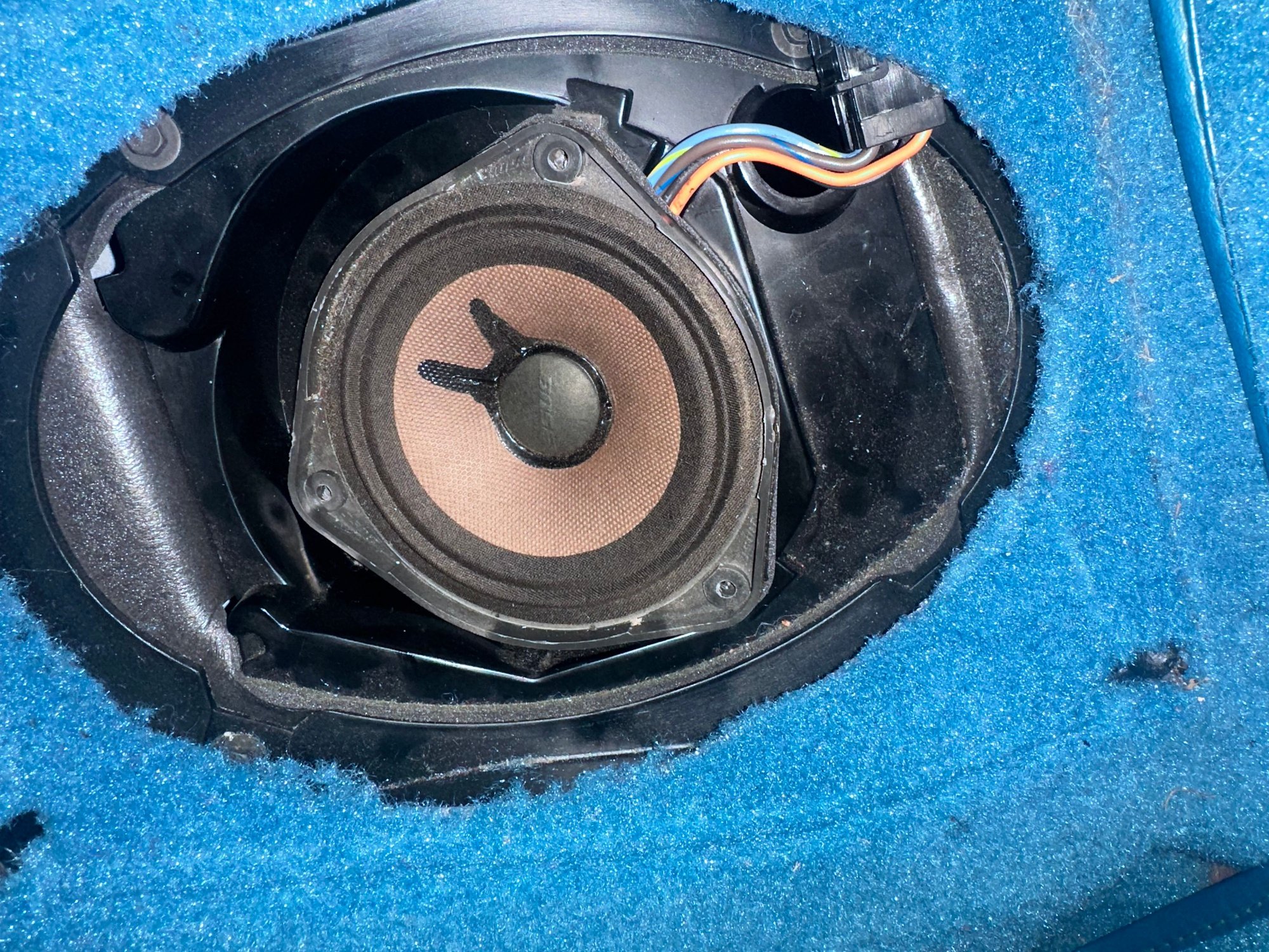

this is what I am looking at. I just purchased the car and previous owner said it was an amp issue but I wanted to look into it more (1989 6 speed manual z51). If I unplug that speaker would I need to do anything else or is that enough to test if this is the bad speaker?

looks like a bose speaker but not a bose speaker enclosure
oh. Did not know that. Is there a way you can tell?
looks like a bose speaker but not a bose speaker enclosure.
Try wiggling radio ***** to see if you can make the speakers sound staticky
you can also swap speaker to the side that has no static

First thing to do is look for the amp for that speaker. As others have said,, it looks like the Bose speaker but it isn't attached to the normal enclosure. that the amp is normally attached to. Pull the speaker out and see what else is in that cavity.

Remove the 3 screws holding the speaker and pull it off the enclosure. You'll have two quick connecters on the back of each speaker. Tedious but not hard. You could disconnect 3 speakers at a time and just cycle through them until you find your culprit.
When you do - id recommend doing the amp rebuild yourself, if you have a soldering iron. Capacitors are cheap and takes maybe 45min per amp.
the amp is in there just hard to get to unless I take out the entire housing. From what I understand is that plug is what connects the speaker to the amp, and the amp is plugged into the wiring harness. So if I unplug that plug shown in photo then the amp and speaker will be disconnected. If I start the car and turn on the radio (when that’s unplugged) will test to see if that speaker/amp setup is the problem. If the music is clear when unplugged. Thoughts?
yes when I took the 3 out I was able to grab the speaker and take it out of that enclosure. The amp is a little harder to get to but yes I would be able to disconnect those connection but the question for you is do I have to do both? Or could I just unplug the main plug in photo since that’s the amp plugging into the speaker. Or should I do both?
Didn’t even see that connector hiding. Yes, you can just do that one.
When I did mine a few months back, I had 1 that was horribly static but the others (when isolated) were meh too…ended up refreshing all. Amp should be screwed to the enclosure in some form or fashion. Isn’t a hard job just a little tedious with the board “glue” around the capacitors.
