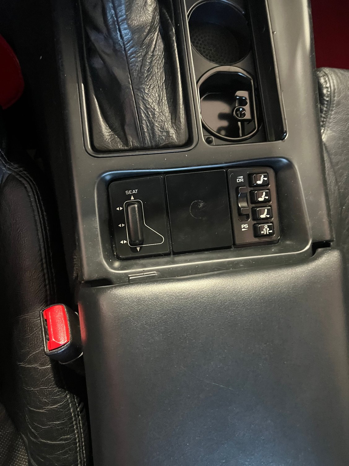

When say a bad switch, it is the one on the left of the console. The right switch merely controls which seat is being operated, and since BOTH front seats are not moving fore/aft, then I believe the actual seat control switch is broken.

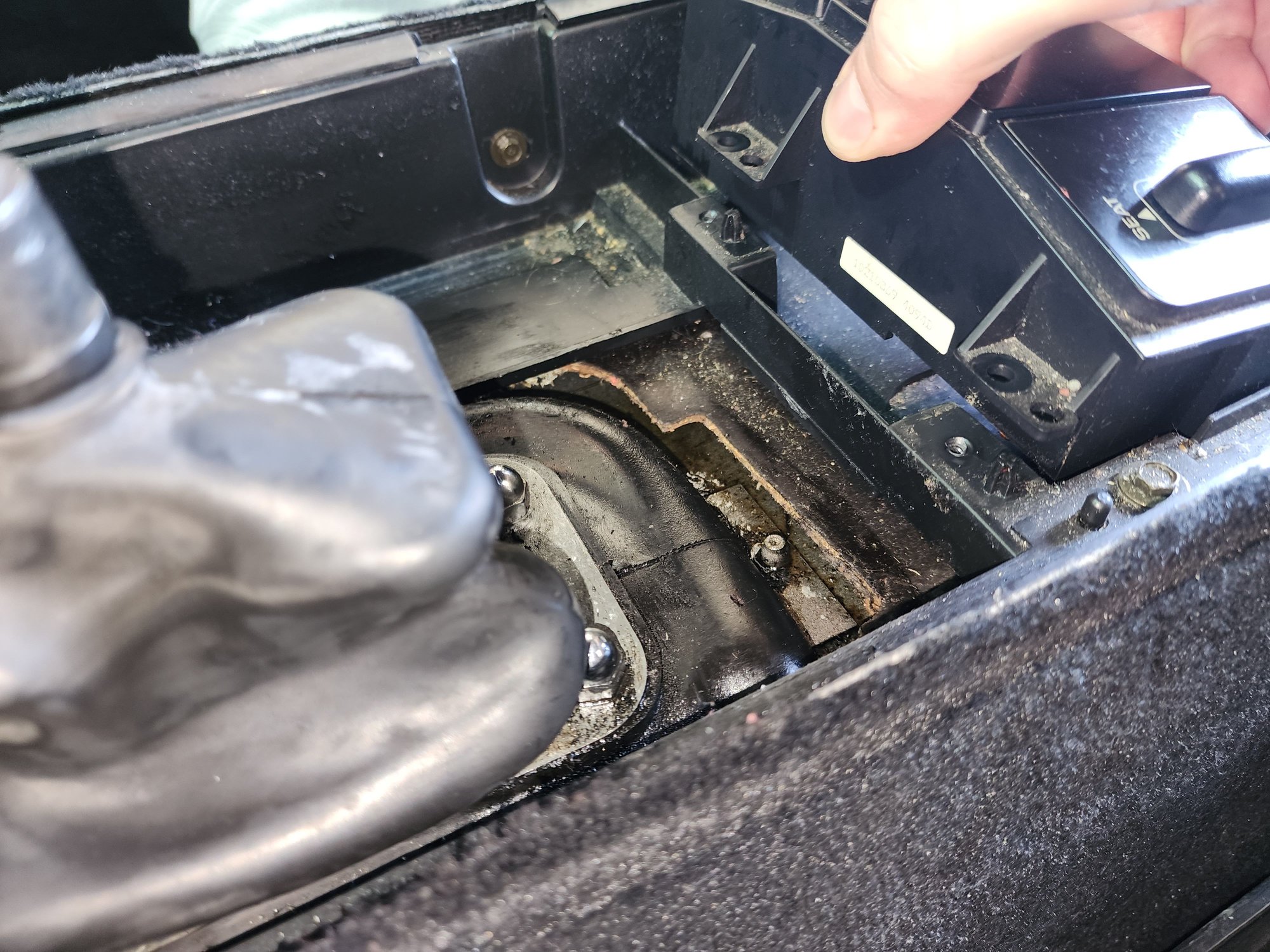

Thanks. That’s good advice. I took everything apart. I’ll lube the track and get that tool to check. I think it’s the switch since the selector for driver passenger works and all the other lumbar buttons work. I’m having trouble finding the part. I’ll check this sites you listed. Thanks again!

I've got a '94 with base model power seats, and the driver seat was iffy to move forward (had to play with the switch just right, but once moving it worked fine, and no problem making it go back), but now, not able to get it to go forward. With my one of my sons being significantly shorter than me, and needing to reach the clutch properly, I want to get it working reliably again. I'm suspecting the switch, based on the behavior. In my case, there's a similar switch on both sides (and from seeing a picture of the underside, it looks like the PCBs underneath are exactly the same), so I was initially thinking of using the insides of the passenger switch on the driver side, since I don't care if the passenger seat can move forward anymore.. but, I found a passenger side switch online, so instead, I can leave my passenger seat alone and functional, and use parts from the purchased one.
Not sure 02z06tr could use a passenger switch as well? (I believe there were others on eBay, passenger sides likely gets less use)
I'm wondering if anyone has pointers for getting that switch out of the console so I can play with it (at first I was also wondering about fixing what appears to be a faulty contact for moving forward)

thanks. I got it apart but I didn’t get it all the way out. The wires are tight. I’ll work on it and send some pics. I bought this tool as recommended above by Bogus, I’ll have to figure out how it works but he said I could complete the circuit essentially bypass the switch and see if the seat moves. If so I’ll know I need a switch. Using a passenger switch is a good idea as there are no drivers side ones anywhere that I can find. I’ll be going Corvettes at Carlisle in couple weeks and I’ll be looking for one there. Thanks for all the good advice!

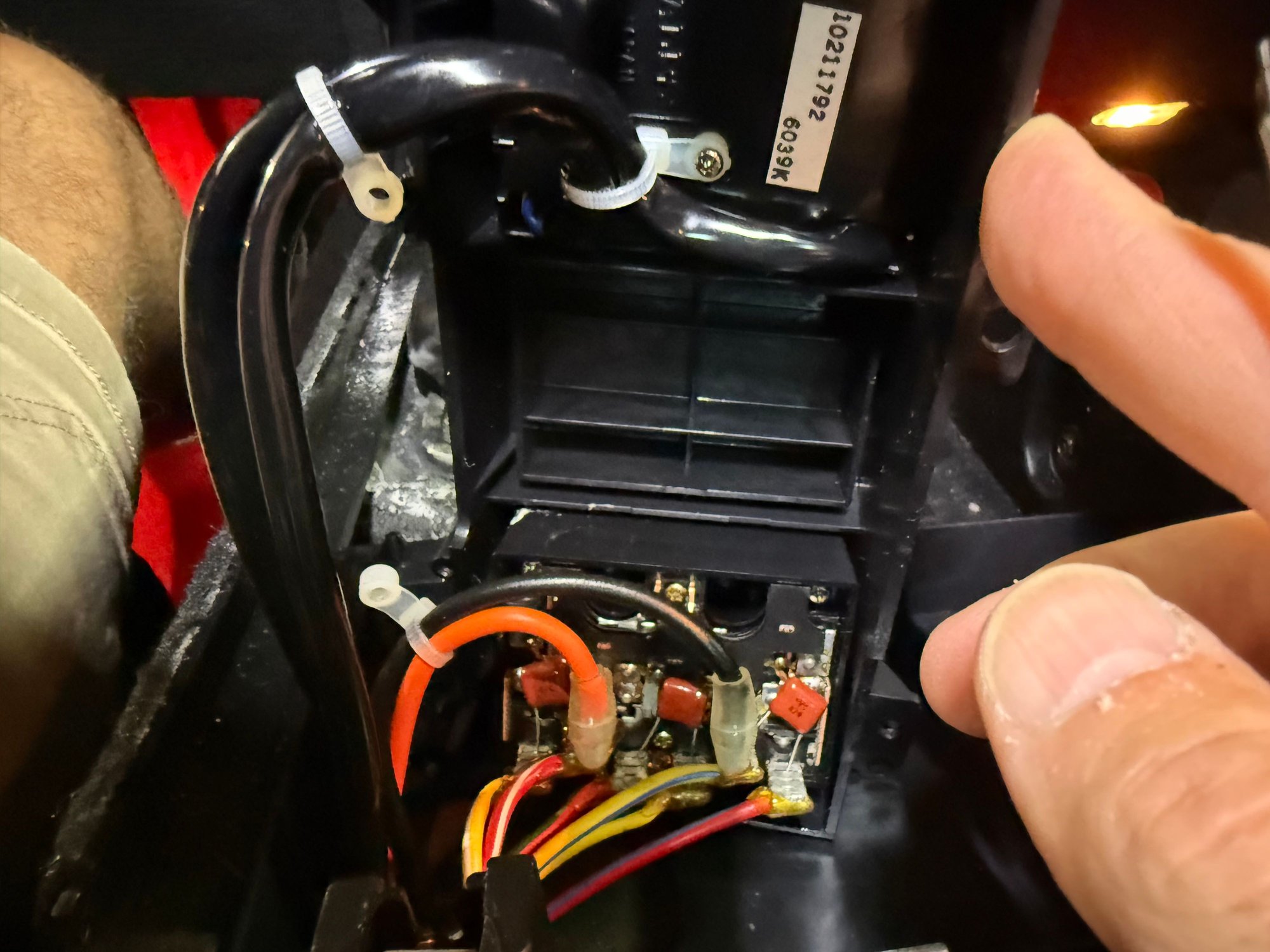

I got it this far out. I’m not sure what to do next? How do I bypass the switch to see if the seat moves? If I find a replacement switch I’ll have to dig deeper into how to get this all the way out. I may be in over my head.

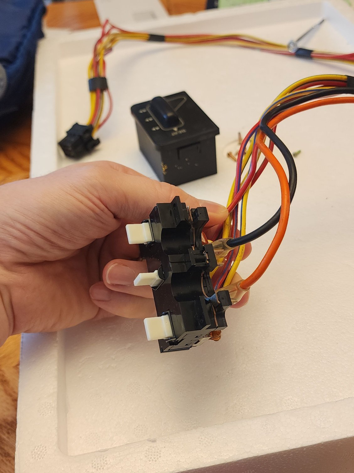

I was starting to open up the replacement, for the passenger side, and the part that I got to seemed factory sealed.. I was hoping to swap out the switch and not have to solder a whole wire bundle.. then something happened with another car and had to get the Vette out of the middle of the 2- car garage... so I just closed it all back up for now.. here's a picture of what's inside the black box.
