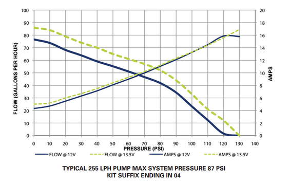

On walbro website it has graphs like these,
No matter what vehicle, I like to size the pump at 12v so we can account for alternator / belt failure in flow pump flow rate capability.
We also need to account for friction in the lines, and I also chop a couple percent off to account for age at the end.
Lets say 60psi fuel pressure at pump, this is prob about 57psi at the engine at wide open throttle on typical 5/16" line systems with factory friction around 400 to 500bhp. I remember that 600rwhp using 5/16" fuel line for decades, the pressure drop is reasonable up to almost 700rwhp on gasoline iirc.
couple ways to do it
its about 50gph at 60psi.
For E10, Take gasoline at 114,000btu/gal
ethanol 76000btu/gal, the mix is around 110,000btu/gal
50 gallons should be (50*110000) 5,500,000btu/hour ?
1hp = 2545btu/hour
We have 2160~ horsepower now(5,500,000/2545),
If we assume 25% of that makes it to the crankshaft then really its only 2161*0.25 = 540bhp.
5,500,000 btu/hr is 1600kW. Lets try another approach
E0 gasoline is 6.17lb/gal so 50gph is 308 lb/hr
With the lb/hr number, we can simply multiply brake specific fuel consumption to get some rough ideas of power from the fuel.
Ex.
308lb/hr/0.60bsfc(lb/hp*hr) = 513bhp apparently
308/0.55bsfc = 560bhp
Natural aspirated engines could be 0.55 or 0.49 something like that, when clean and right.
Running richer, or adding resistance in the form of supercharger crank accessories or turbine spinny wheels all makes BSFC increase, the engine needs more and more fuel to make correspondingly less power per gallon of fuel.
I'd say based on that graph the 255 is in the correct ballpark even at 50 to 60psi with 12.0v.
But is that even the right graph? I don't know why they have several 255 pumps labelled as 255 Walbro when they all flow different at varying pressure. So this is caution like, which walbro 255? there appear to be several kinds. Watch the pressure, flow, model number, it isn't just 255 when at 60psi we get 50gph and 50gallons is 190liters, so its a 190lph pump sometimes, or more or less depending.
