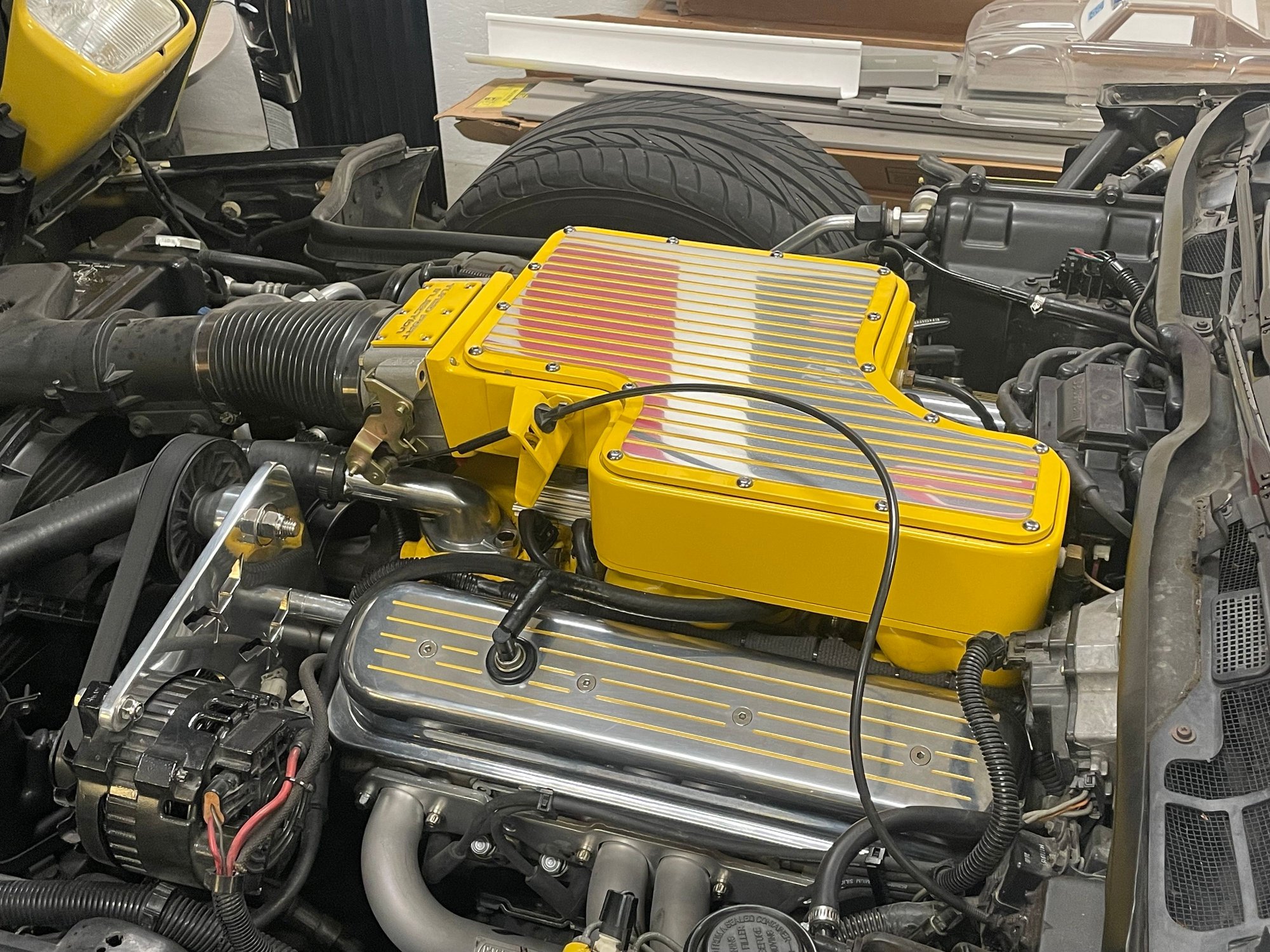

This is the one I bought. I still need to make a bracket to go from the back of the alternator to support it, but it works great. Bit of a pain to assemble, but it works. https://pqyperformance.com/products/...orvette-c4-l98

Looks exactly like mine at a glance.

This is what I made, pretty solid.
I took dimensions back when I made it, if you’re interested, I will dig up my info.

That's very well done. I think I can pull the dims off this bracket I've got, do you happen to have a part number for that pulley?
Do you think this is something that SendCutSend could cut out? Are the dimensions a technical drawing? That would be epic. Yours is clearly stronger than the pile I bought. LOL

That's an excellent idea, the sendcutsend thing. I swear there should be a market for a better one of these, everyone is selling nearly identical versions of that one posted above. I think the pulley and bearing are it's biggest problem
but it's not especially robust or attractive in general.
Looks well designed and strong but I would have done it a bit different.
I assume that you made it to keep the stock belt length but I would have moved the idler pulley down, and possibly used a smaller pulley too. Shorter belts are easy to find.
That would make it less obvious that it is a delete kit and more of a "factory" look..
I agree, it was to use the stock belt. Could have been less conspicuous. 🍺

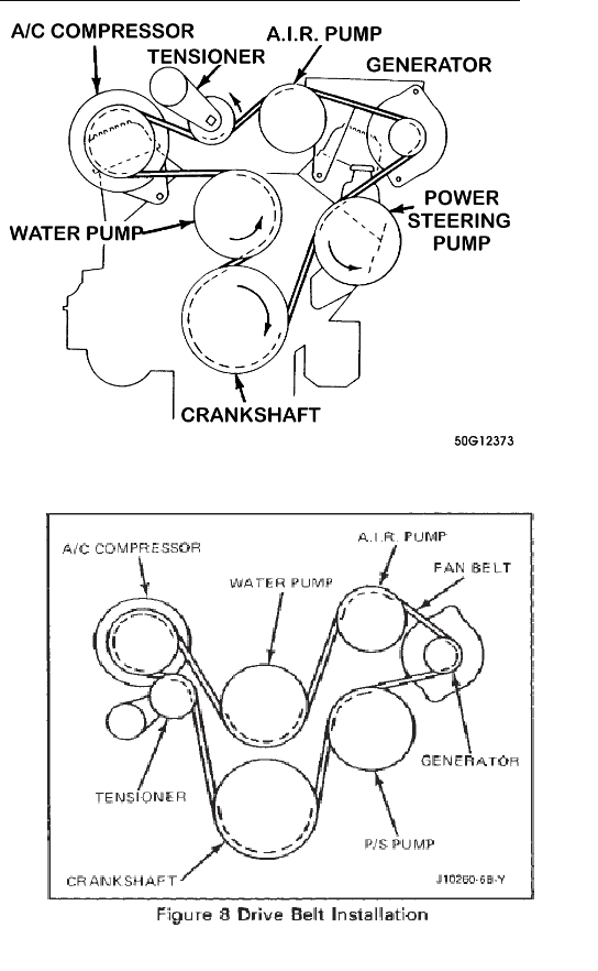

I've only read about this. don't know if it works
84 air pump delete | Corvette Forum - Corvette Action Center
guy put on a 85.5 serpentine on. no pump no pulley
To Anyone else hate smog pump bypass kits?

1984 belt routing (top) is different from 1985 up.
