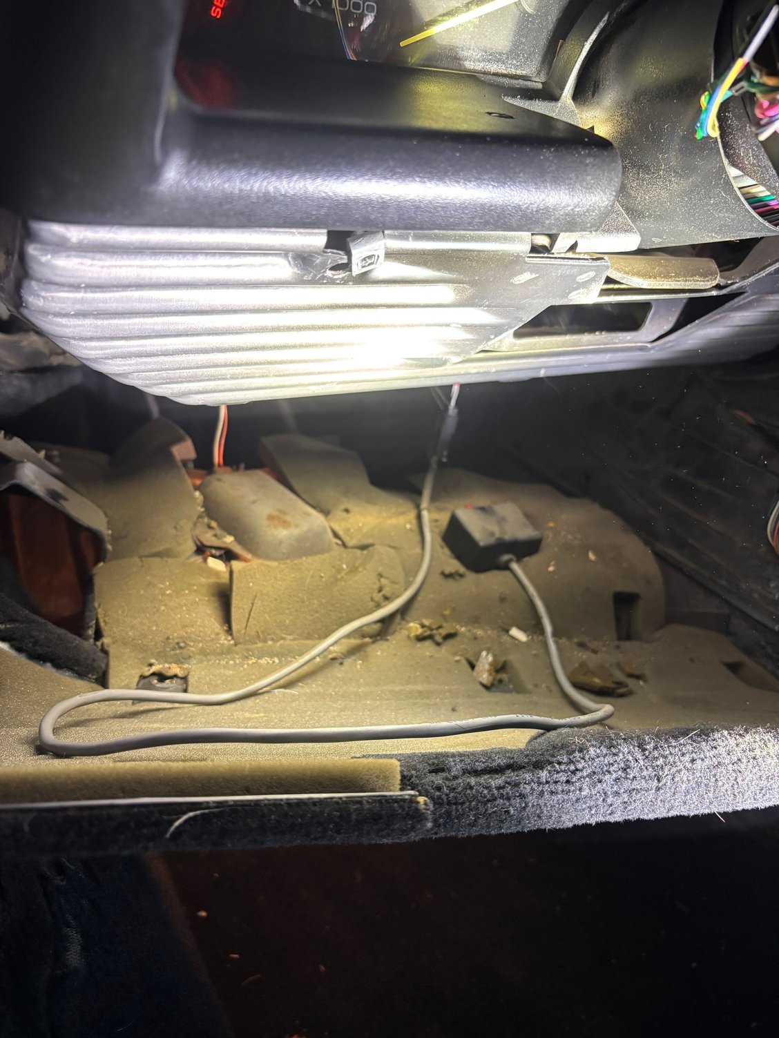

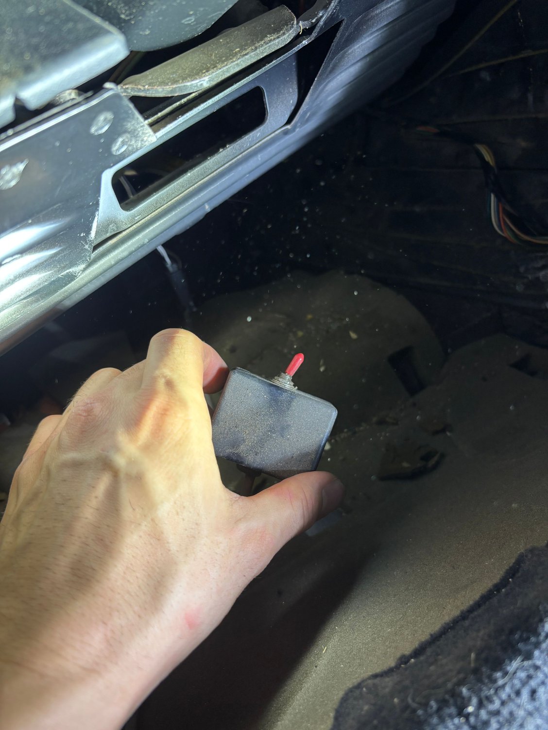

Okay so I made an interesting find under my driver side panel. I took a picture to see if you have any clue. Aftermarket bypass maybe?

Originally Posted by IHBD
The smoking-gun sign of a problem with the bypass is if the SECURITY light is solid-ON when the key is in RUN. (Not flashing with the door open, and the key OFF.) It should also set Code 51 in Module 1. I don't think you have a bypass problem.
I read your opening post. You swapped a couple of connectors. I would go back and double-check that all the connectors are in their correct positions. Check wire colors on each side. They generally match.
If you can, take some pictures of the connectors that were connected 'wrong' (even if they're 'right' now) showing the wire colors on both sides, particularly any tan wires. I have FSM for 1995, I'll take a look and try to determine if anything bad could have happened during the mix-up.
NOTE: Reading the Code 41 trouble-shooting chart they test for both "short to ground" and "short to voltage" on circuit 800, but in no case anywhere on the chart do they stipulate "replace ECM / PCM or CCM." So it doesn't look like anything gets damaged by a short to ground or voltage on cir 800. You probably still have an open circuit somewhere on the tan wire cir 800. Recheck the connectors that were disturbed during the heater core work.
