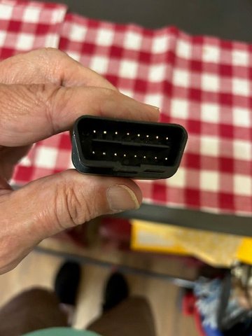

I will start and let run or drive the car in 15-minute or so integrals as you suggest. I'll do it several times. Also, I've tried my best to jump those cavities, and just can't get it done. I'm thinking it may be easier if I had a solid core wire, which I need to go to town and get. If the car starts and runs well, might I still benefit from checking with that diagnostic plug? Thanks again, Doug K.
One thing I did was use a male OBD plug with the 4 and 12 pin connected together so I can just sit in the drivers seat, reach under the dash and plug it in. The male plug was originally for another piece of equipment but worked perfectly to just bend a paperclip to connect the two pins,

I just might look into that. It's so hard to get to the plug, and seems smart to have easier access. Never know when I might need this again.

CorvetteRules, Thanks for the easy access idea. For $6.99 delivered, I've got what I need coming. Thanks very much. Doug K.
