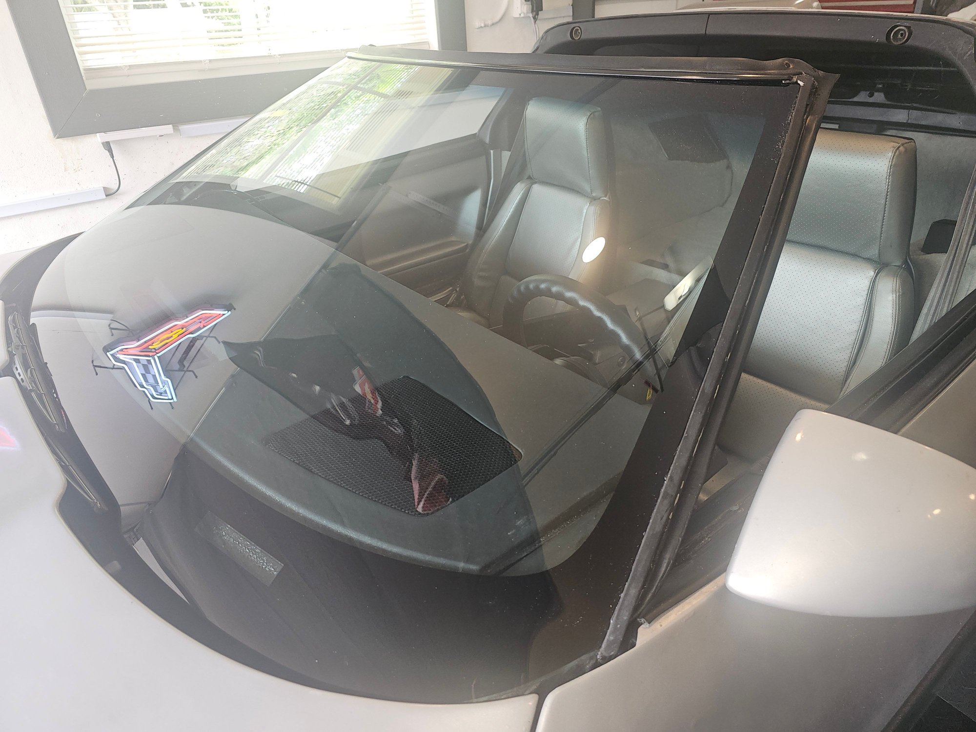

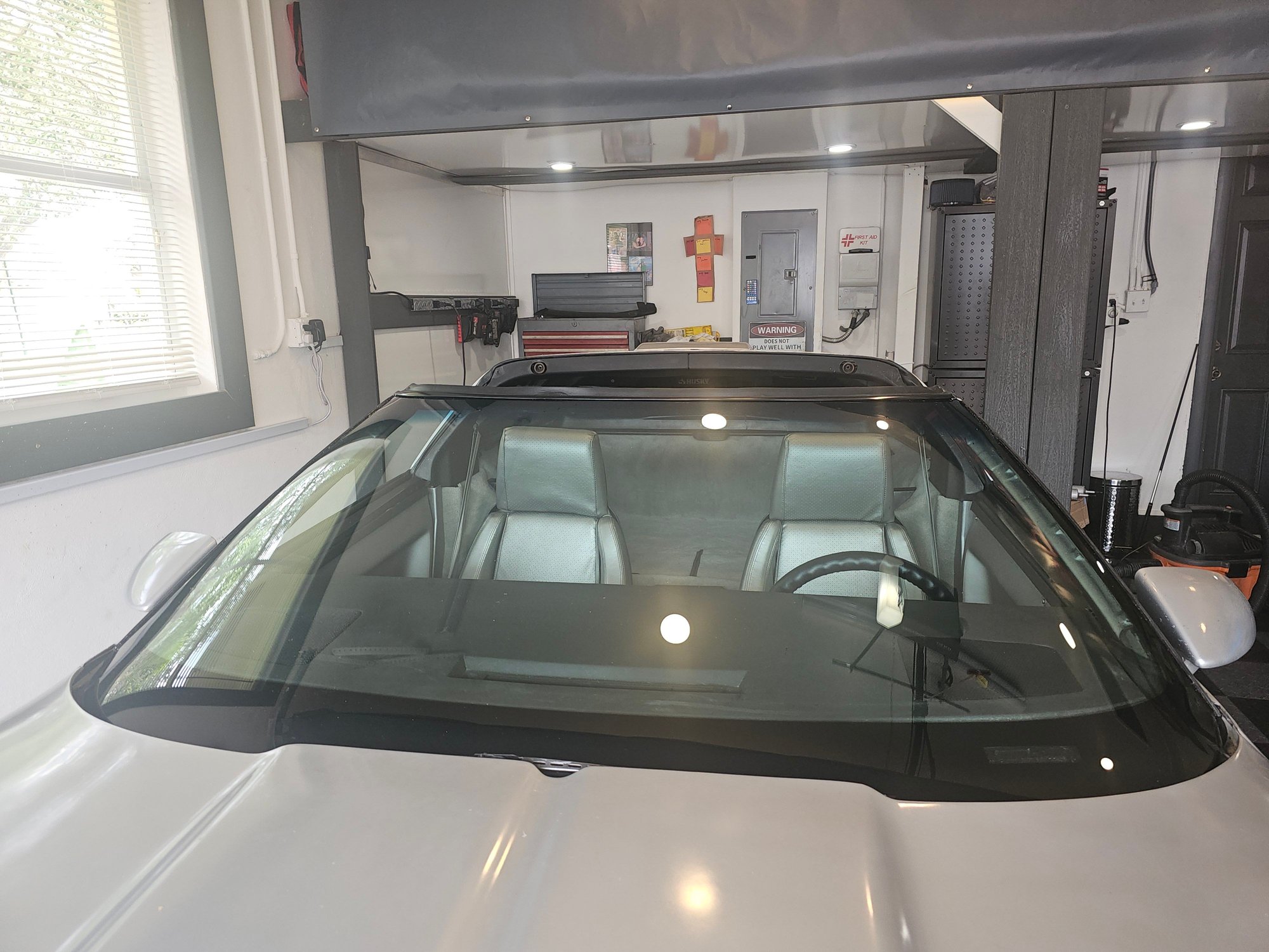

USA AUTOGLASS just came out and replaced my 39 year old windshield. Took 2 hours and cost 722.00 including new trim and weather stripping. Very polite guys and have done many C4 Corvettesin South Florida.
