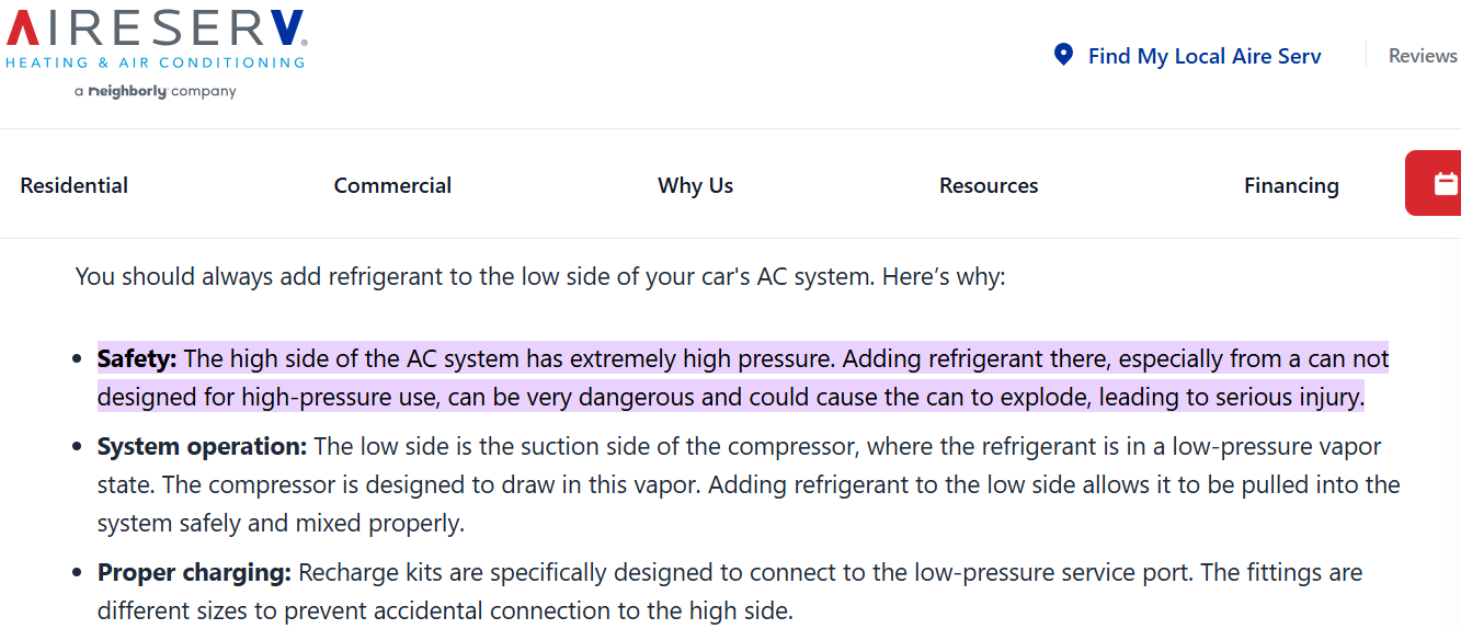

Please!! Stop it!! It is NOT "pretty normal" to fill from both sides. Obviously, you have no formal training in refrigeration. Except for evacuation, you should never have both valves open at the same time. When you do this, you have provided a direct route from the high side to the low side. Since the high pressure port is after the compressor, the higher pressure can force LIQUID refrigerant through to the low side port which is before the compressor. Liquid cannot be compressed. That is the main job of an accumulator - to insure liquid does not reach the compressor. Likewise, you tell him to fill with the can upside down. This feeds 100% liquid and must only be done on the high side. Hard to do that when you have both valves open. 100% liquid also going to low side.

Several auto parts store chains "rent" the gauges and pump.
To A/C Issues

The above is from one of countless sources available.

Iron Mike says "Everyone has a plan until they get punched in the mouth", or in this case have a can of freon explode in your face.
To some servicing your own A/C may seem so simple anyone can do it, but if someone dies or gets gravely injured due to inexperience or just plain idiocy I wouldn't want to be the one who encouraged that person.
i purchased some cans of R12 and a vintage fill hose thinking I could recharge my '84 myself. After reading many posts on this forum, Especially ones that Arbee has participated in, I no longer have any desire to mess with it and just roll the window down. So far so good.
Thanks Arbee! I hope more members listen to your (correct) advice.
