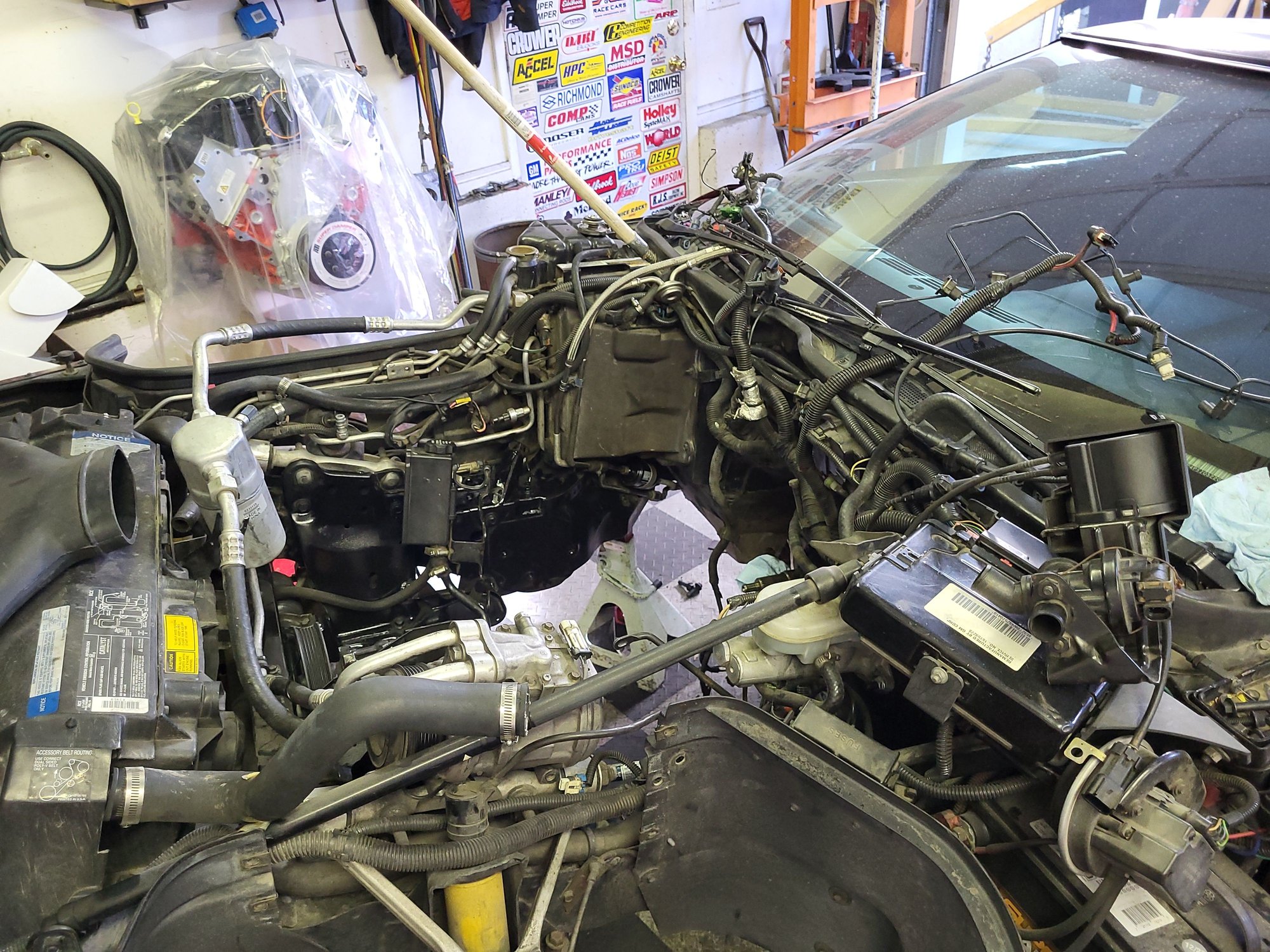

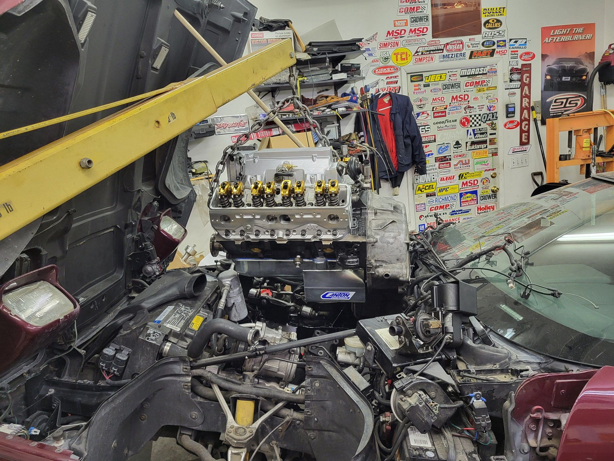

The engine will come out with the hood on and the trans still in the car. Put a jack under the trans to support it and separate between the transand bellhousing. Strip everything you can off the front of the engine to make it as short as possible. But it will come out with the trans and the hood on it. I have done it several times
