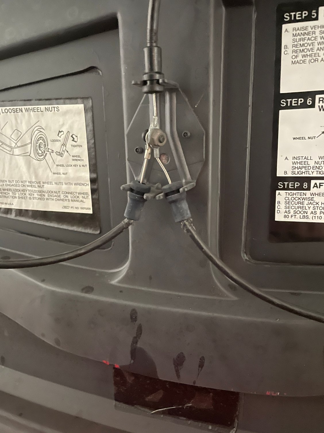

I have the car in th garage the battery is dead and I wanted to remove the convertible top. Does a way exist to do so?? I can release the front latches but I cannot get the rear latches to release for the top to move up nor can I open the deck lid. Any ideas? Thanks.
*******UPDATE*****
I was able to get the deck lid and top open. Seals seems to have fused themselves to the top. Was able to get a plastic body tool btw the seal and the decklid allowing everything to work.

There is a manual lever on drivers side under the deck lid that releases the rear of the top and also cables buried under the carpet at each side that will release the deck lid. You'll have to dig for them.

I have managed to find both cables as well as the handle under the deck lid. Pulling on the cables does not result in the unlatching of the deck lid and the handle is not releasing the pins that attach the hardtop to the deck lid. Is it possible to remove the parts to unjam them if that is a word.

Unsure about the pulling the cables directly but when pulling the manual lever, its basically like a break lever on a bike. Shouldn't have a ton of resistance. Let me see if I can take a picture of the wires from under the lid

Manual lever leads here, located middle/middle of the lid. Video attached shows the mechanism on each side of the lid in order for it to release.
Manual release leads to here. Center of lid.

Try pushing down on the deck lid while pulling on the cable, but you'll have to get the rear of the top released first.

@striker27 look at my video. If the wire isn't working then i'd try to manually lift this black hook, in line with the cable.

Just wanted to let everyone know it was the seal. I found some plastic body tools and inserted the smallest tip the decklid and seal. The decklid popped up! I also was fairly liberal with some
spray on bolt off! The parts are pretty stuff but they are starting to move now.
The top is down and it will need to be replaced. I also need a new front window seal as well. Any thoughts on a good one? Thanks.
