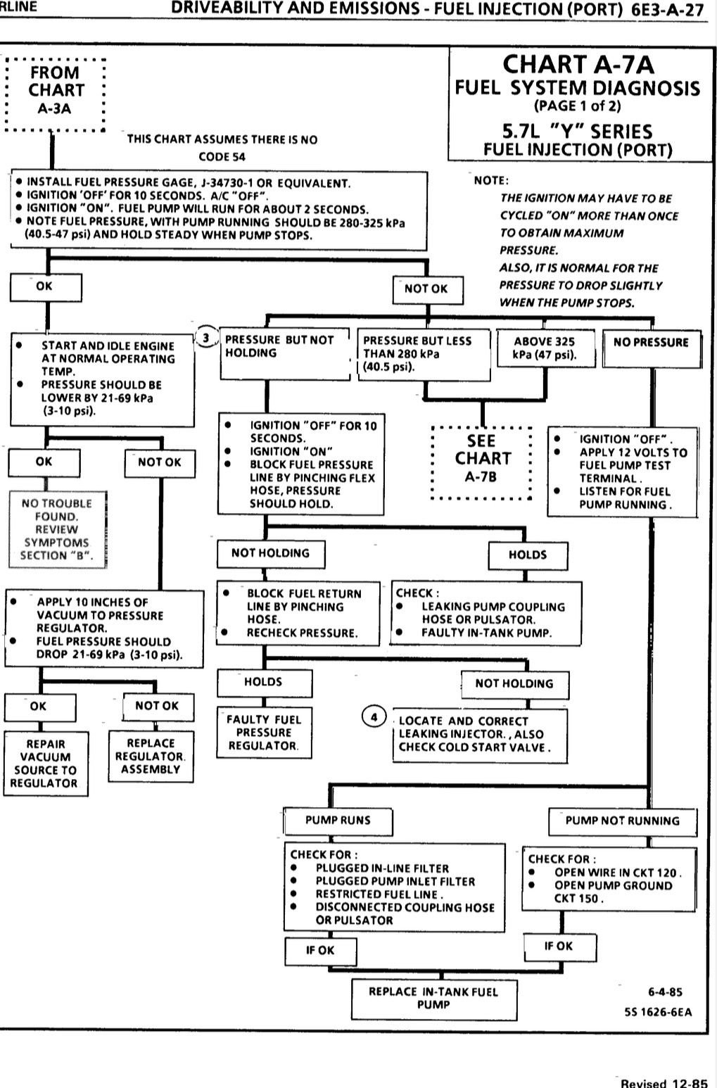

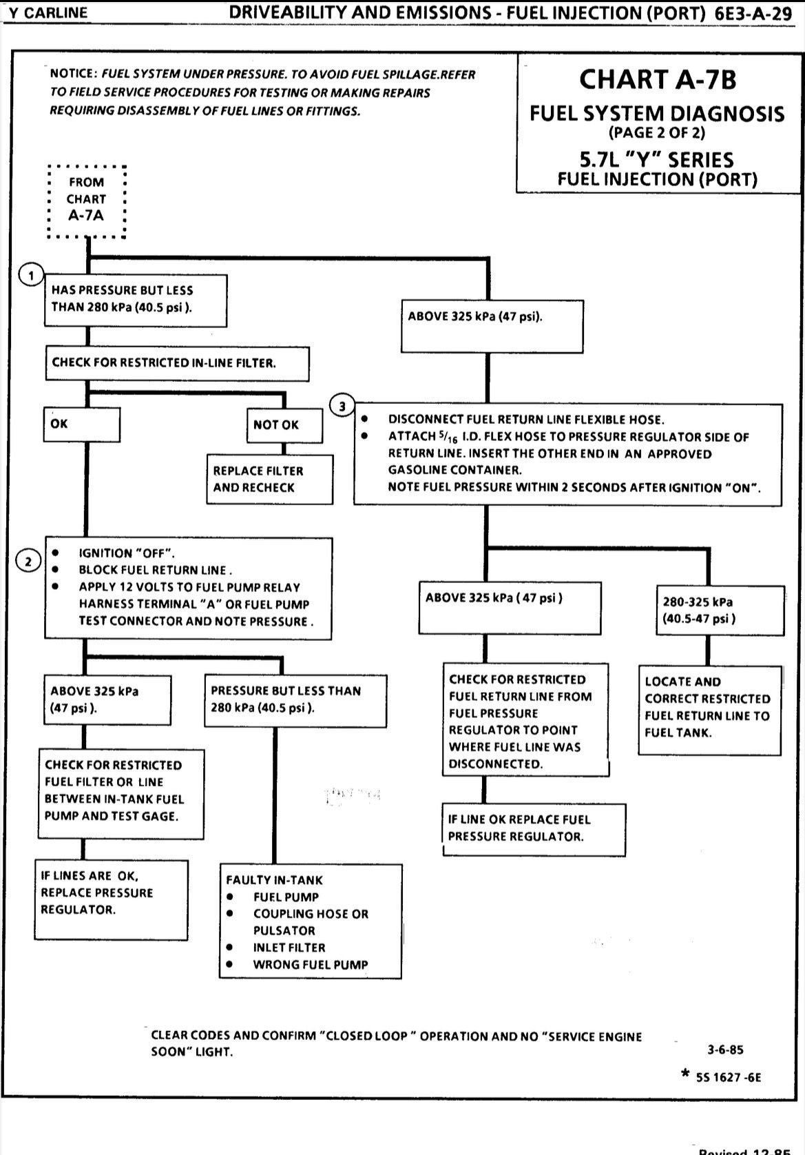

are these flow charts that i'm seeing here from the FSM? think I need one.
yes

Ithought it might be since it happens mostly n the morning but also randomly, confusing on why it would be random, and whitesmoke appears on

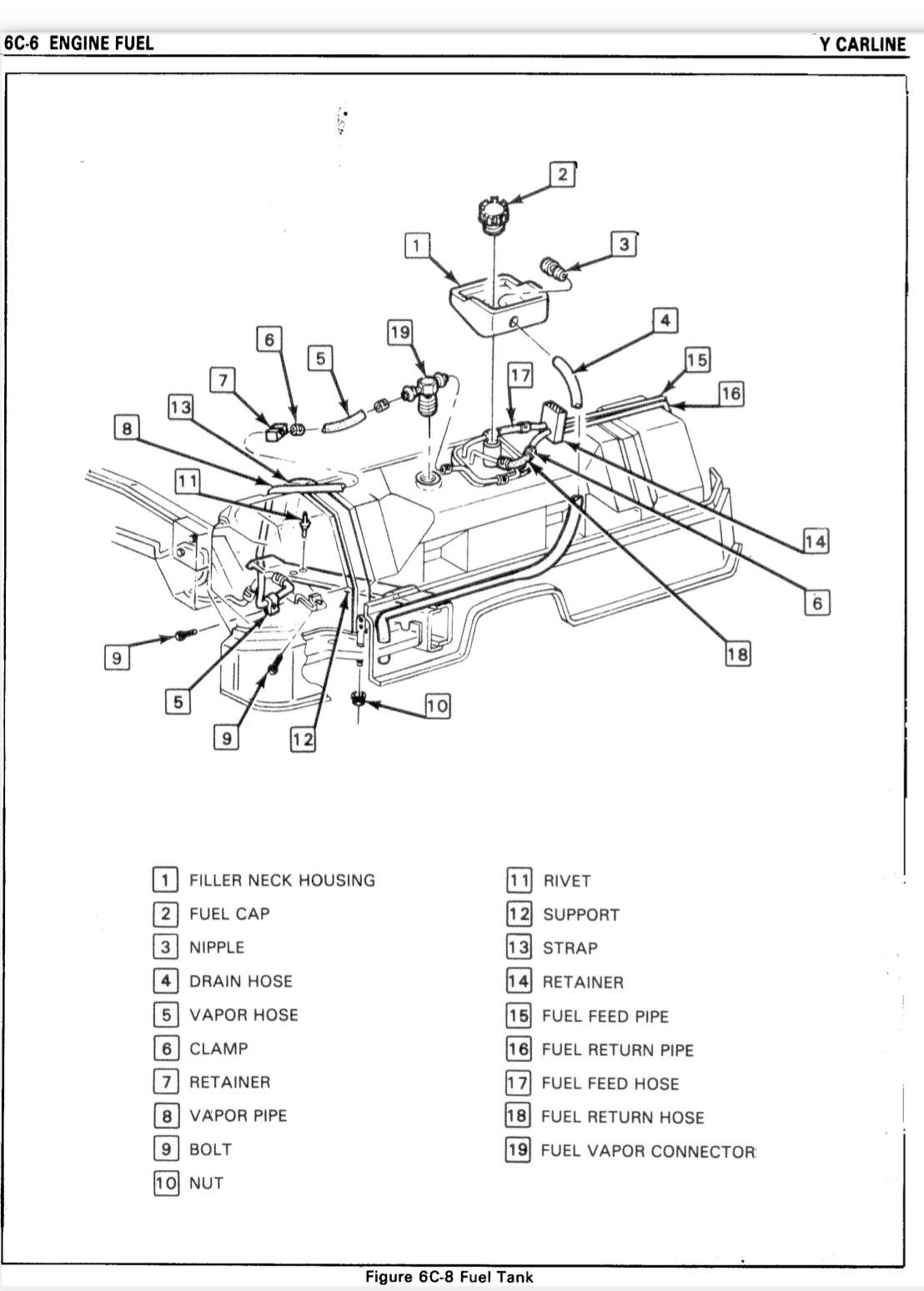

nice thank you for the pics, but for pinching my bad first time what do u mean? Exactly arent the fuel lines metal ?

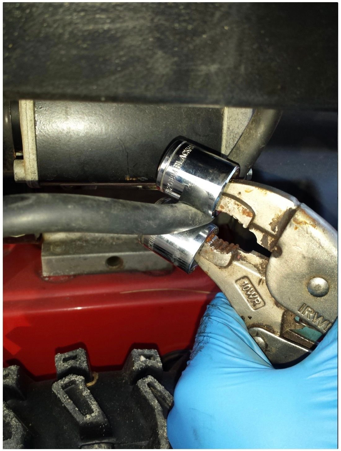

They are rubber at tank connection.
Vice grips with sockets or metal tubing work well.
