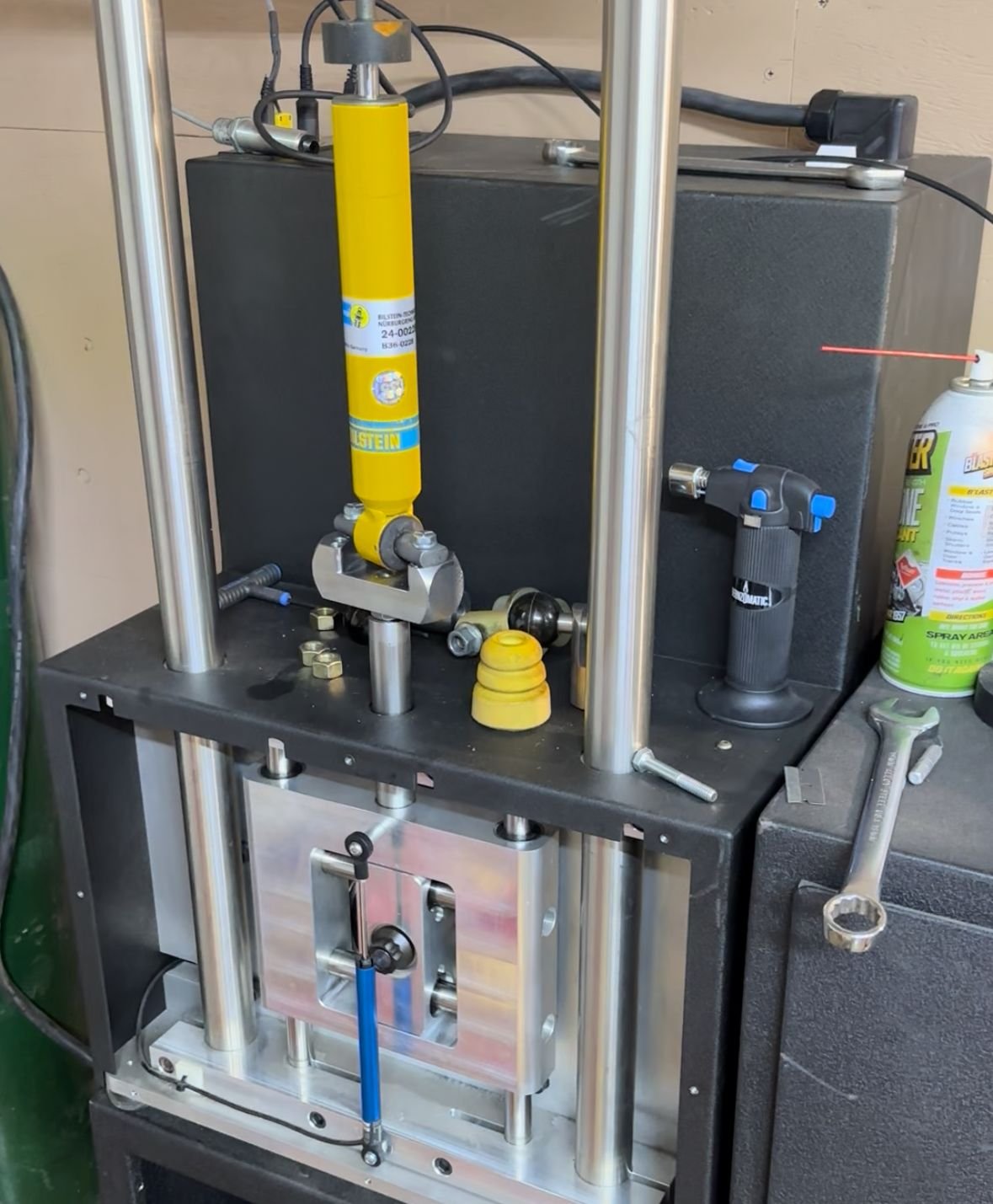

I had the new 1986 Z51 Bilstein fronts on my shock dyno as I thought it worked very well with the OEM 1986 Z51 leafs. Rebound would not control the 1984 Z51 front spring as well, and the compression would feel stiffer.
Best way to go is to get some Viking double or triple adjustable shocks only, and it can get to a coilover for not much money later on. Or Ridetech, they are good quality, but don't necessarily have the coilover acme threads. Or QA1 double adj for a cheap twin tube.
Match the rebound curve to the spring wheel rates as a starting point and most good shocks will come with a force/velocity curves... much easier said than done of course, but that's what I do.
