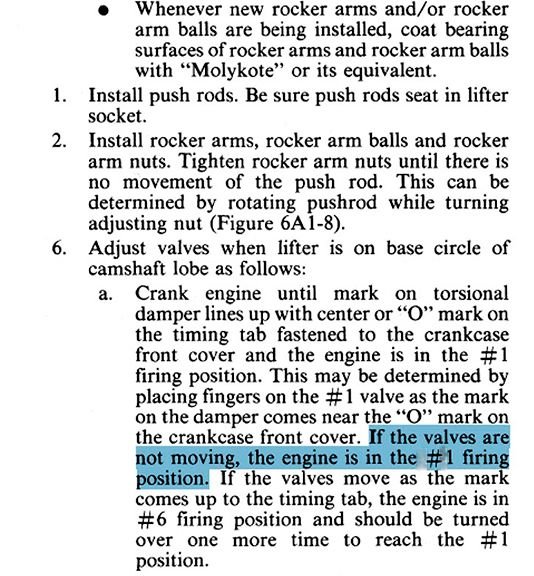

Think this through and make sure everyone is on the same page. I am not a professional mechanic so terminology is important here. AS FAR AS I KNOW, IN MY OPINION,
Top Dead Center is anytime the piston is at the top. This occurs twice per combustion cycle, compression stroke and exhaust stroke. On the Compression stroke (#1 cylinder), which is where we time our L98 engines, NO VALVE IS OPENING. Why would you open a valve just as combustion is occuring ??????
On the exhaust stroke TDC, the exhaust valve is just closing and the intake valve is just opening.
Also, the timing marks line up on both #1 cylinder compression and exhaust TDC's.
When we talk timing, we are talking about TDC on the compression stroke.

When the engine is at TDC on cylinder #1 both valves are closed (The engine is on the start of the power stroke). As the engine starts to rotate the exhaust valve will start to open by BDC.
If you have valves open at TDC you have the engine you are 1 turn off on your firing sequence, rotate the engine 1 full revolution and now both valves should be closed, and you can set your timing.

@ TDC for timing purposes, NONE ON COMPRESSION STROKE !!
