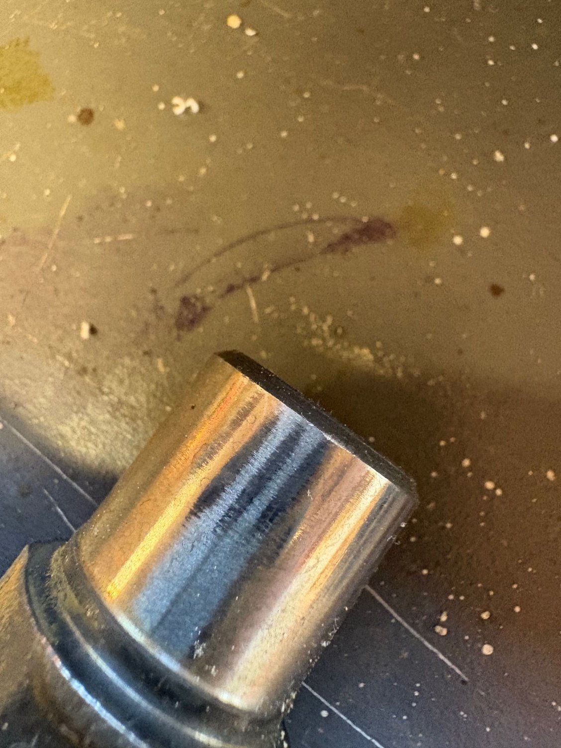

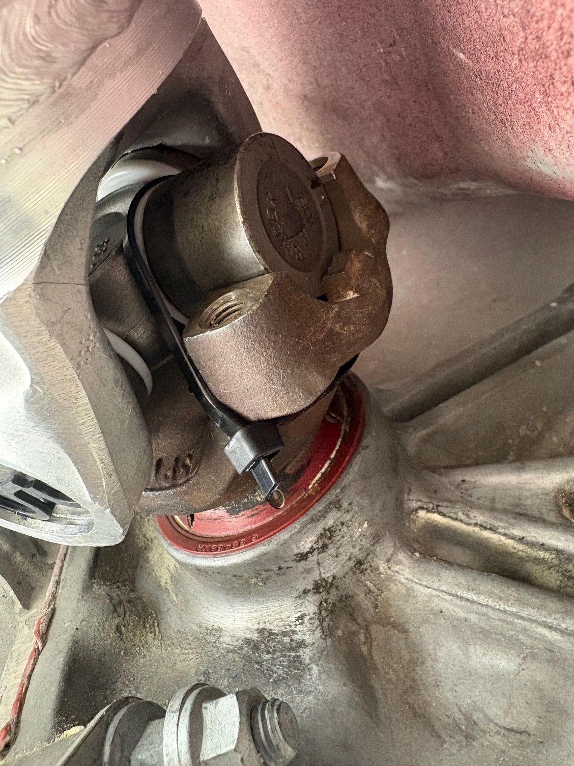

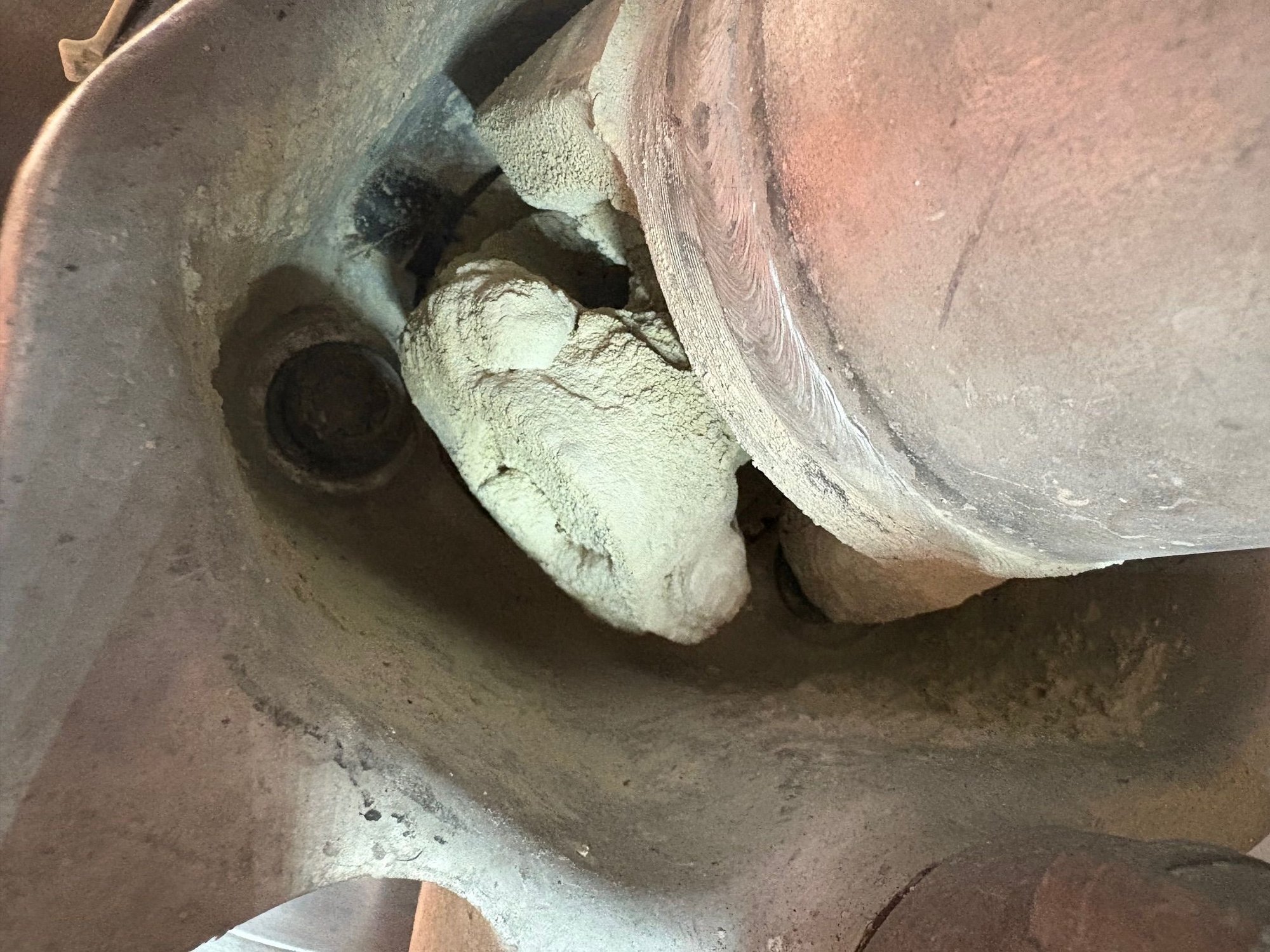

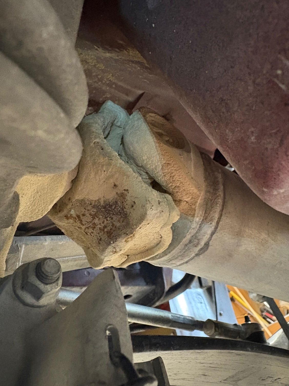

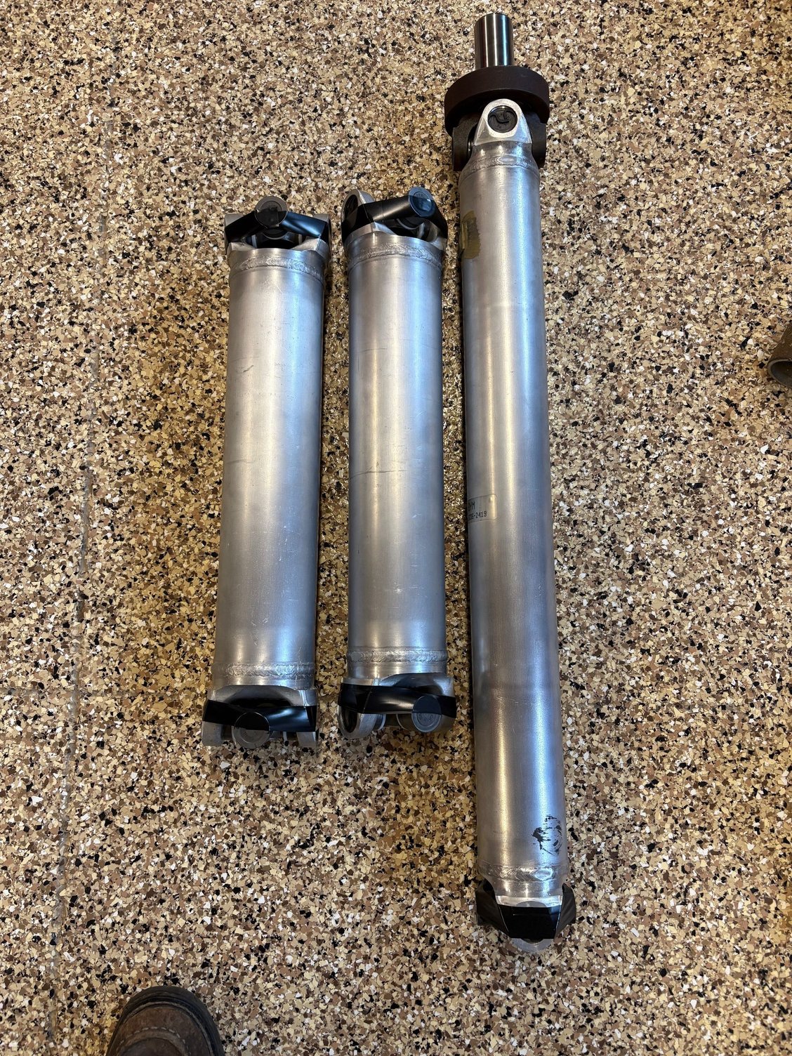

I have completed my complete u-joint replacement. While the driveshaft were original (50,000 miles) I actually had a mechanic change the halfshaft ones 22,000 miles ago. I was dumb and used Moog 231C. I have a mile of gravel to drive in and out. I don't think the grease seals are as good on the Moog as they are on the Spicer. I had 1/4" to 1/2" of encrusted gravel dust around each one.
S

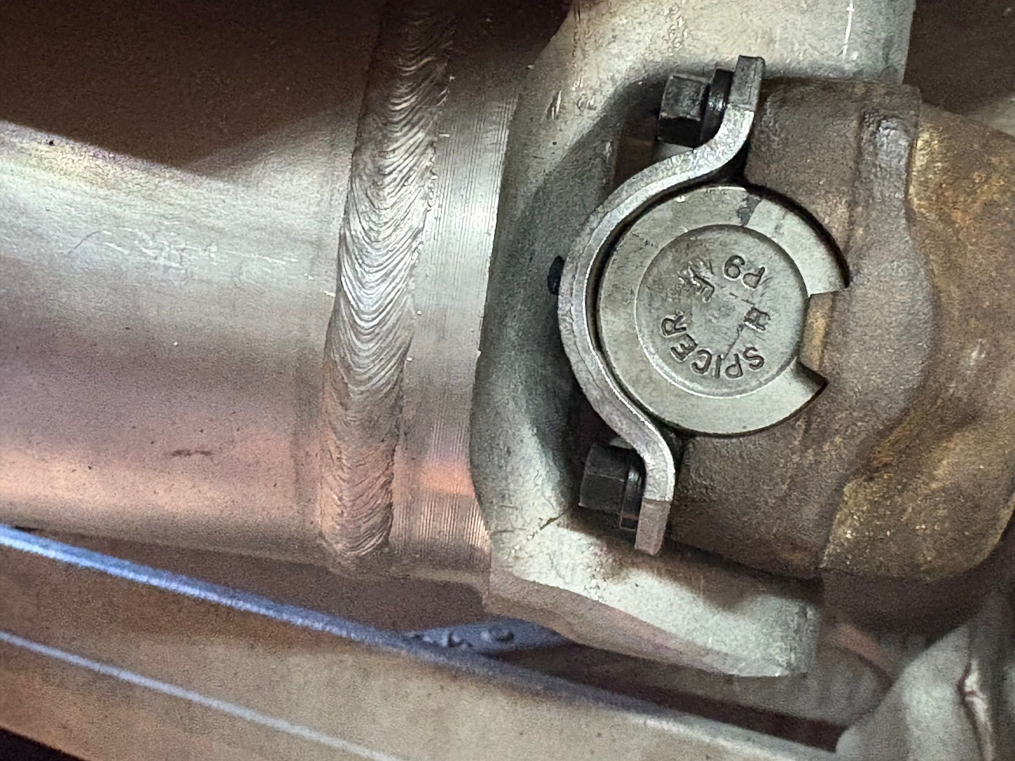

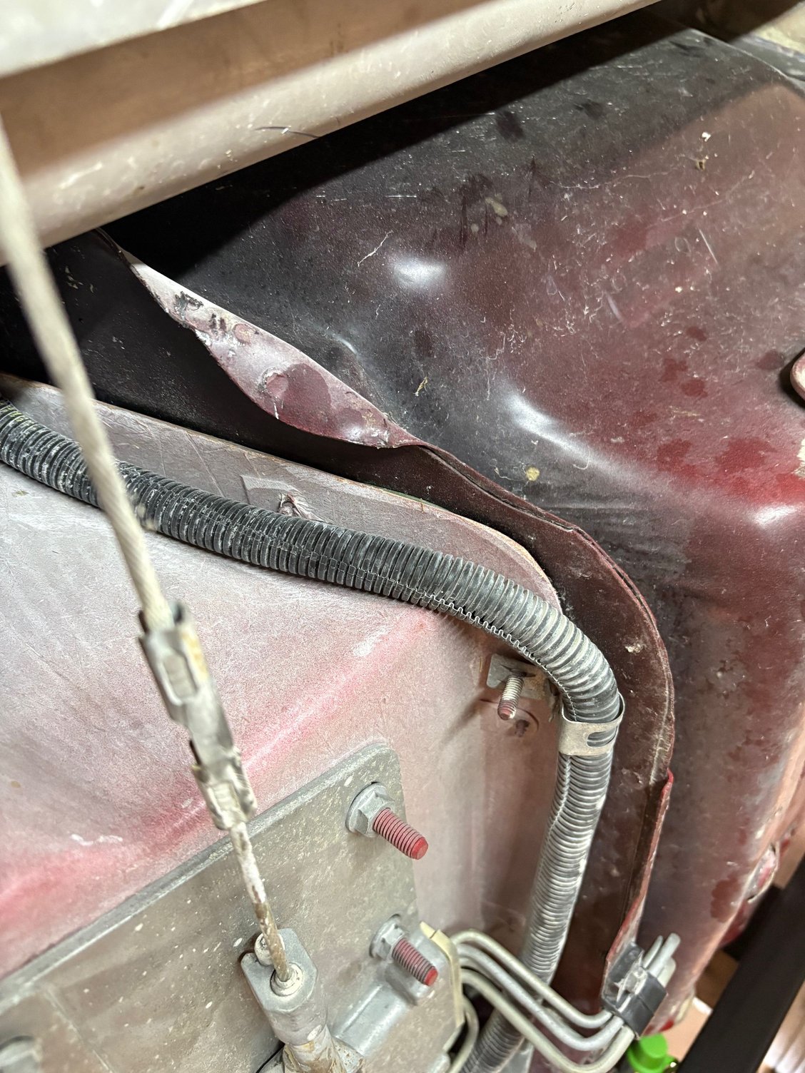

So I wanted to change them out since I was doing the driveshaft. I did the spot weld bending method for the driveshaft removal. It took 30 seconds to bend it with a cresent wrench.
I will say the exhaust removal was a little more time consuming than I expected. I got the exhaust out by myself but had the neighbor help me put it back. I unhooked the tie rod end and dropped the spring. I bought one of the tiger type tools to change the u-joints and it worked well except at the spline end of the driveshaft. A large c-clamp worked to install the new. You can imagine after seeing the pictures that both the car and the shafts required a lot of cleaning. They cleaned up nicely.
When reinstalling the one thing I was scared about was dropping a cup and have the bearing splatter all over the place. When I got the differential side locked in I used a zip tie to hold it in place until I was ready for the new strap install.

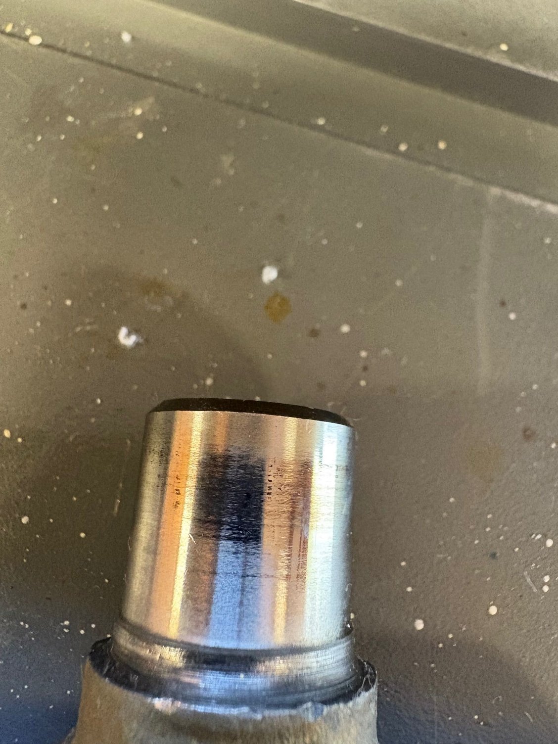

There was excessive wear on the Moogs for only 22,000 miles. The driveshaft had some wear but felt very "notchey" after removal.

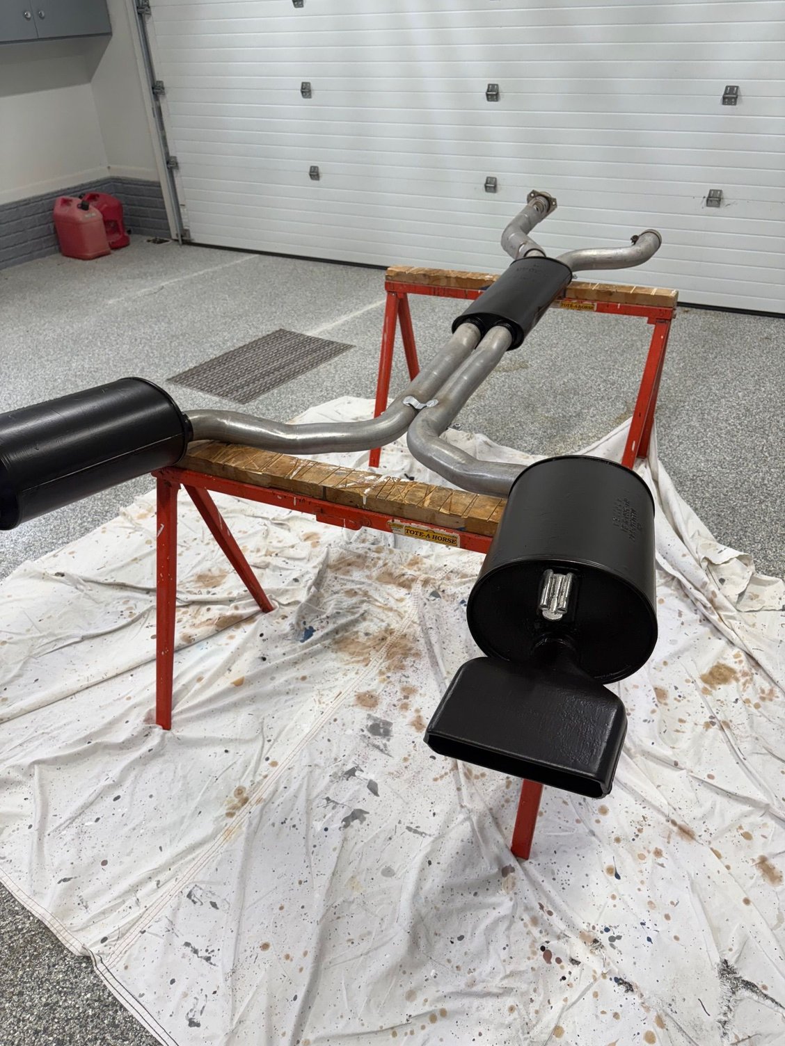

I used all new straps and bolts. I spent a half hour test fitting one new strap and could not get the second bolt started. I finally realized the holes on that strap were 3/16" farther apart than all the others. Denny's Driveshafts sent a new one out immediately. I settled on 200 in/lbs for the halfshafts. The driveshaft was torqued to "goodentite" by my feel. While the exhaust was out I cleaned it up and used BBQ paint on the mufflers.

The quickjack sure made this easier. I don't think I could have done it with just my jack stands. Maybe 40 years ago. Thats about it, no real problems except greasy dust falling in my face a few times. The Moog 231C is non greasable but the seals suck. The driveshaft still had grease in those with ZERO dust buildup. I sure hope the Spicers seal better. Thanks for reading. Dan

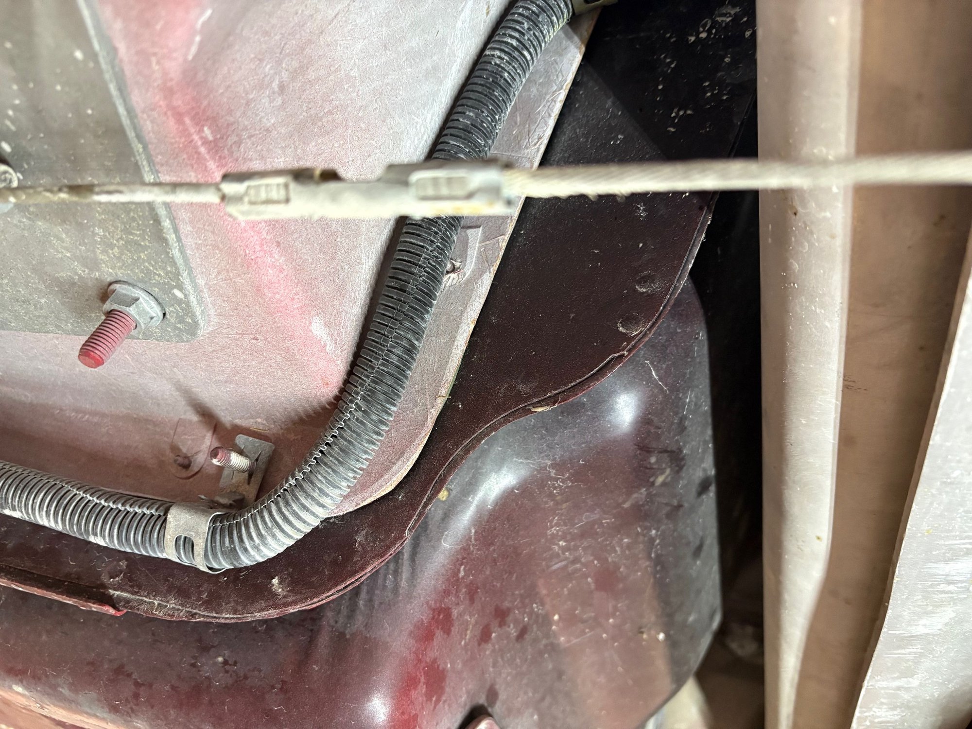

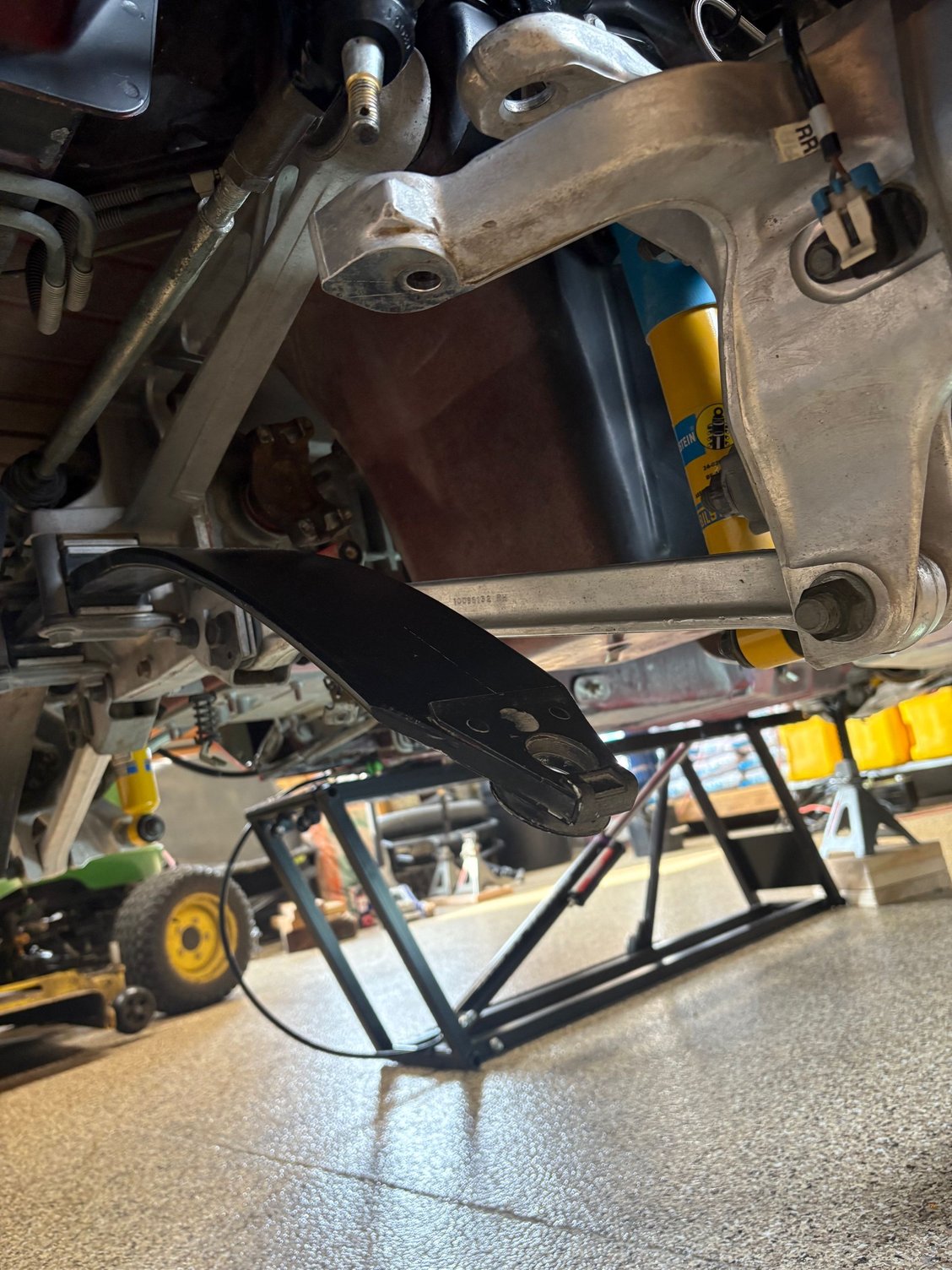

I missed a picture. This is the access I had with the spring dropped.

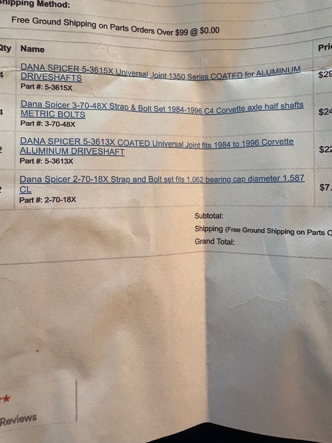

Thank You, Dan for the part numbers. I "saved image as" (the pic of the invoice with the part numbers) printed it for a hard copy in the 92's paper file, then moved the image to the 92's folder on my computer.

You are welcome. The reason I posted this picture of the invoice is there is a lot of misinformation, incorrect information and outdated information on the internet and even this forum about the correct Spicer part numbers. If you do a search of this forum for the correct part numbers you will get posts from 20 years ago with different numbers or just wrong numbers. I just wanted to post the correct numbers for today for a 1996. Dan

I really wish someone would post about the grease leakage and dust buildup on my old Moog's. Maybe this is more common than I think. I could have pressure washed them clean but thought that would be stupid as it would force water into the bearings. Maybe if I drove all day in driving rain it would look cleaner but that never happened. The driveshaft Spicer's had ZERO dust buildup. Dan
