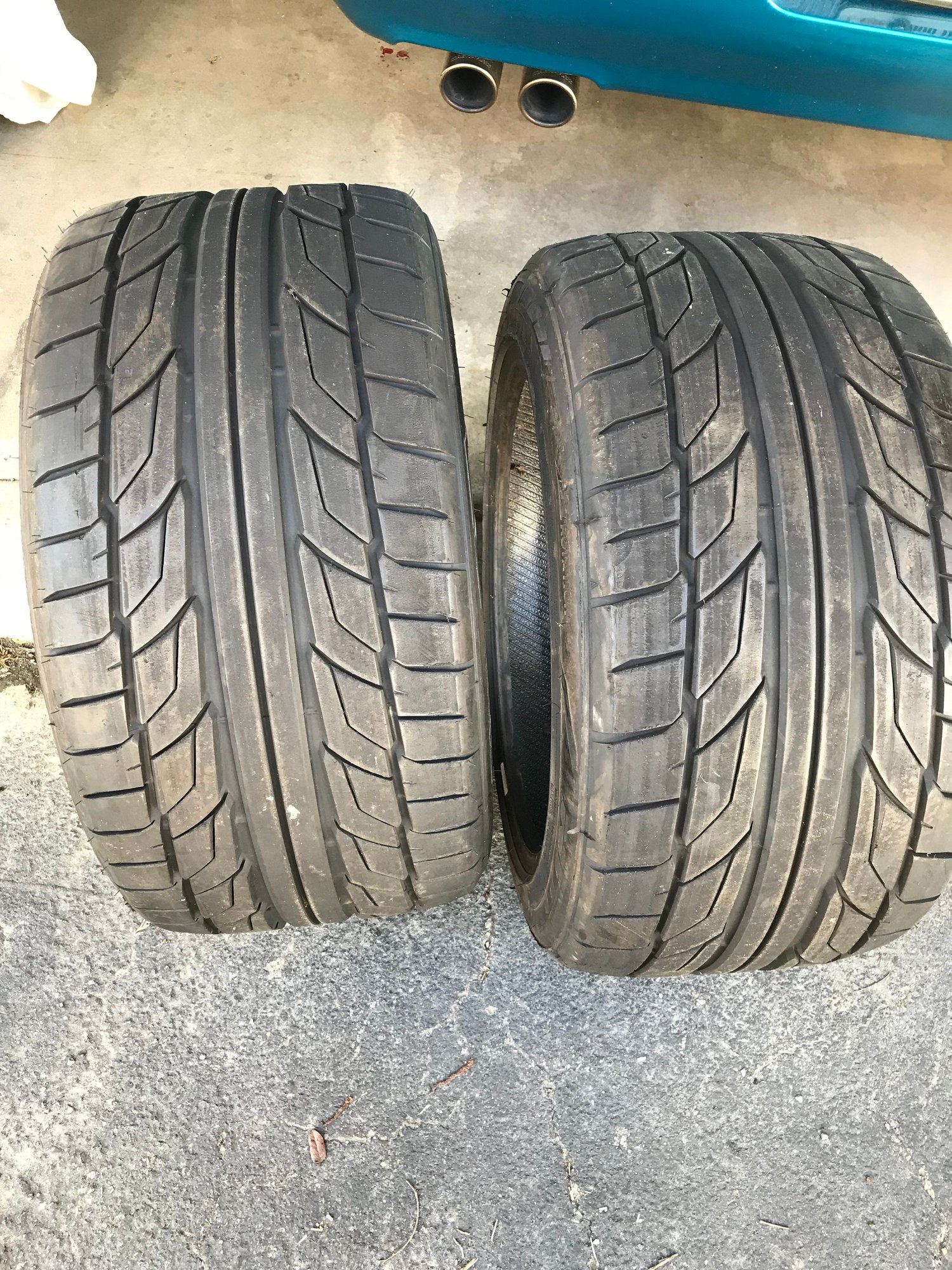

Dan,
I only cruise my 96 LT4. No track days. Occasional hooning or on ramp blasts.
I run the Nitto NT555 G2. No complaints. They run pretty quiet down the road. Grip seems good. Good luck.
